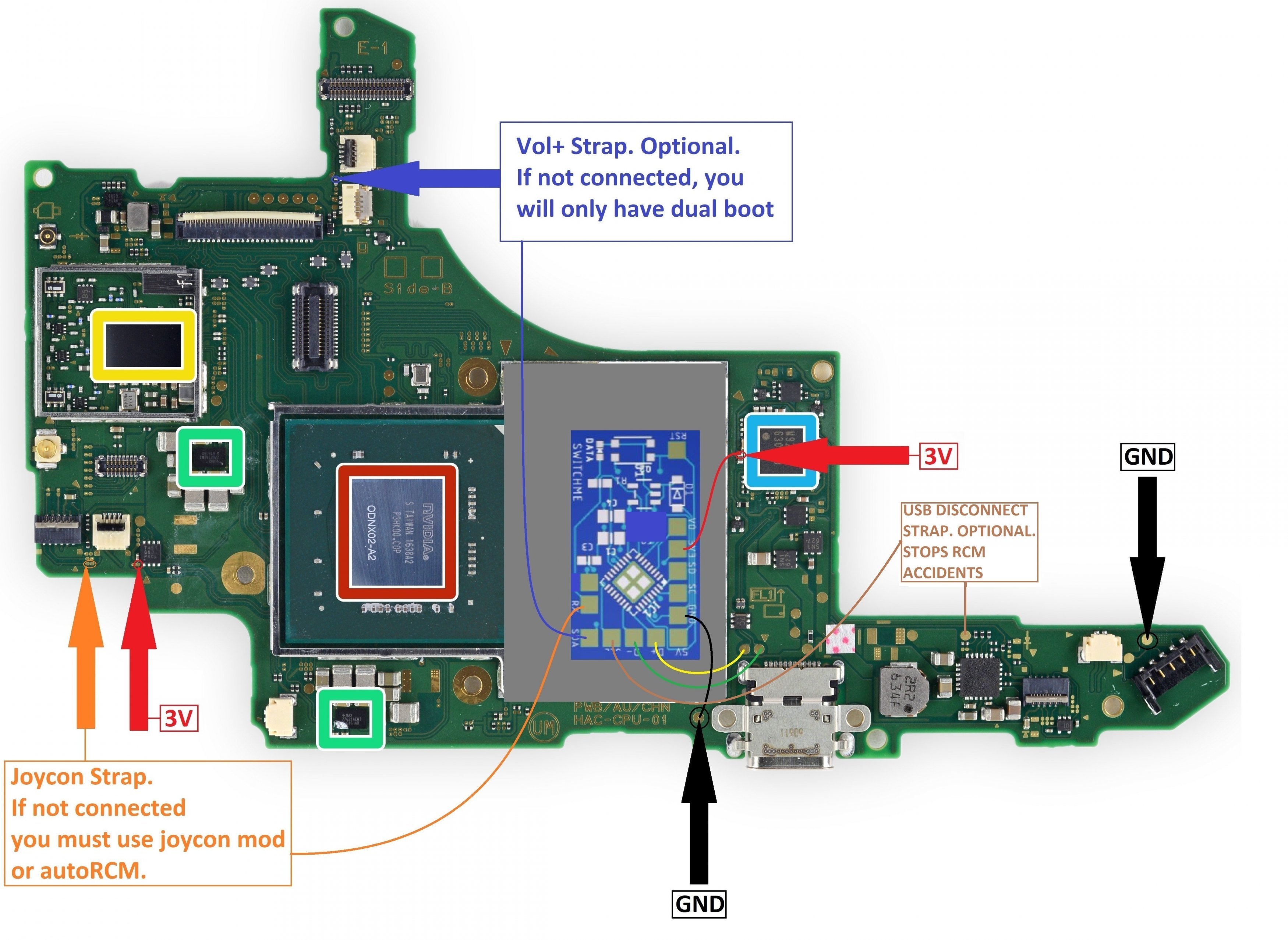

hey guys, so i could use a teensy bit of help, I have quite a bit of experience with unpatched V1s, been sourcing and reselling them locally for years and only now for the first time i came across a "potentially patched" one which has a modchip, it came on 13.2.0 and it has something called neptune installed and it boots into it automatically. By what the seller told me the console could actually have sx core inside since he had it for about 3 years set ut as it is...
BUT it has a problem or two, first thing is that when it's on sleep the battery drains in a matter of couple hours... charging time to 100% seems normal by my experience with the v1s i've dealt with and handheld idling in botw gets about 2.5 hours of screen time, so my guess is it's not a problem with the battery.... I'm going to try connecting it to a battery from an another system i have on hand to test the battery further.
Also the guides i see online the sd setup and github guide seem to circle around ofw 4.0.0 being the base to start the mod and this console is updated to 13.2.0 and has no emummc, sysnand only. So i'm not very certain about rebuilding the sd card, booting hekate to try battery calibration etc etc.... best regards

crack open the back and see what type of hardware mod is in it. If could be a trinket m0 installed without removing the capacitor/led that’s always on and draining the battery.
More info and what to look for here: https://gbatemp.net/threads/interna...ybitsy-m0-express-guide-files-support.508068/
it says switchme
all components except the diagonal chip are pretty toasty after holding a finger down on them for a couple seconds, but i can remove this, it's just an injection trinket right ?

it says switchme
Yup. This is exactly what you wanted to see. You have the infamous 4 wire install that’s always on. If you read through the thread I linked there is probably a way to avoid the constant 3.3v drain. I don’t use a switchme but it’s the same as a trinket for the most part.
Bottom Line: If you dont want to fix the mildly annoying power drain (and not have a cold boot hacked V1) and just want bone stock boring Hekate/Atmosphere then YES, you just remove the wires (carefully…those solder points are extremely delicate!!!) and you’re back to stock. You could technically just unsolder the 3v line (much easier) at the pad you can see and put some shrink wrap on wire and just let the next person know it’s all wired up should they want to use coldboot. (People pay a lot of money to get this done to their switch…it‘smvery nice to never have to fiddle with jigs and injectors.)
edit: looks like the original author (https://github.com/Aboshi/SwitchME) notes the old method of wiring is always on and will drain power (so always keep it in the charger…)
Wiring Diagrams: Check wiring dir 4_wire_always_on (Do not use this method any longer) Leaving it in the git for reference only 4_wire_on_at_powerup (when used with auto rcm you will get instant bootup to whatever you flahed the SwitchME with) We highly suggest CTCaer payloads! More diagrams will be added soon with auto rcm line strapping, emmc cutoff (another auto rcm) and many others.
Here’s the full wiring methodology…
