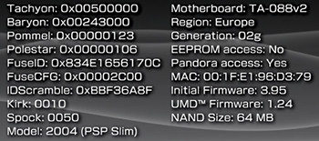

no luck with update :/
my psp is 2004. im now running ARK 4.20.13 cIPL (updated via included v4.20.13 UPDATE file, so i believe i have everything i need ;) ). when i choose SYSTEM UPDATE the first it want me to do is to choose internet or storage media. i pick internet. Then select my WIFI connection. after successful connection it shows me that latest system software is installed.
when i pick media storage (with UPDATE file from ARK 4.20.13 package) it showed me the window with info:
"The following update data was found:
Version 9.99
Location Memory Stick"
from there i can install update.
the info about version making me worry ;)
anyway still no luck with internet update, even after disabling all the custom vsh plugins i have.
My details (FW 6.60):
