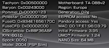

no luck with update :/
my psp is 2004. im now running ARK 4.20.13 cIPL (updated via included v4.20.13 UPDATE file, so i believe i have everything i need ;) ). when i choose SYSTEM UPDATE the first it want me to do is to choose internet or storage media. i pick internet. Then select my WIFI connection. after successful connection it shows me that latest system software is installed.
when i pick media storage (with UPDATE file from ARK 4.20.13 package) it showed me the window with info:
"The following update data was found:
Version 9.99
Location Memory Stick"
from there i can install update.
the info about version making me worry ;)
anyway still no luck with internet update, even after disabling all the custom vsh plugins i have.
My details (FW 6.60):
Seems like you're not the only one, could be a server error?
Anyways, there's a new release available:
https://github.com/PSP-Archive/ARK-4/releases/tag/r42016
But it's not yet in the server so either update manually or wait for the server to be updated.
cipl is for permanent cfw? I'm using infinity. Dunno if that would make a difference.
For the time being, cIPL is only for Pandora-compatible models (1K and early 2K), don't attempt to install on any later model or you will get a brick.
