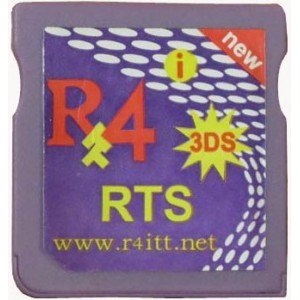

Hi there, I found my old R4iTT Purple 3DS card however it doesn't work with my DSi XL or my 3DS XL. I believe that I won't be able to get it to work with my 3DS since the newer versions are incompatible, however for the DSi it works with version 1.45 which is the one I have. I've looked everywhere for the firmware and kernel but all of the links are dead for my specific card. Mine is the one with the new sticker and it doesn't have a screw on the back. Any help would be greatly appreciated!

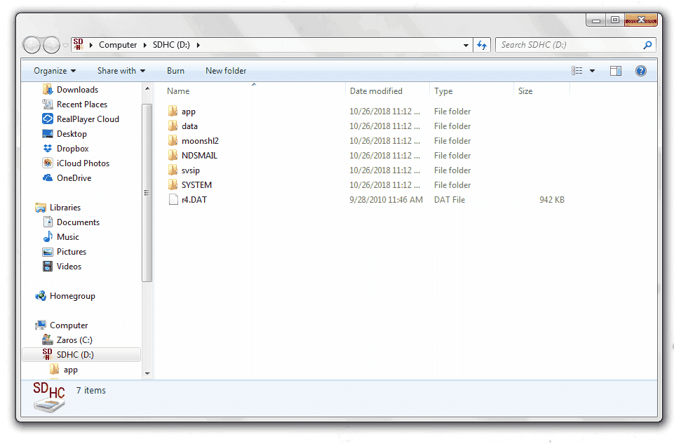

I downloaded and extracted your links to my microSD card and it still doesn't work. It shows a black screen that says "An error has occurred. Press and hold the Power Button to turn the system off. Please see the Nintendo DSi Operations Manual for help troubleshooting."
I tried formatting it and pasting the contents of the kernel you sent onto the SDHC card, now it just shows a stuck black loading screen.

Is your flashcard exactly the image you posted?
If your answer is yes, here are the files

Below are the files ONLY for this flashcard:
The kernel can be found here:
Attached are the files for firmware update
Oh my gosh, thank you so much! This one worked perfectly, it booted straight from the Loading screen to the R4 card main menu. You made my day :)

I know this is an old post, but the r4 is exactly the one on the picture

I have the exact same card as the OP but those files that worked for OP doesn't work for me. Well, the card boots but it says "the kernel version is too low" on main menu despite installing rts3.03 and when i try to boot any game it just shows white screen and doesn't load. This problem started to happen after i updated firmware from v5.06 to v7.0.0 but i dont knowhow to downgrade
