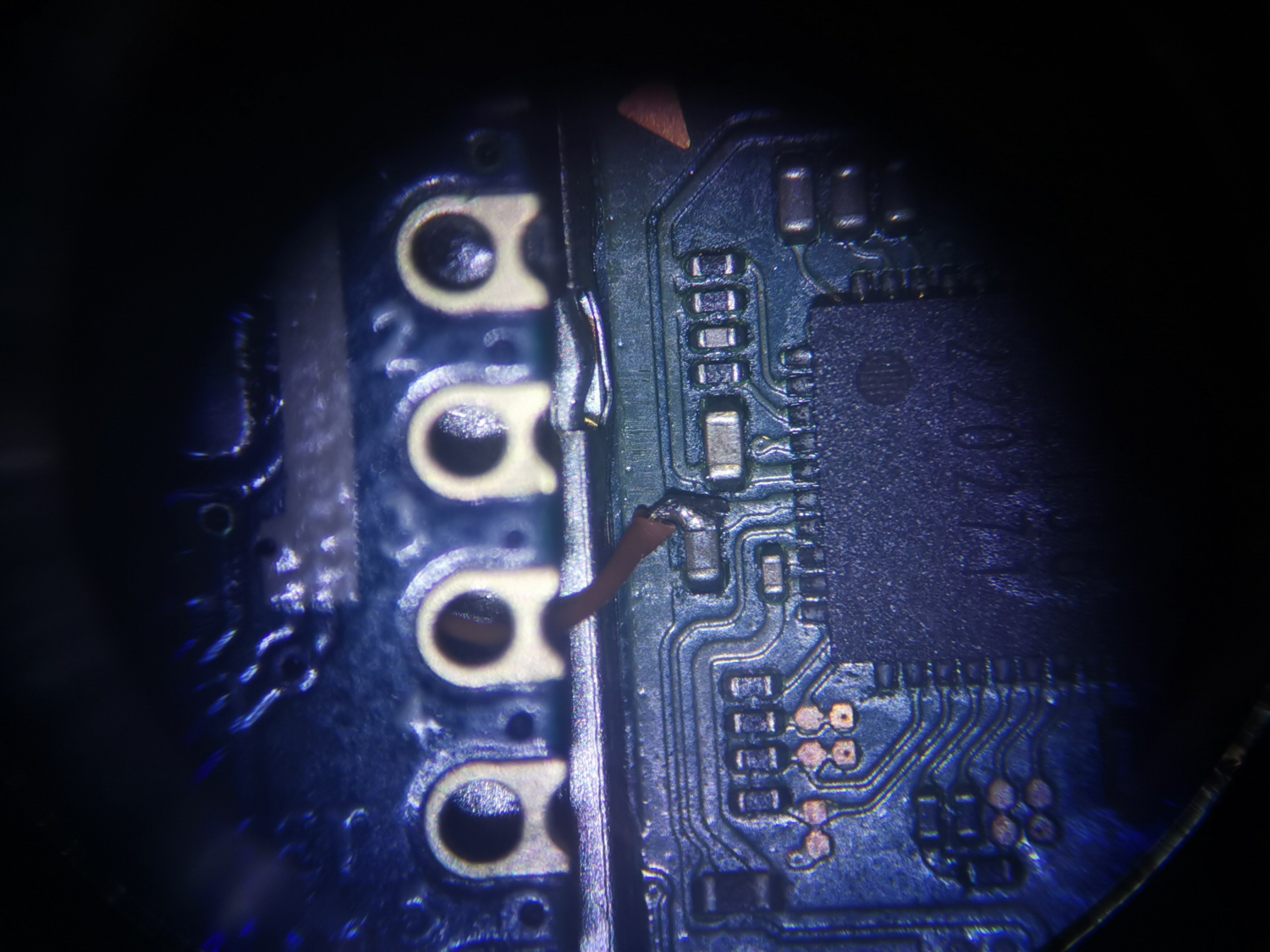

So my first attempt on a Lite bought second hand particularly to test the mod was not so great. Upon power up only got a black screen, very audible choke buzz and smoke from under the APU shield. Upon inspection the G wire got detached from the MOSFET, most likely while I was soldering it to the Pico. I used 0.2mm enamel wire for that point and in hindsight I should have secured it to something before placing the shield back, 0.2 is just to stiff for that small weld. Didn't want to commit to solder mask just yet and paid for it.
The MOSFET (single 8342) got fried obviously, but surprisingly the Switch survived. After removing the Pico and the MOSFET it power into OFW just fine. The Pico seems to be fine too, at least behaves the same upon re-flash.
Hope this experience helps someone to avoid my mistakes.
FYI, I used 0.22mm bare copper wire from 14AWG speaker wire for D and S, 30awg Kynar for 3.3V and ground and 0.1mm enamel for everything else. I'm going with 30awg on the G for the second attempt (when I find time:)).
I think you experienced firsthand what happens if the G line geta disconnected. This was the reason we were discussing puttin a resistor there to avoid an issue like this.
Also i would recomand a 34-36 wire for G, it works ok.

Yeah, I considered using the 0.1mm enamel for G, it's so much more forgiving, but it goes under the shield and rubbing againtst sharp edges, potentially scraping the enamel and causing a short. I recon the chances of this happening are slim, but the 30awg seems to be flexible enough. We'll see :).
Thank you for sharing.
From your experience, i confident that the blue screen is not because the accidentally open state of the mosfet. Just like what i predict, the mosfet will be burned, but the apu is safe, since the power is stolen by the mosfet. There is a discussion before on placing pulldown resistor between D and S so when the mosfet open, it might burn the cpu, but i am not convinced. Just for precaution, since some people reporting BSOD, which suspecting the mosfet. Now i am sure it is not the cause.
I think the optional resistor is between G and S (ground essentially) and the purpose of it is to bleed out stray currents to prevent the gate from opening while the Switch is operating normally and I don't know...crashing it, burning out the APU? In this case G was disconnected so the gate would have stayed closed.
Well, the second attempt went better...sort off. This time no smoke, but it goes to OFW with two long and one short flashes indicating unstable glitch as per the guide (I'm on 2.73). It does glitch though when I press Reset on the joycon logo. At this point I have few options:
1. Shorten the wires. This is a must anyway as I left them ungodly long to have room to maneuver before the final assembly and lower chance to rip of the pads while initial testing.
2. Do a two MOSFET setup. I went uber conservative on the MOSFET with a single 8342 and a single cap connection. Single 8342 is fiddly enough, two would really test my skills.
3. Go for i2c as suggested in the guide.
What would you recommend to do between 2 and 3?
On one hand two MOSFET's would be a pain and the record is spotty on the success rate. On the other the i2c will mean taking off the MB (the solder points are on the back right?) and that would require removing the flex cables which I've heard horror stories about and definitely something I'm not looking forward to be fixing.
First thing first though, do a backup as Adran_Marit stressed in the other thread. I went through hell when the EMMC on my V1 bit the dust and lost everything, had no idea at the time the V1 was so easily hackable before disaster struck. I eventually managed to salvage the console with the help of the community here, but the data was gone and no online either.
BTW, any point going for 2.74 yet?
I would go for short wires, single mosfet but soldered on 2 caps and fw2.74 (better glitch times)
If it works, great. If it does not, then you have eliminated all possible alternatives and you either go with i2c (i would) or "try" 2 mosfets.
Have you considered using a bigger mosfet both in capacity and/or size?
Edit: I would also add more solder to those points in pico and you should also solder to both points in the pcb for a better connection (bridge the points)
