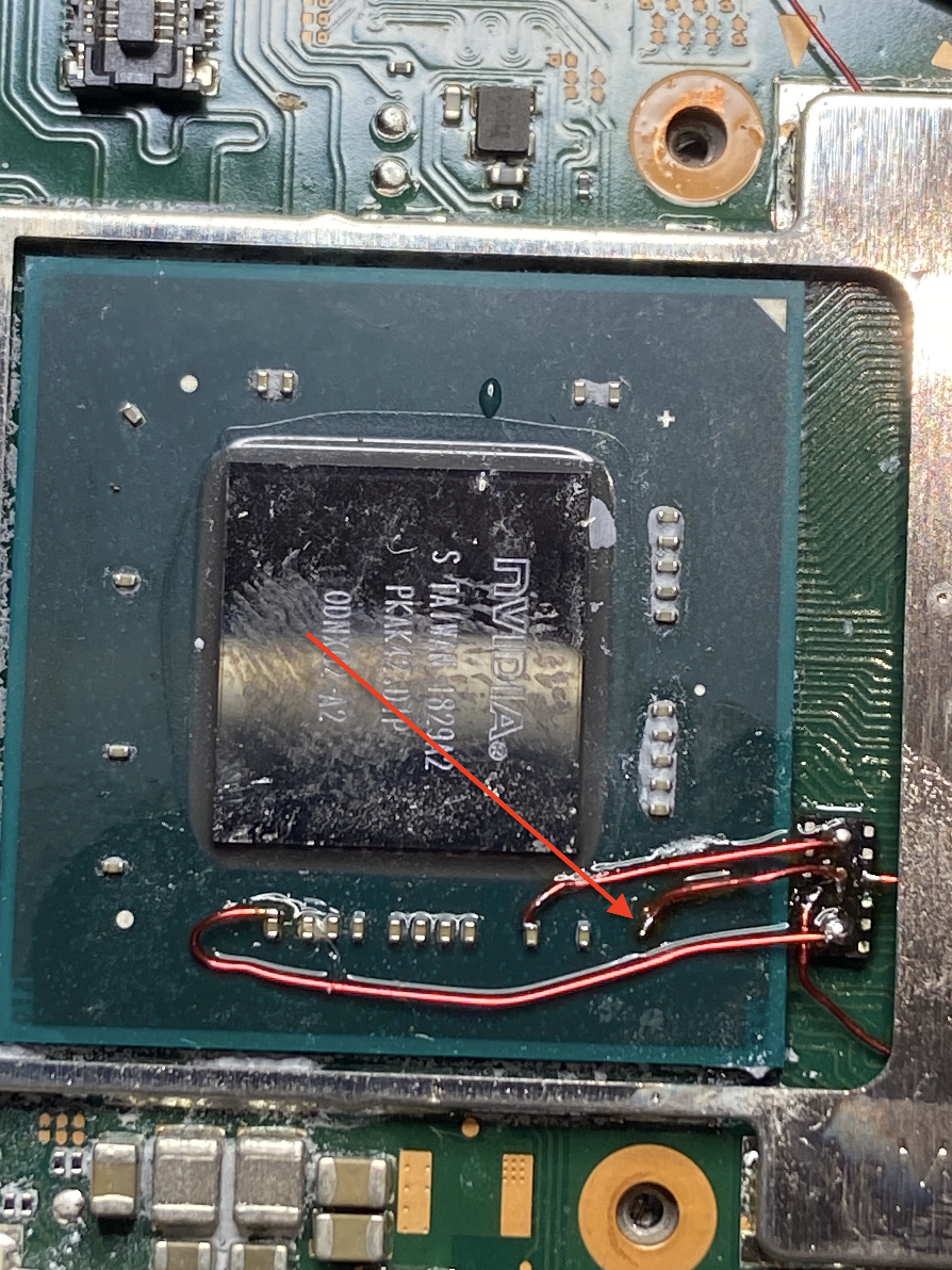

I took a deep moment while reading your comment, and I remembered something that I always do when installing MOSFETs that I saw nobody does.
I GRIND , with a grinding pen , the ground point on the APU to put solder on it. Sometimes I'd grind a bit too much. Could this be the reason?
I'm talking about the point in the arrow.
@Dee87 , @deep , @rehius I'd appreciate your opinion on this.

NEVER GRIND ON THE APU
just heat it up till it sticks maybe scratch a bit but NEVER GRIND THERE

If I were watching over your shoulder, that's EXACTLY when I would have screamed.

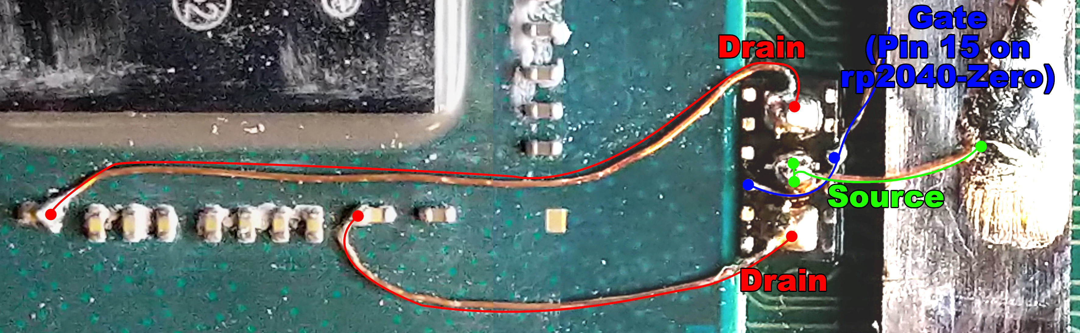

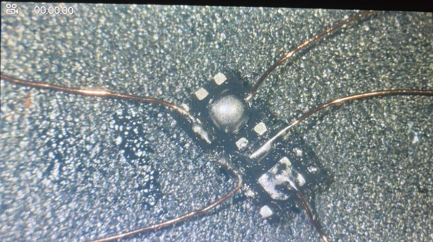

Hi guys, I wanted to share this setup.
For the APU > Mosfet connections I used the self-sealing cable that I used for the PS1/PS2.
I stripped the section I needed first, then I soldered very easily as there was no need for a high temperature to melt the "lacquer/varnish" of the lacquered/varnished cable.
I photographed all the welding points so that novice users can get the clearest possible idea and can take a cue (it's not presumption, I write it because I read too often users who have problems and find broken consoles after installation ).
By the way, the last 10 consoles I've modded all worked with the single mosfet.
Both OLED, both Lite and classic switch.

...aaannnnddd..... you just shot metal dust particles all over... your switch, table, floor, etc....
See?. Like you said, it’s never the mod, it’s us. This mistake has cost me 2 Lites, 3 OLEDs, and one V1. I’d say that’s enough punishment.

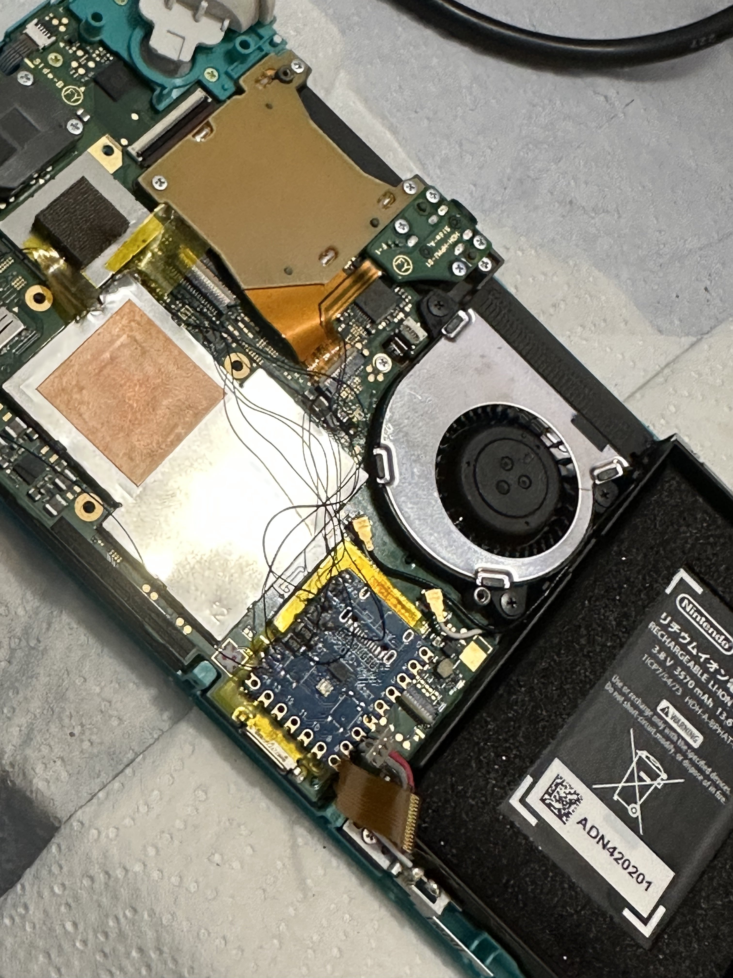

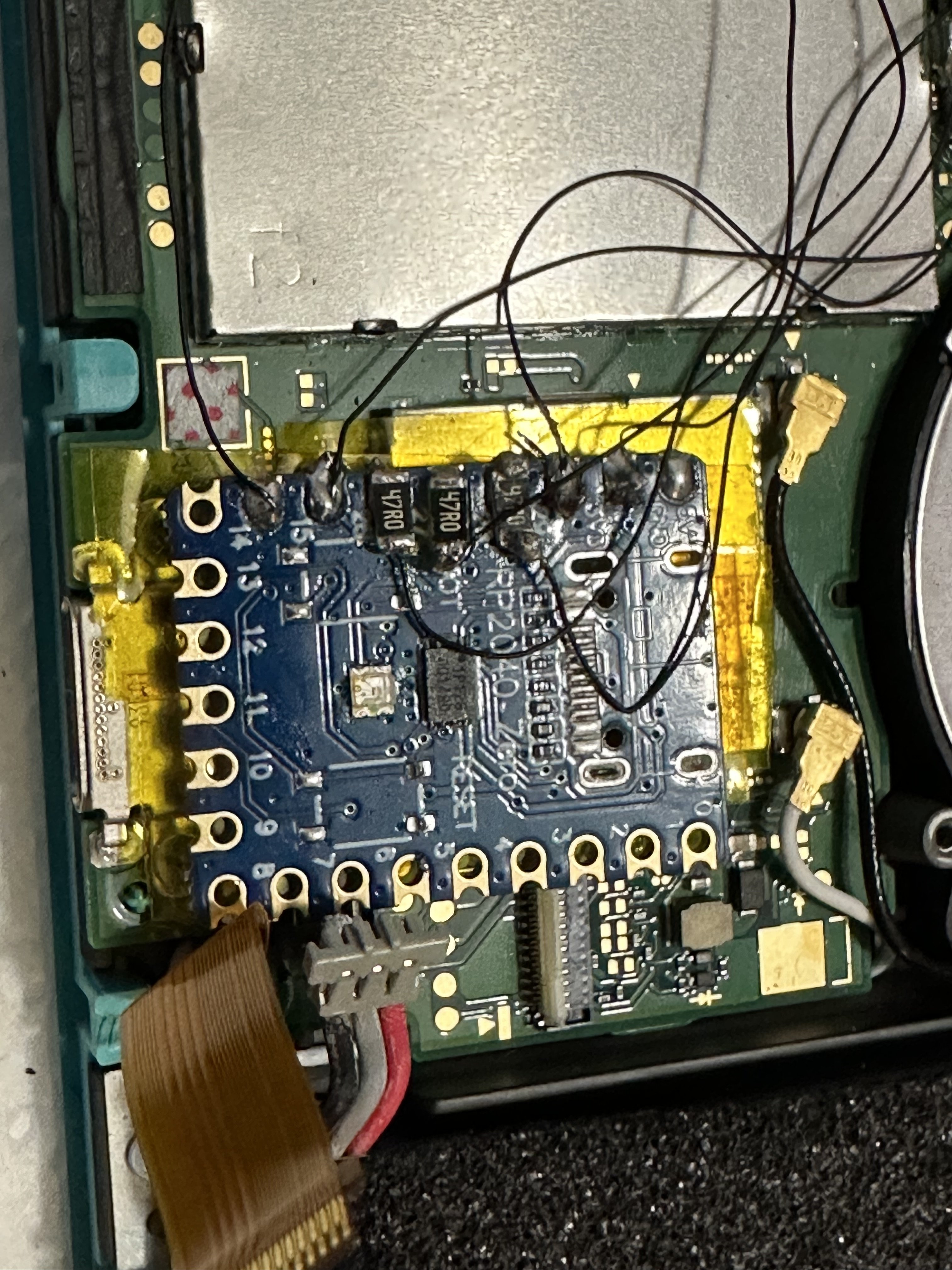

Hello everyone, I have installed Picofly in a Lite, with its CPU strip, I checked the soldering well before turning on and everything is correct.
The problem is that when I turned on, I saw the logo Insert SD Card Picofly but suddenly began to smoke out of the point where soldering GND,
The chip flashes the LEDs correctly but the screen is black, I understand that the resistor has been burned, right? should I repack or what can I do? thanks

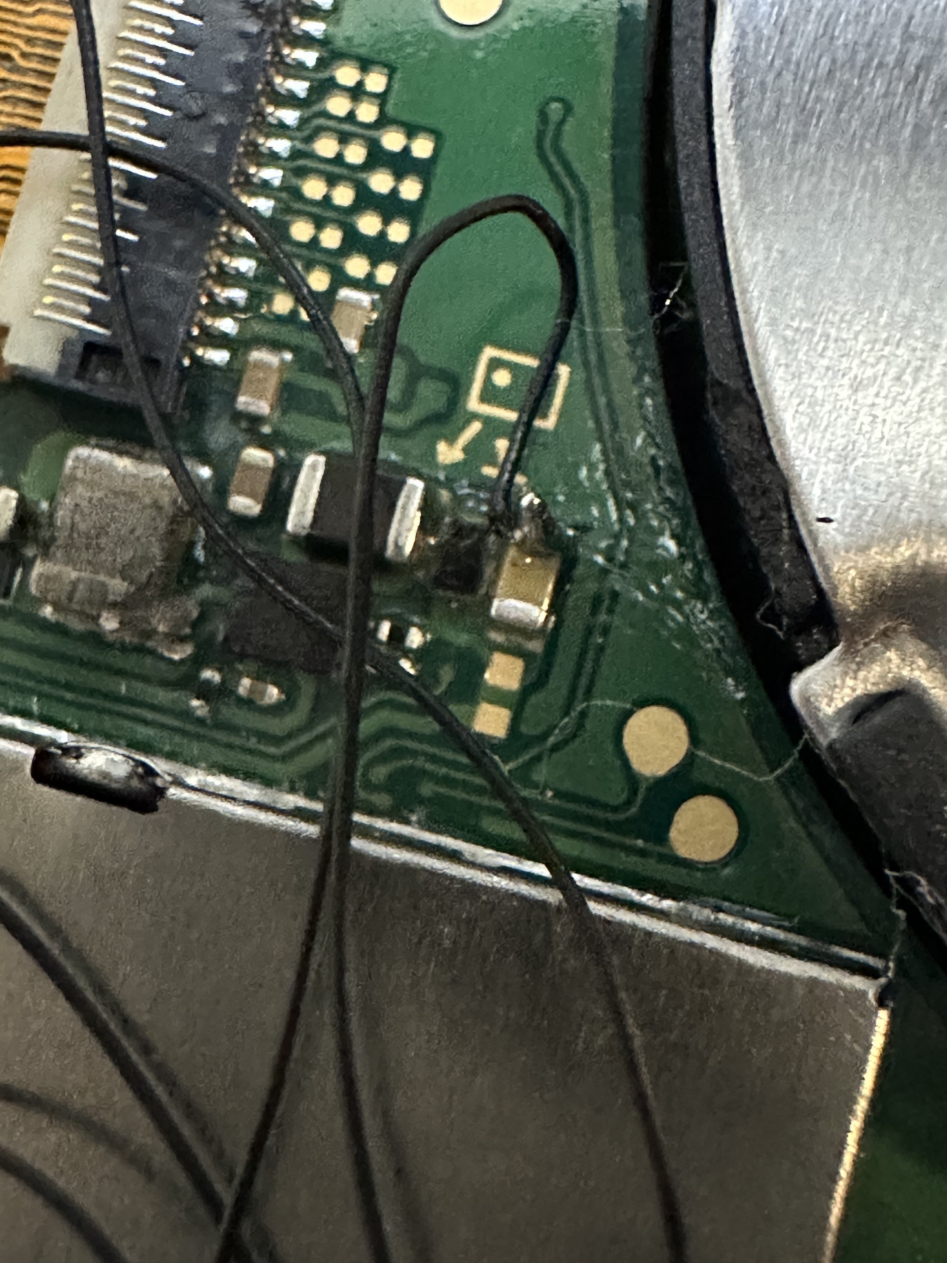

The problem is that when I turned on, I saw the logo Insert SD Card Picofly but suddenly began to smoke out of the point where soldering 3.3 v,
The chip flashes the LEDs correctly but the screen is black, I understand that the resistor has been burned, right? should I repack or what can I do? thanksView attachment 374521View attachment 374520
The inductor close to 3v3 seems damaged (might be bad photo)
Also check for short on the resistor side in pico
Thanks.I understand that this component has made contact with the resistor on the right and has burned, can it be replaced? what is it called? thanks

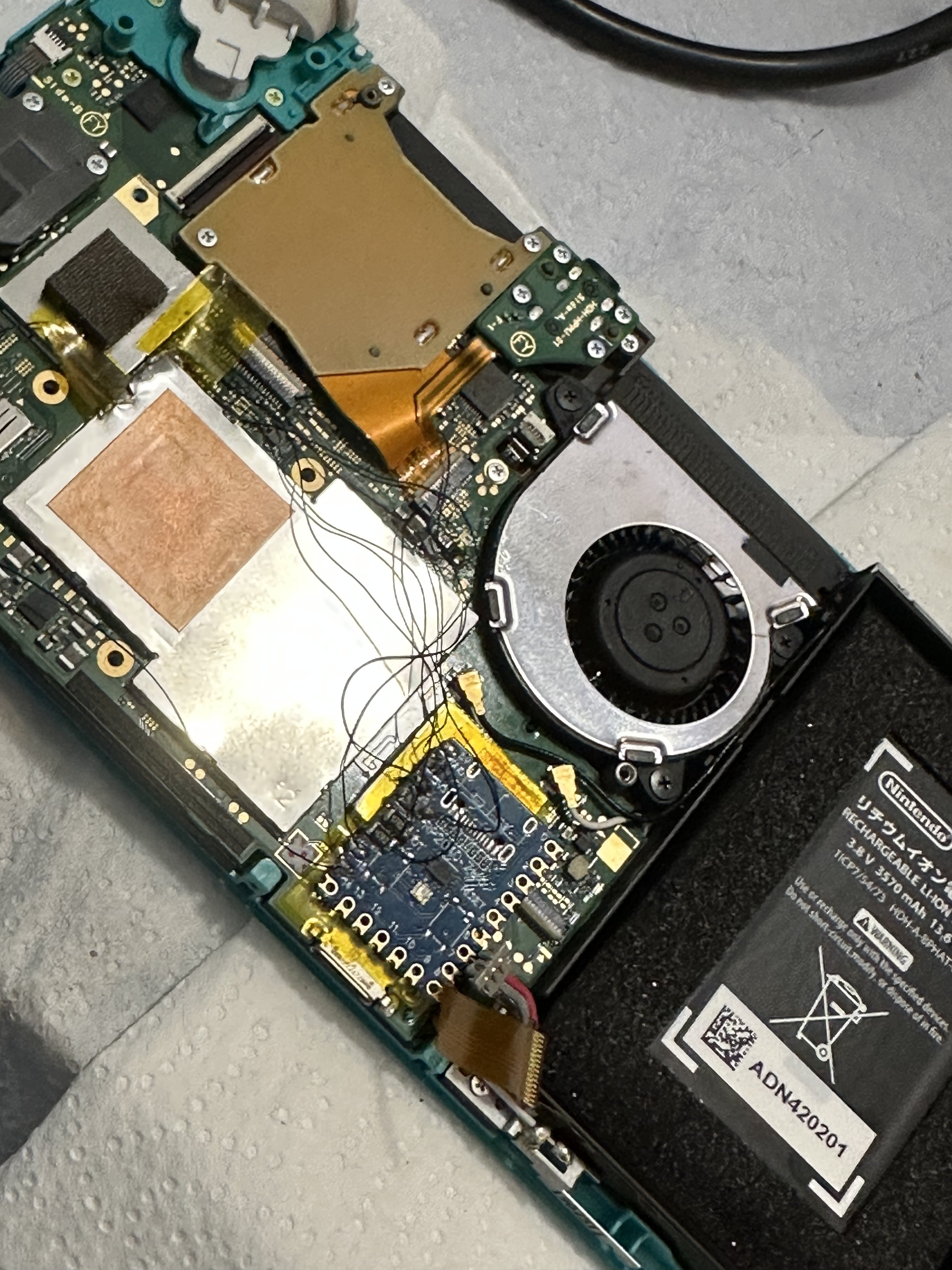

My first post-APU grinding Switch OLED. Works like a charm, and glitches in less than a second. boots into hekate.
I used the shield as GND. Won't be touching anything in the APU other than the two caps. Lesson roughly learned.
  • IMG_7221.MOV
    16 MB
If i were you, i rather choose 3.3v on the right side of ram rather under the flex. First its on the pad not capacitor, second its secured mechanically because its 2 pad. Compared to solder to the cap which you relied on the chemical bond between the conductor and the cap.
Also for ground i never using component like cap. Soldering in there just give risk on destroying the component cause the heat. Or in your case risk shorting other component. I rather use the gnd pad.
For lites its well known to use on top of the emmc. Its perfectly fit with the alyminium shield.
