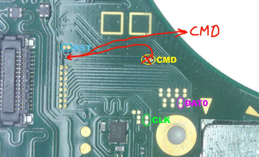

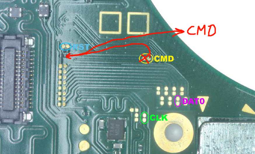

Hello guys,
I tried to install the Picofly on my V2 switch. I'm quite in trouble now...
I followed the very good V5 guide, so I installed my picozero. And it worked (green led + success screen) !
BUT (there is a but), when I tried to clean up the set up and I accidentally torn the 2 CMD pads... So I tried to repair my mistake : I succeed in soldering the CMD via to the inductor at the left (CMD side of the inductor) to repair the broken path. I installed the CMD wire to the picofly at the same place (see picture).
Now, the fact is that it's not working : I got a purple or pink Led (purple I guess because the problem was on the CMD line). I already removed my USB C connector, so I can't have the last version...
I tried to remove the picofly (to boot on OFW), and nothing's working : black screen
Does anyone has an idea ? My switch is good for the trash...
Thanks for your help

In first page you can find this schematics.
It's easy to repair
You need to fix that cmd point you broke, you will know its fixed when your switch can boot normally.

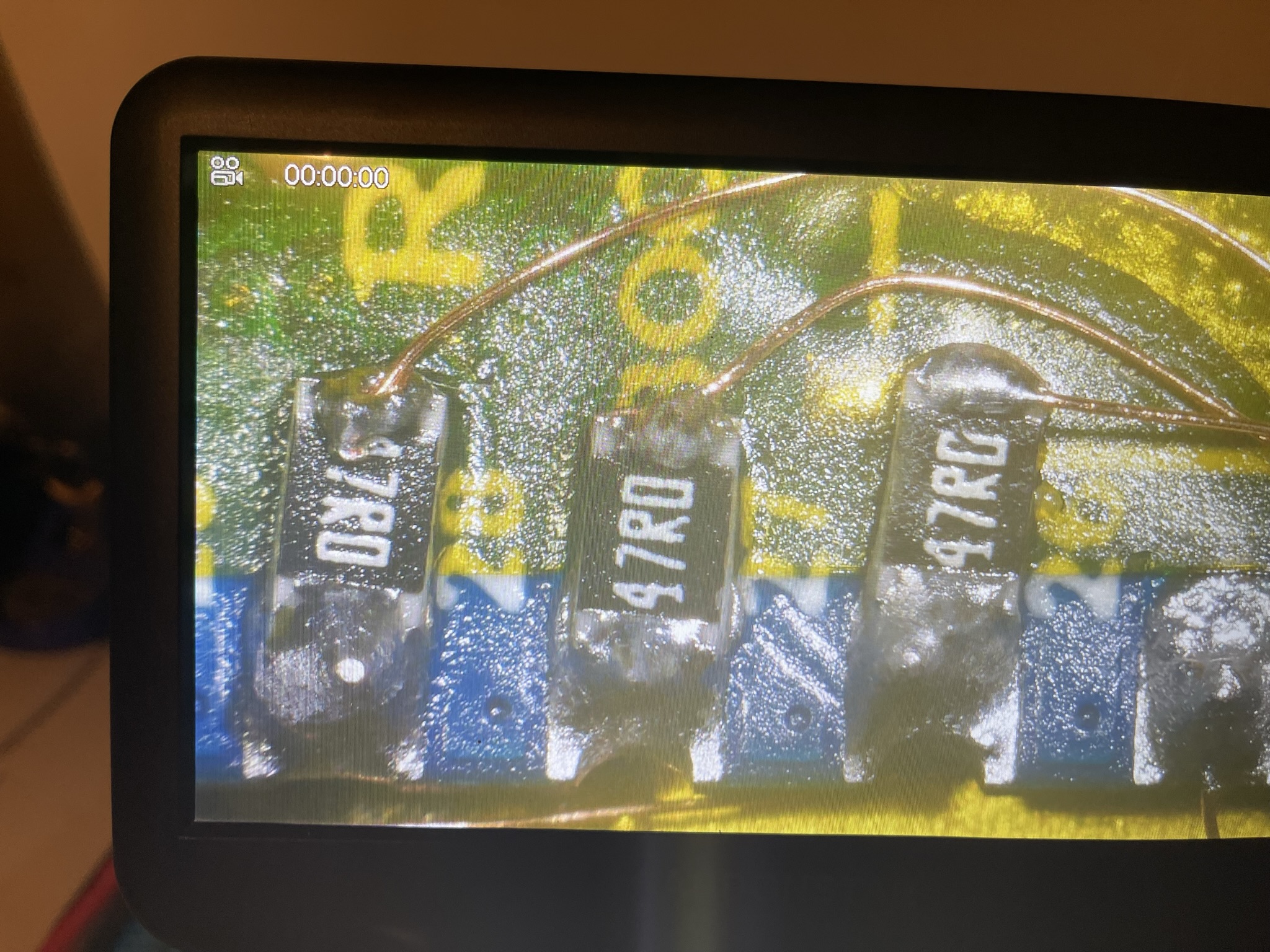

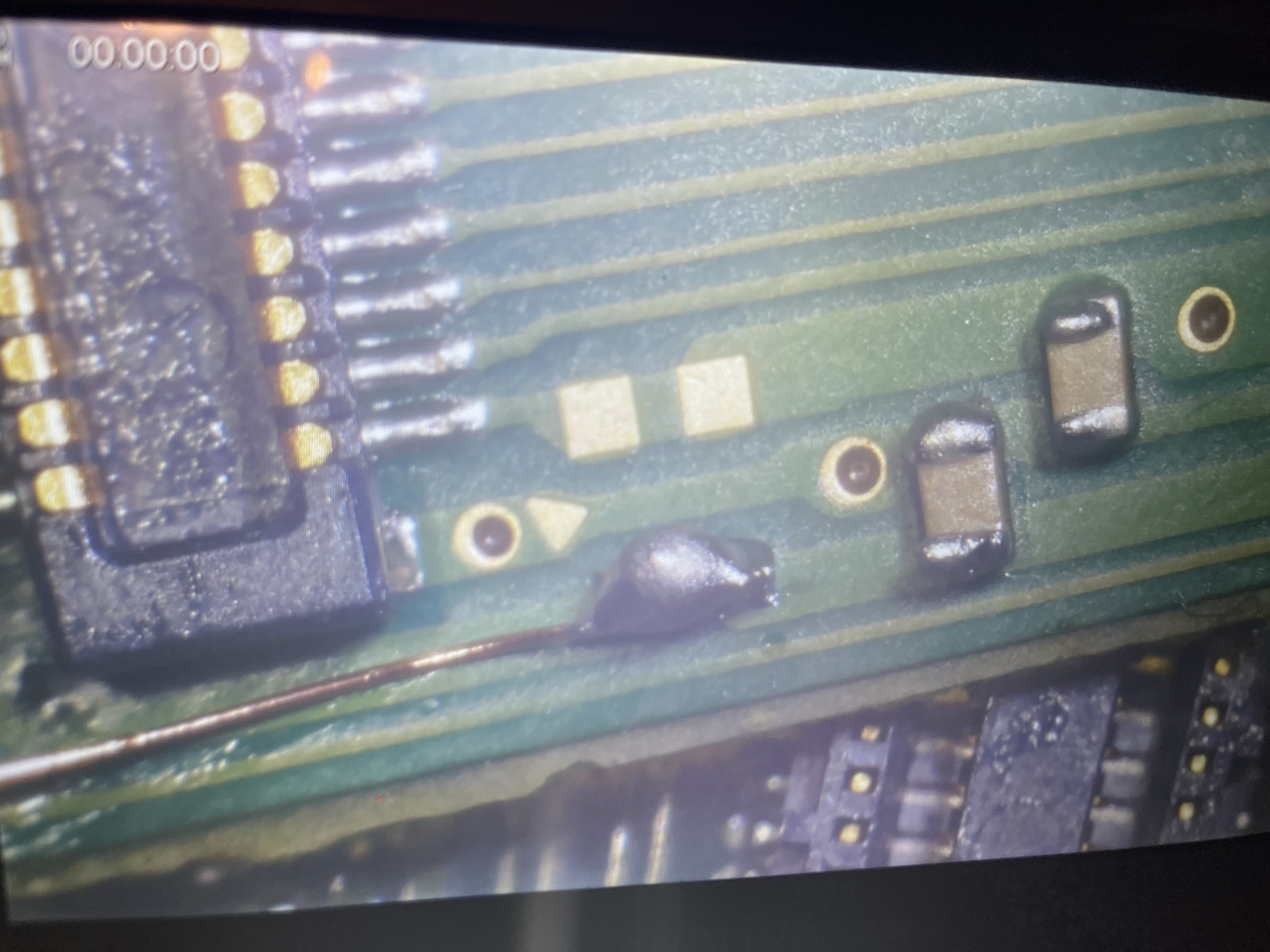

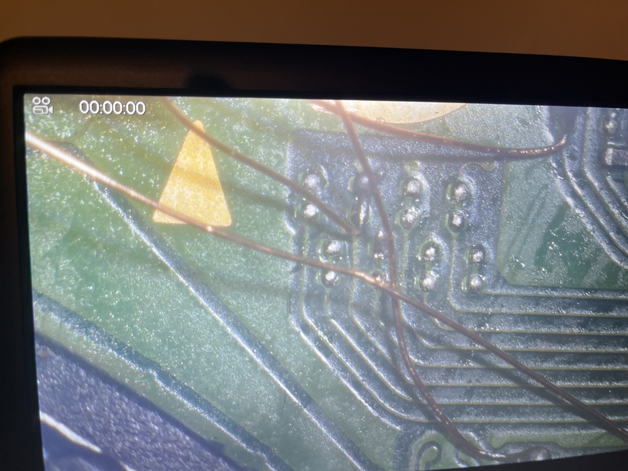

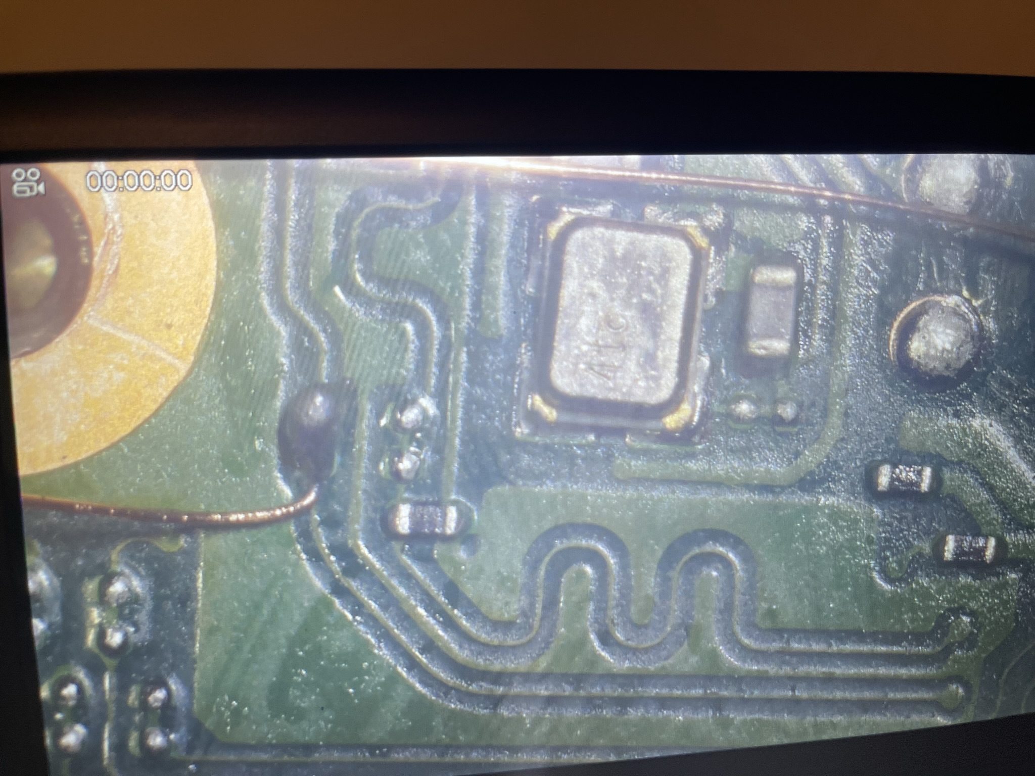

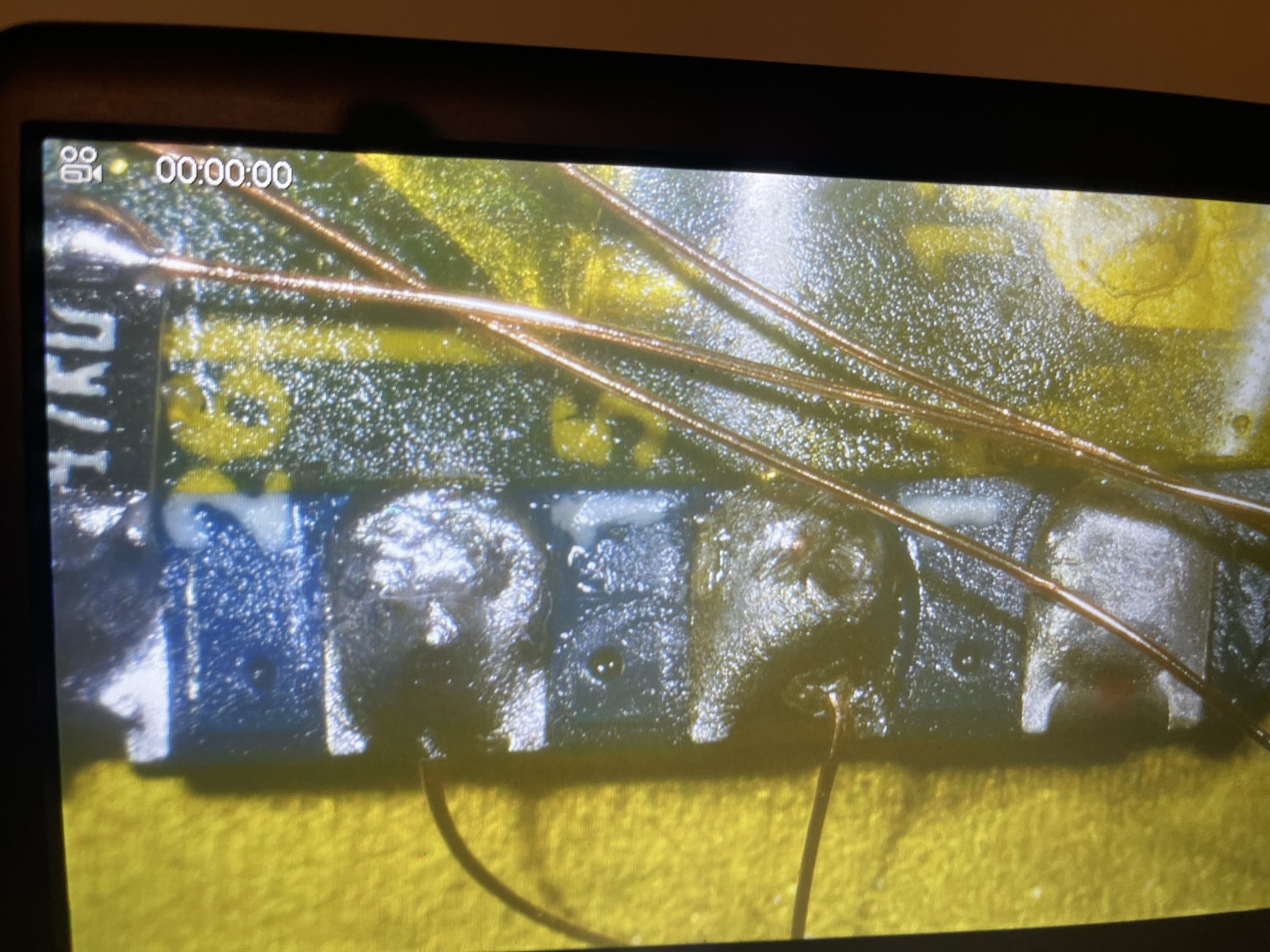

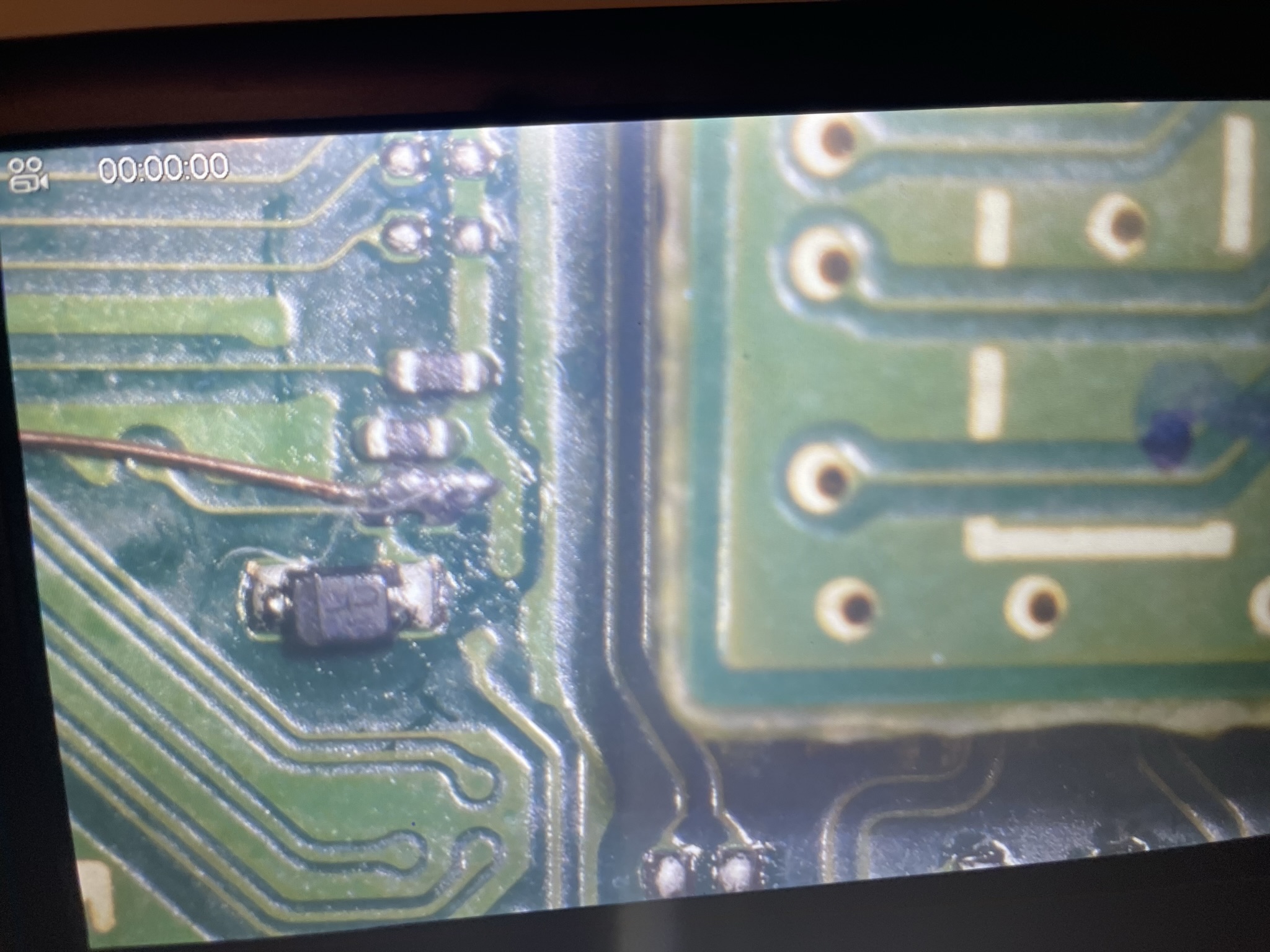

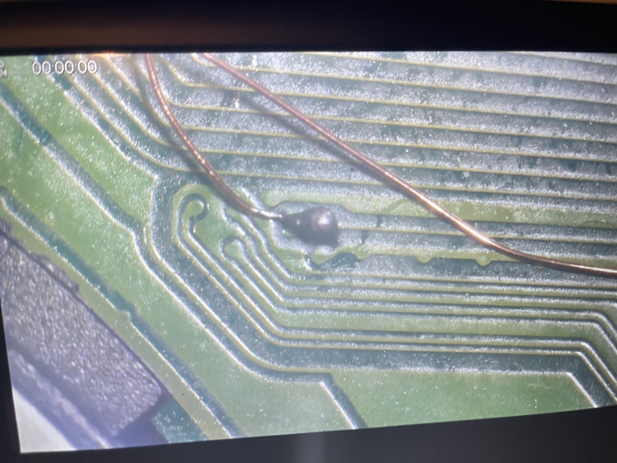

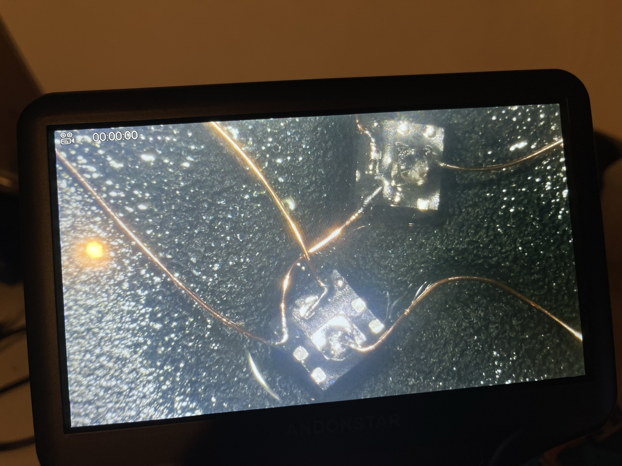

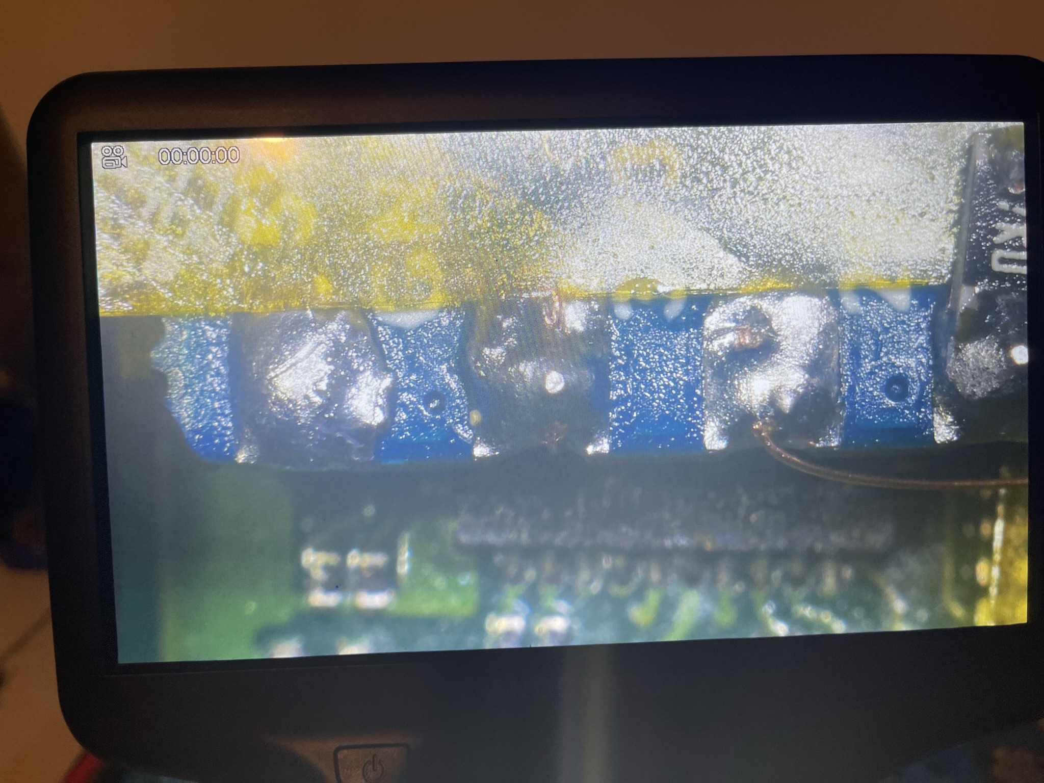

Seems to work but it is SO SO SLOW its kindof speratic, sometimes fast, sometimes slow, but when its slow its like 20s-30s on to glitch successfully, no errors though, although 1 time it said success but it did nothing. Do you think it needs more resistors? Its a Shynix emmumc.

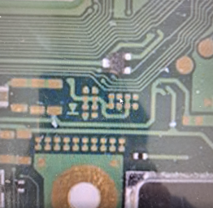

i think picofly only use 1 bit mode (only dat0) to write the loader to the mmc.
Maybe you short circuit the dat0 with dat1 or maybe with other datn:
The green is dat0 the blue is dat1.
The bottom is dat4. You might check the continuity about dat0 point.
The whole dat maybe some short circuit with something else.
Again - I think you might be right... going to de-solder and check.
Don't suppose you know which pads are dat 1-7?? (Would be great for the hardware reader I'm building).

@floxcap
If you comfortable soldering 1 hair thick point you can try this dat0 point, its easier to not short at least for me.
I already move to this point as dat0 solder point onwards on Lite as it is harder to messed up..
Reactions: floxcap
