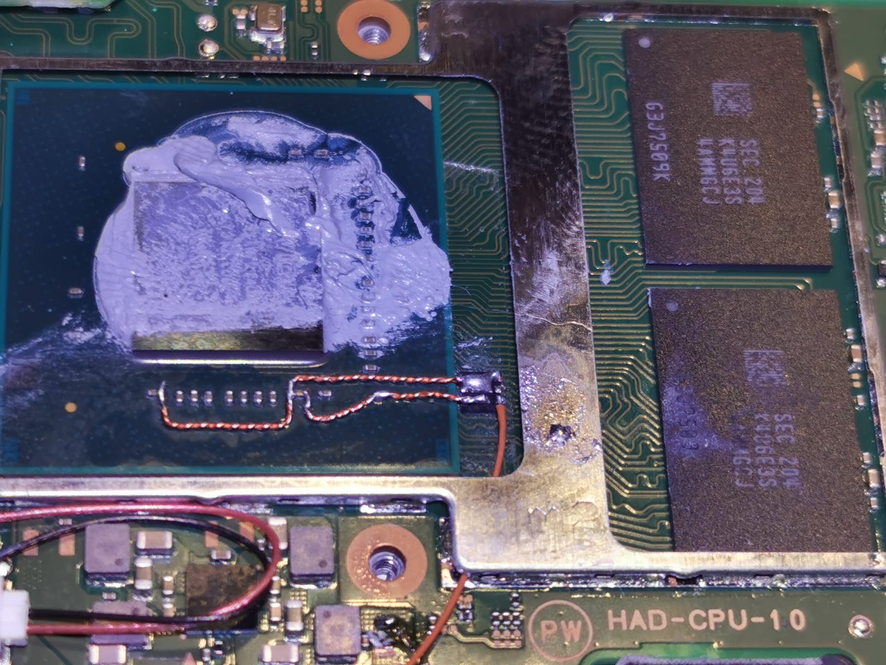

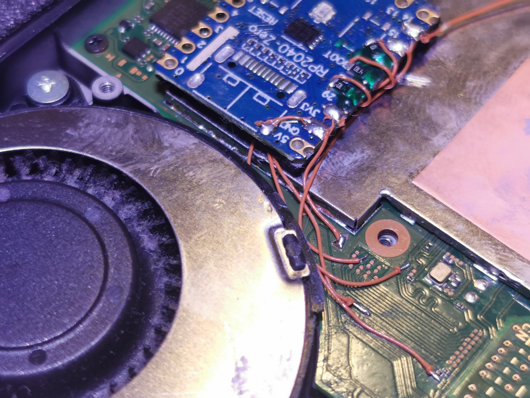

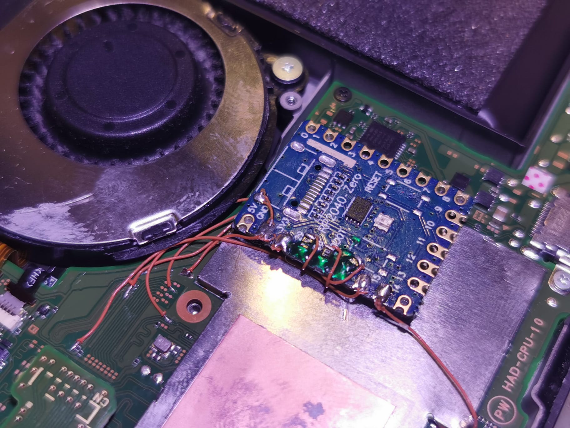

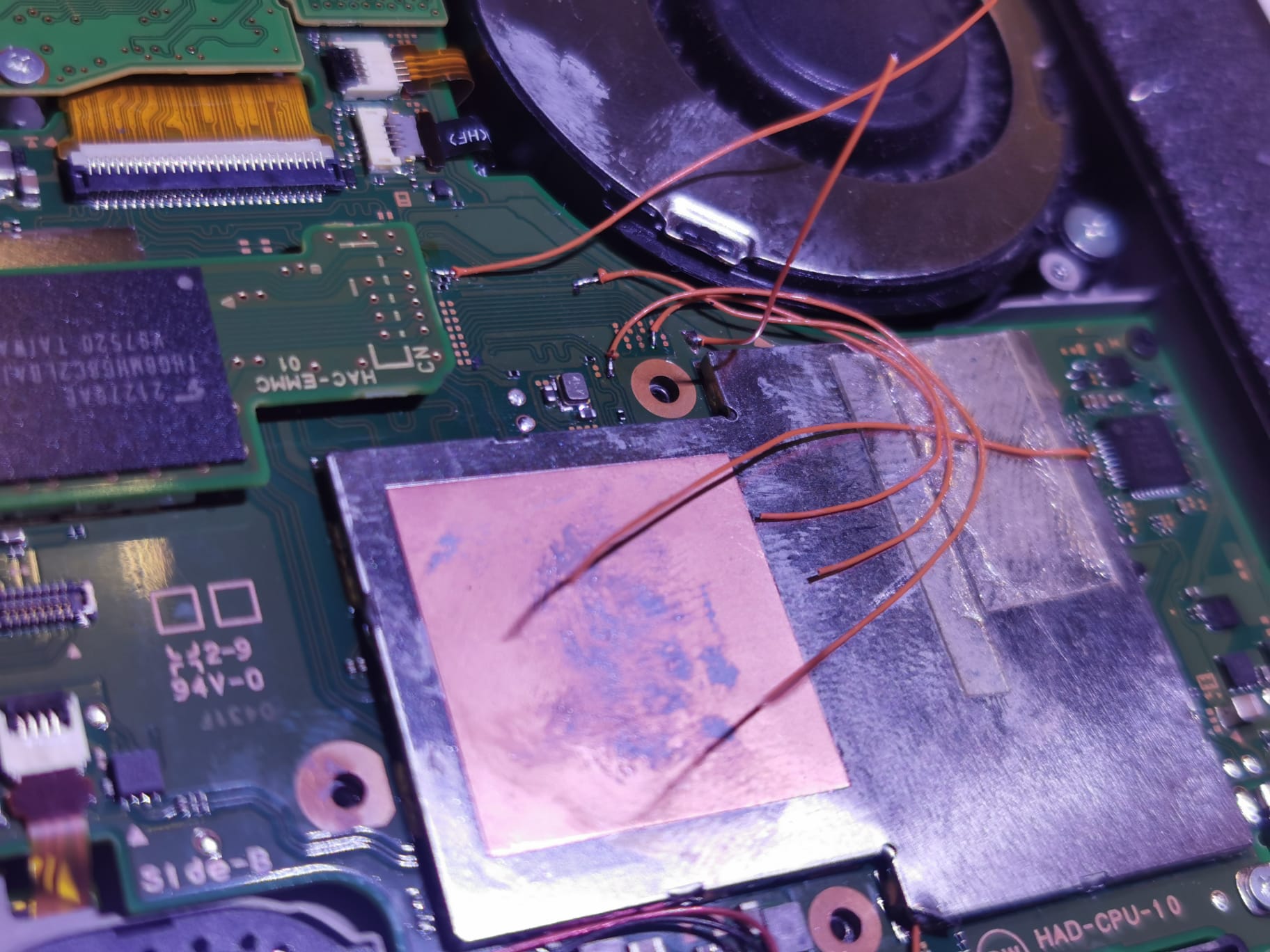

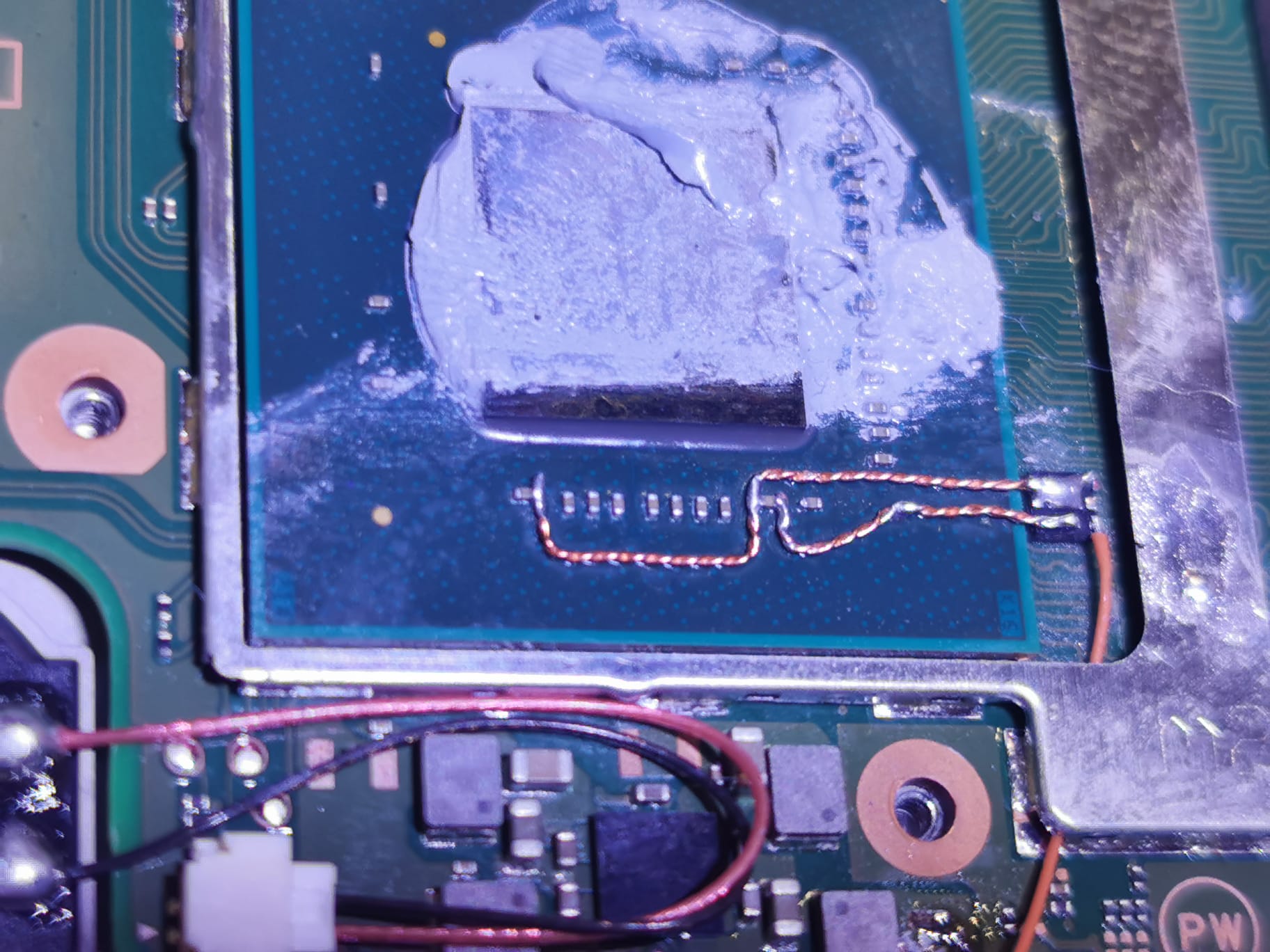

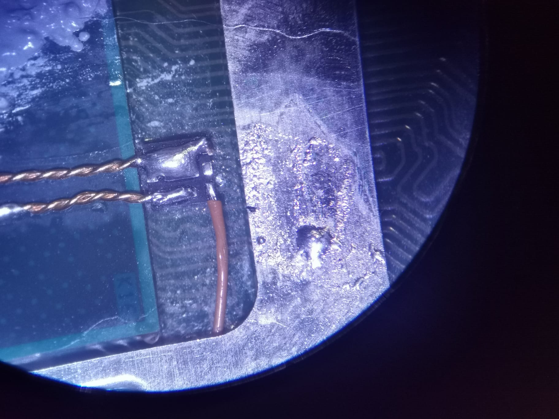

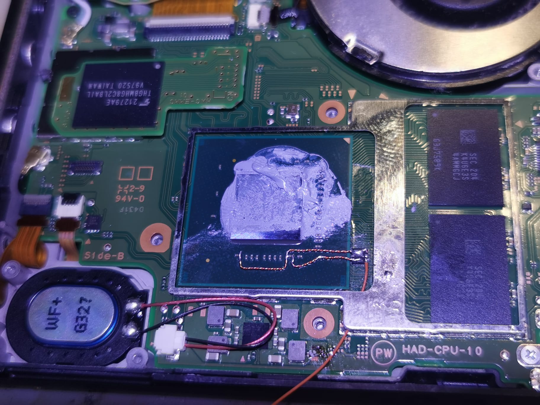

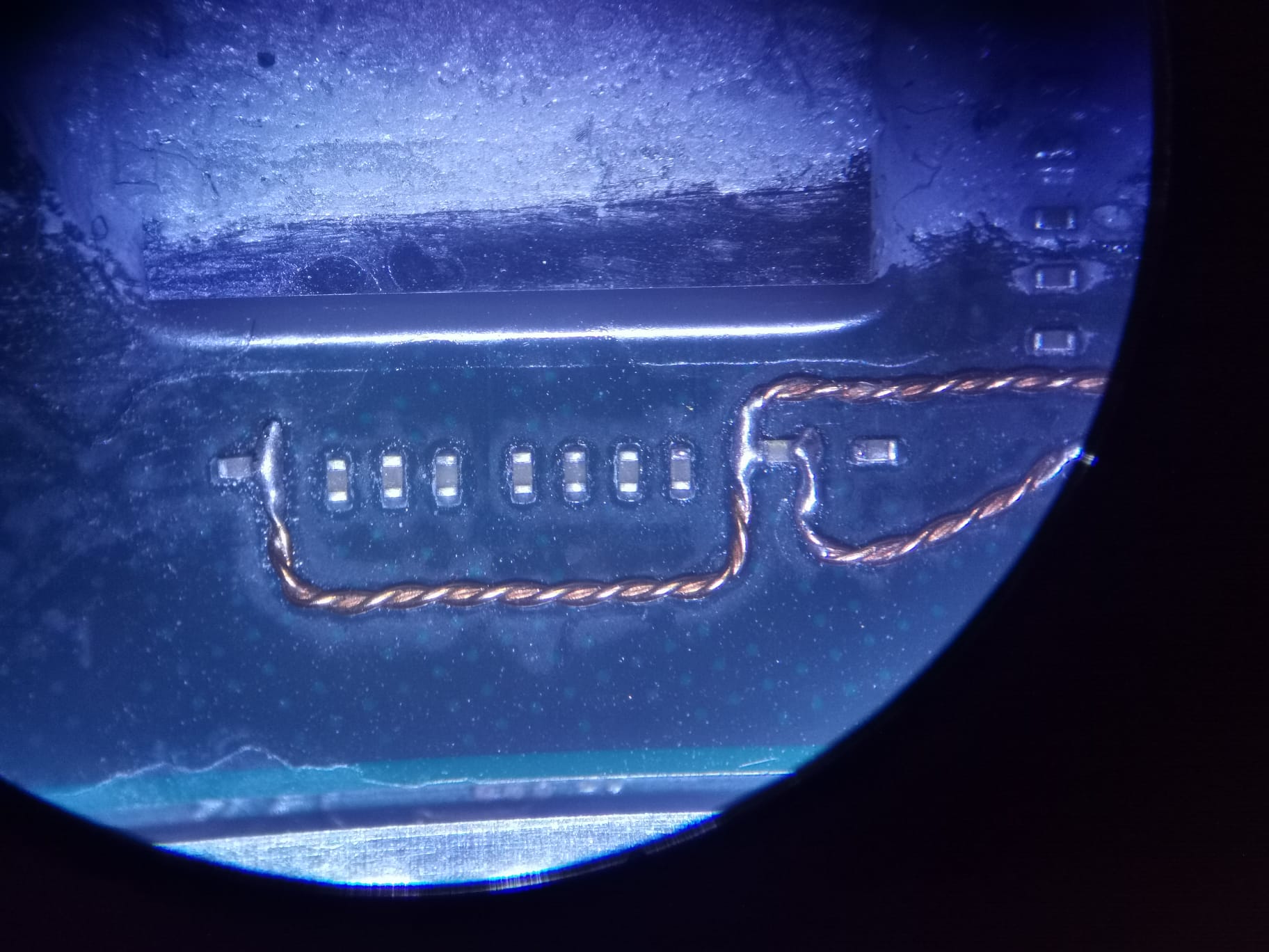

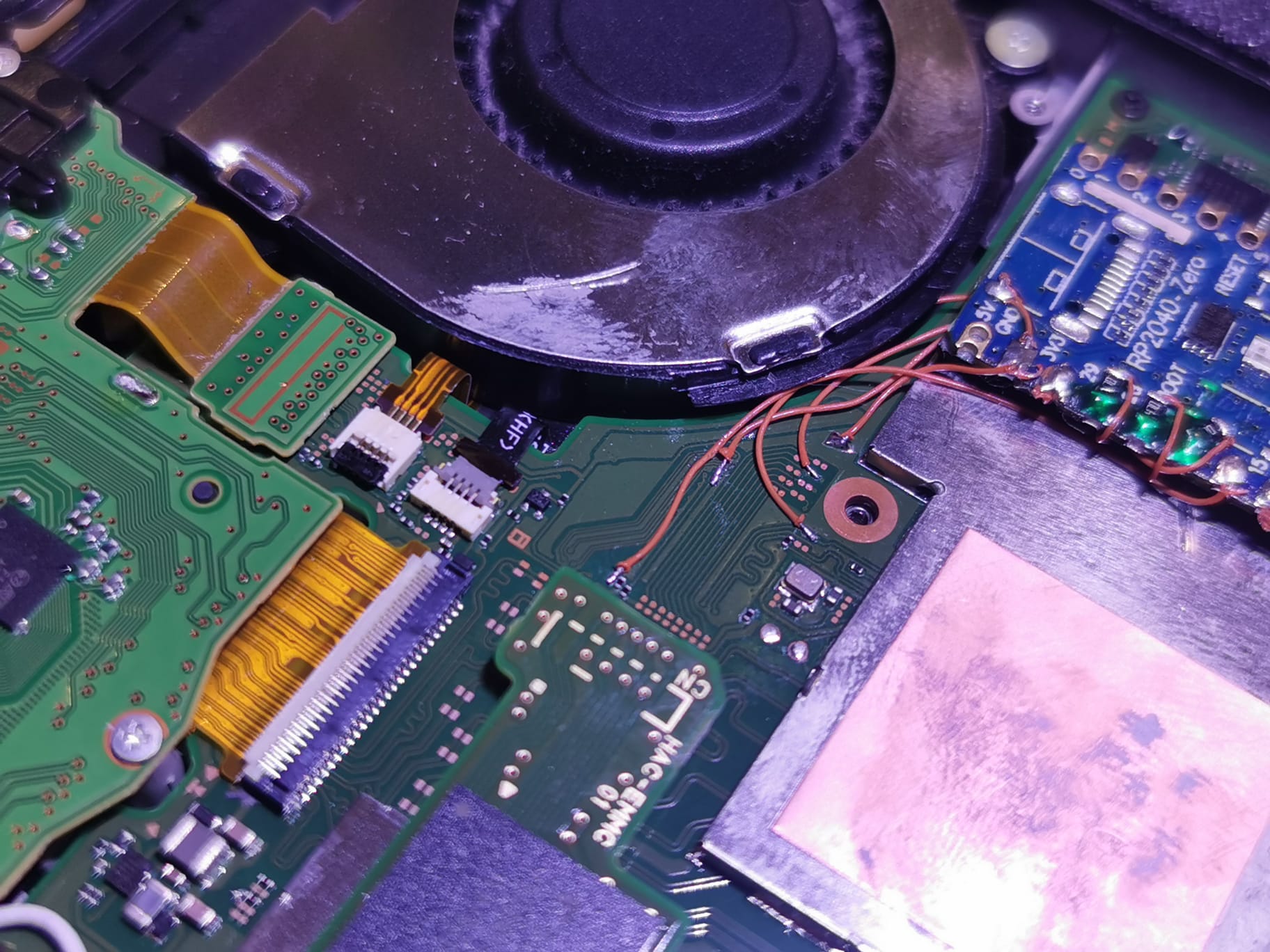

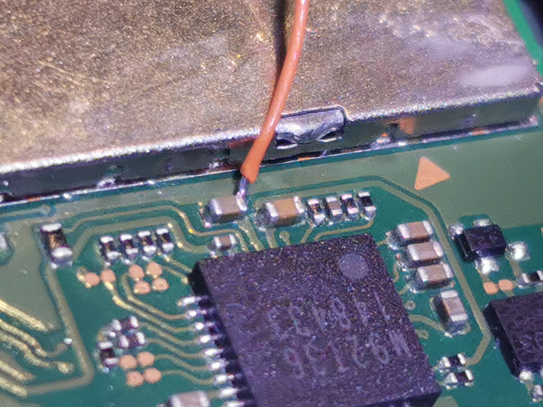

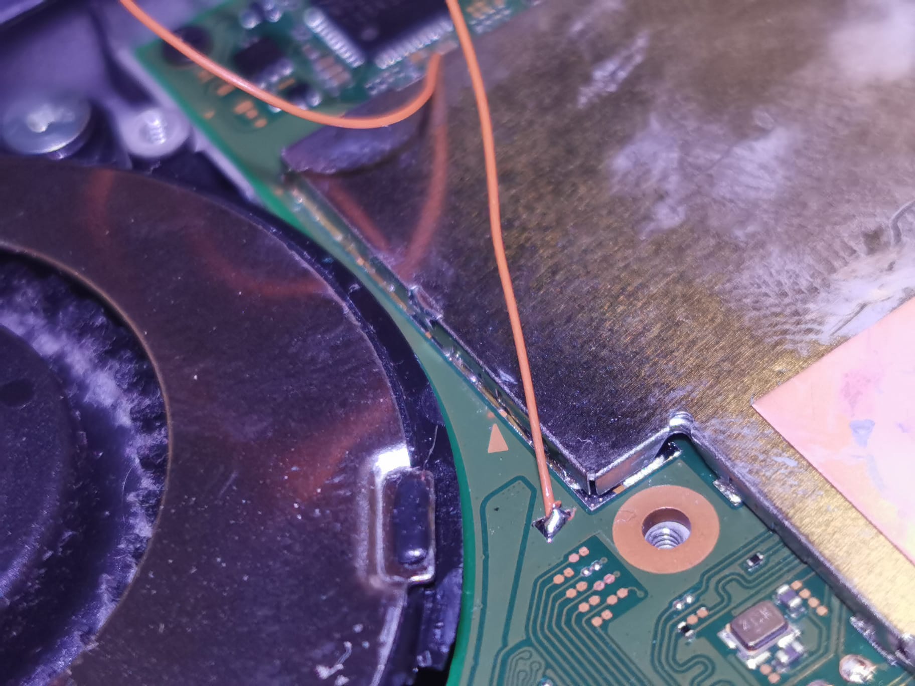

Good evening guys.
I've always used ponits as close together as possible to shorten the wires.
If it helps, I share this installation where I routed cables under the rp2040 and where you can see the wiring before installation.
By the way, PICOFLY is the bomb.
To date 15 out of 15 consoles all installed and working.
More importantly, even after a few months now, no customer has suffered damage due to explosions or fires. :rofl:
Thank you all.

Nice work and nice pictures. We love your twisted wire also :D

What kind of wire are you using for the mosfet?
Wire AWG 36 from aliexpress.
2) Varnished cable taken from winding 0,2mm +/-
Befor you install pico in console. Led was blue the yellow 4 time blinking???
Befor? When i flash it? Yellow.
A first boot, See with your Eyes
Wow really nice soldering job! What mm wire are you using for the mosfets? 0.2 mm twisted together?
Yes bro!
