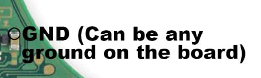

The error code is RST disconnected.
But i confuse with your configuration.
The GND pin seems not being soldered.
The D0 resistor seems 91Ohms.
The cmd resistor 47Ohms, and the clk i can't confirm what ohms is that.
Maybe some history why you use that configuration?
They soldered to a GND pad from the Reset Button :unsure:
