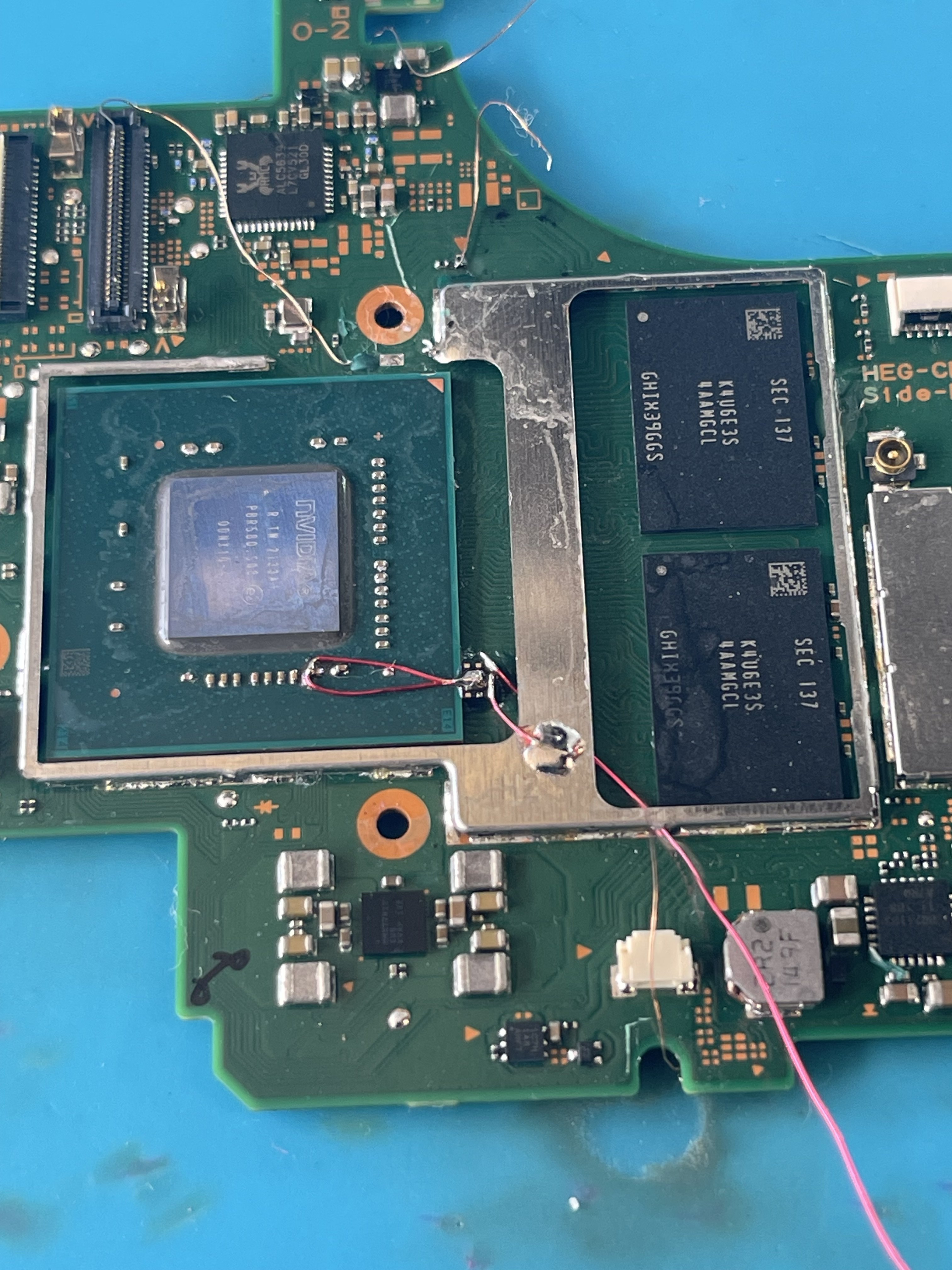

Just doing some experimenting. Undid my oled which had 0.1 all throughout with SDA/SCL wire soldered (I was given the ==* error code). Decided to pull apart to use 0.2 for the mosfet, GND, and 3V. The rest I kept 0.1. Even after doing all that I’m still given ==* error code. Will add 30awg to gate to see if that makes a difference.
Update- adding 30awg to gate did not make a difference.
Did you try soldering to the other cap (the one on the left)?
Did you try other type of mosfet?
Or maybe soldering directly to the cap (No wires)?

i have not tried any of those things. will give them a try. i dont have any other mosfets to try with

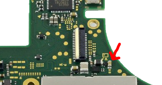

Anyone? Can someone measure this capacitor and tell me the value please. Switch lite next to card slot connector. Thanks.
The MOSFET gate is very high impedance, meaning the wire connected to it carries very little current. It is no surprise that the thicker wire made no difference for this connection.
