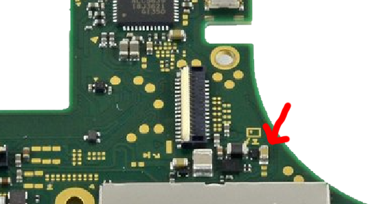

can i use AON7506 on switch lite?
I used the same one on Lite so it should work no problem, 1second glitch

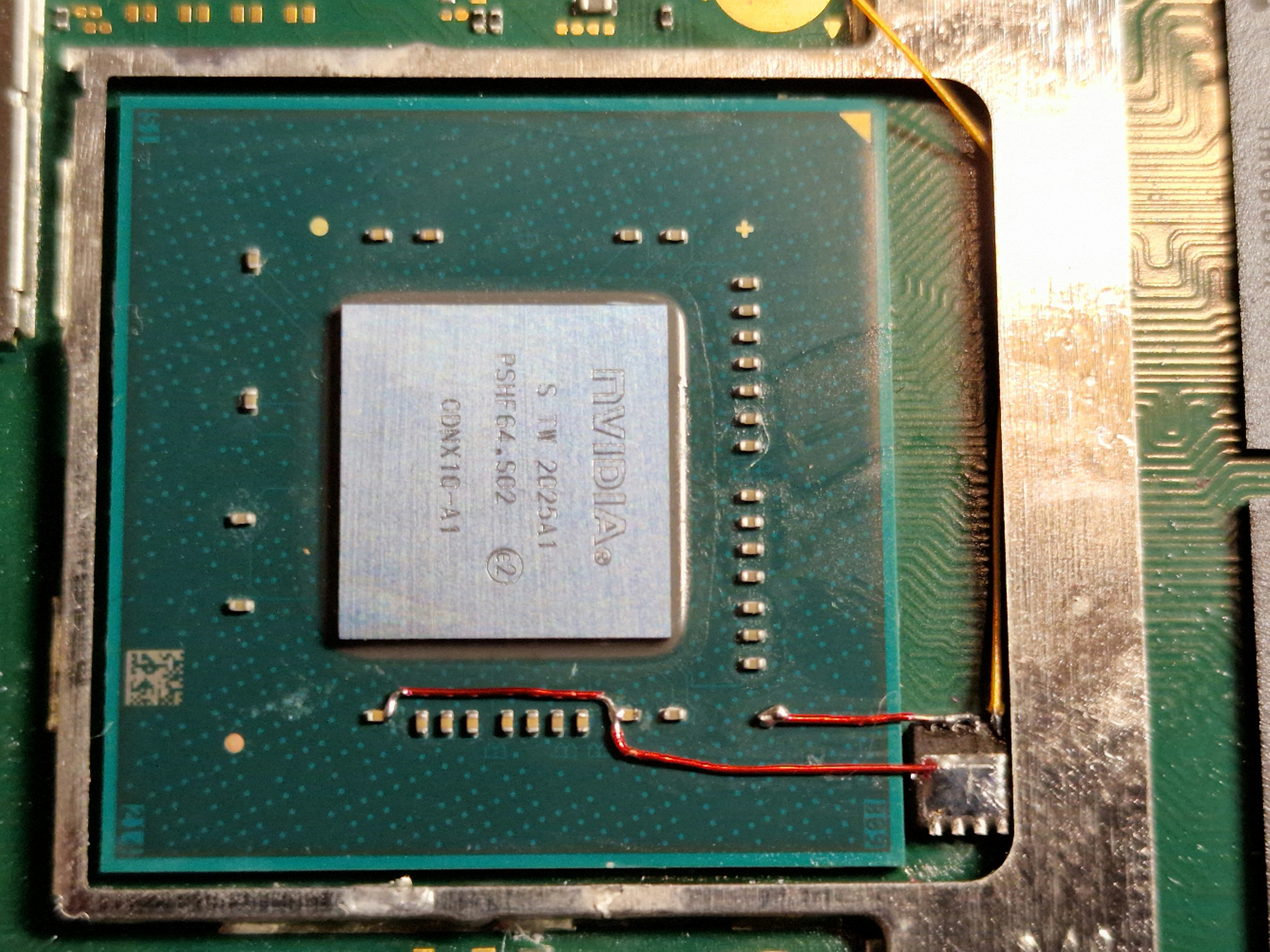

@Dee87 Thanks for the encouraging words and insight, tips and advice on reballing, helped a ton. And @QuiTim. Its all about the next challenge and this was worth it in the end. Want to take out the hit and miss nature of the Dat0 adaptors and go 99% secure and permanent in the process.
No problem that's what we are here for :).
Yes get rid of those shitty dat0 adapters and do it the only correct way XD
AWG30 wire?
Does it fit flush under the CPU shield cover with heat pipe?
The wire is 0.2mm so 32awg I think. It fits perfectly, no need to cut anything and it does not touch the shield (although I added some solder mask on top of it before closing just to be safe)
I made this diagram correct?
Correct. I placed mine upside down because it aligned better with the wires from apu

Now, the console won't show anything on the screen. If I remove the SD card and try again, I get the "No SD Card" logo again. What am I missing here? Any help? Thanks!
PS: If I push both volume buttons before powering on, I can enter official firmware. So I think Rasp.Pico is working ok. I don't know what's happening when inserting the MicroSD card.
Can you show pictures of installation?
Where are you getting 3v3 from?
I got 3v3 from the capacitor to the right of the RAM modules, as shown in the PDF Picofly guide that is uploaded on this forum.
Is it similar if you use hekate rather than directly fusee.bin?
Hekate does indeed load with no problems when put on the MicroSD card root folder renamed to payload.bin
In summary:
- Console is V1 Erista patched updated to last firmware (16.0.3, I think)
- Multimeter installation checked ok. I've been doing console modifications since PSX era. Not new on that. CPU points have the correct hwfly ribbon v1 cable with mofset included on it.
- 1st boot took a while while the chip tested glitching. Following boots take no time. It boots right away, so the chip learned the correct glitch timing.
- If no MicroSD card is present, I get the rasp logo and text "No SD card"
- if powered on with both volume buttons pressed, it boots into Official Firmware
- if I take hekate payload, rename it to payload.bin and put it on the MicroSD card root, it loads Hekate with no problem
- if I take atmosphere fusee payload, rename it to payload.bin and put it on the MicroSD card root (with all atmosphere files too on the SD card), it won't boot. It stays on black screen. And that's my main problem as I can't boot into atmosphere.
Am I missing something?
EDIT: Installation photos attached. (I always put a little coin next to the solder points to scale the size. It's a habit I have)
In summary:
If you do emmc benchmark test in hekate, it finish with a slow emmc mode?
In summary:
Did you try booting fusee from Hekate?
Reactions: QuiTim
It looks the emmc is not "slow", but a regular one (screenshot attached)
Yes, I've tried that and it works and loads Atmosphere with no problem.
I don't know what can be causing the issue of not loading Atmosphere directly when booting, but Hekate loads (and Atmosphere loading from Hekate works ok, too)
Anyway, that's a little inconvenient and I'd prefer to load Atmosphere when booting the console.
