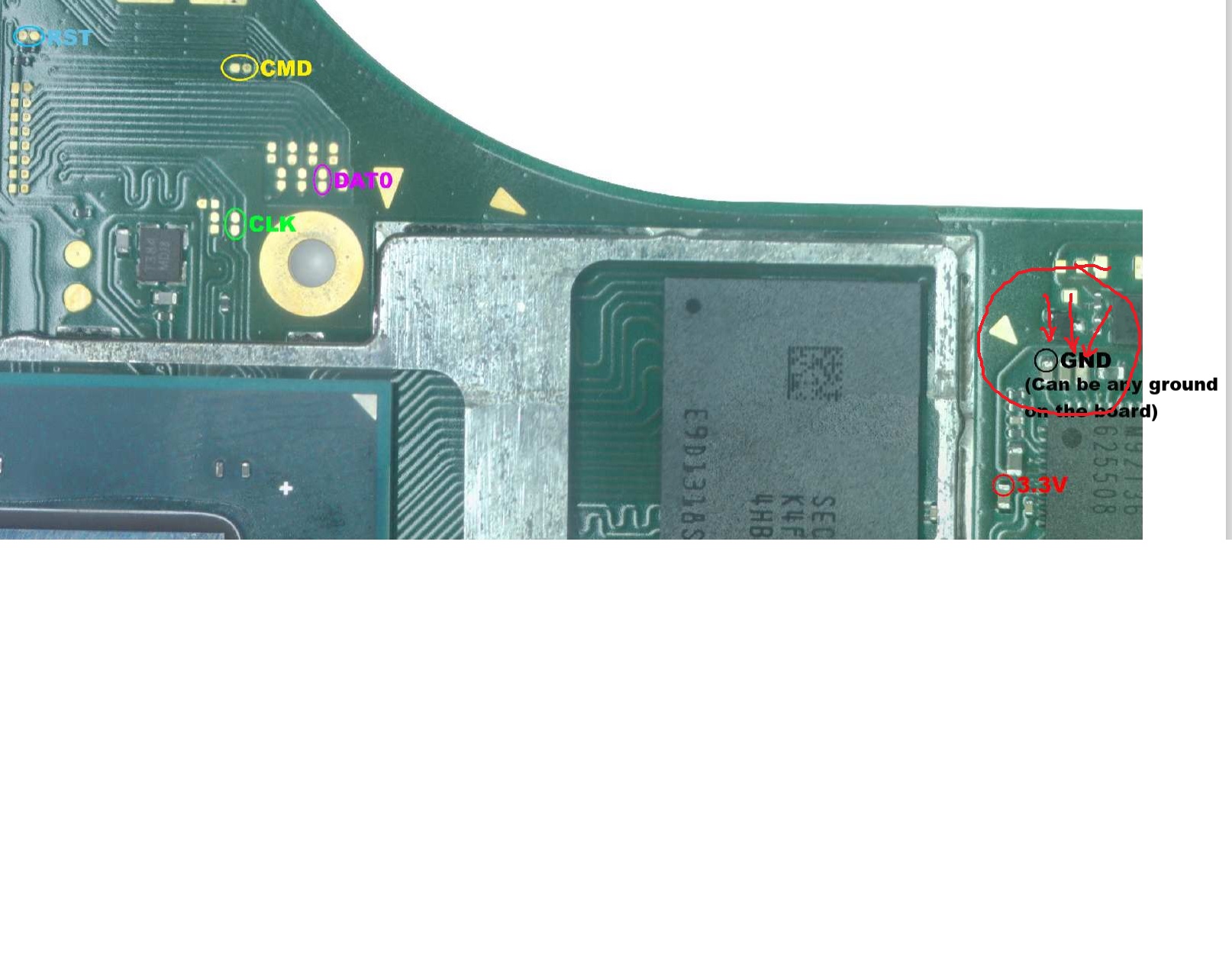

Quick question. I accidentaly made a bridge on the capacitor for the GND point on a V1 Erista Patched that I can't easily fix. Next to that capacitor for the GND point are 2 more capacitors. Are all connected to GND and the bridge doesn't matter?
I uploaded the image of the board and to the right, I made 3 arrows where the 3 capacitors are.
Thanks!!

All GND on the device are grounded together, if you really just bridged two GNDs, they're already connected. Always verify with a multimeter.

Yes, I know all GND on the device is connected. What I'm saying is that I bridged that capacitor for the GND point to the one that is on its right. There are 3 of these capacitors together. I was just saying if all 3 are connected together and my accidental bridge doesn't matter.

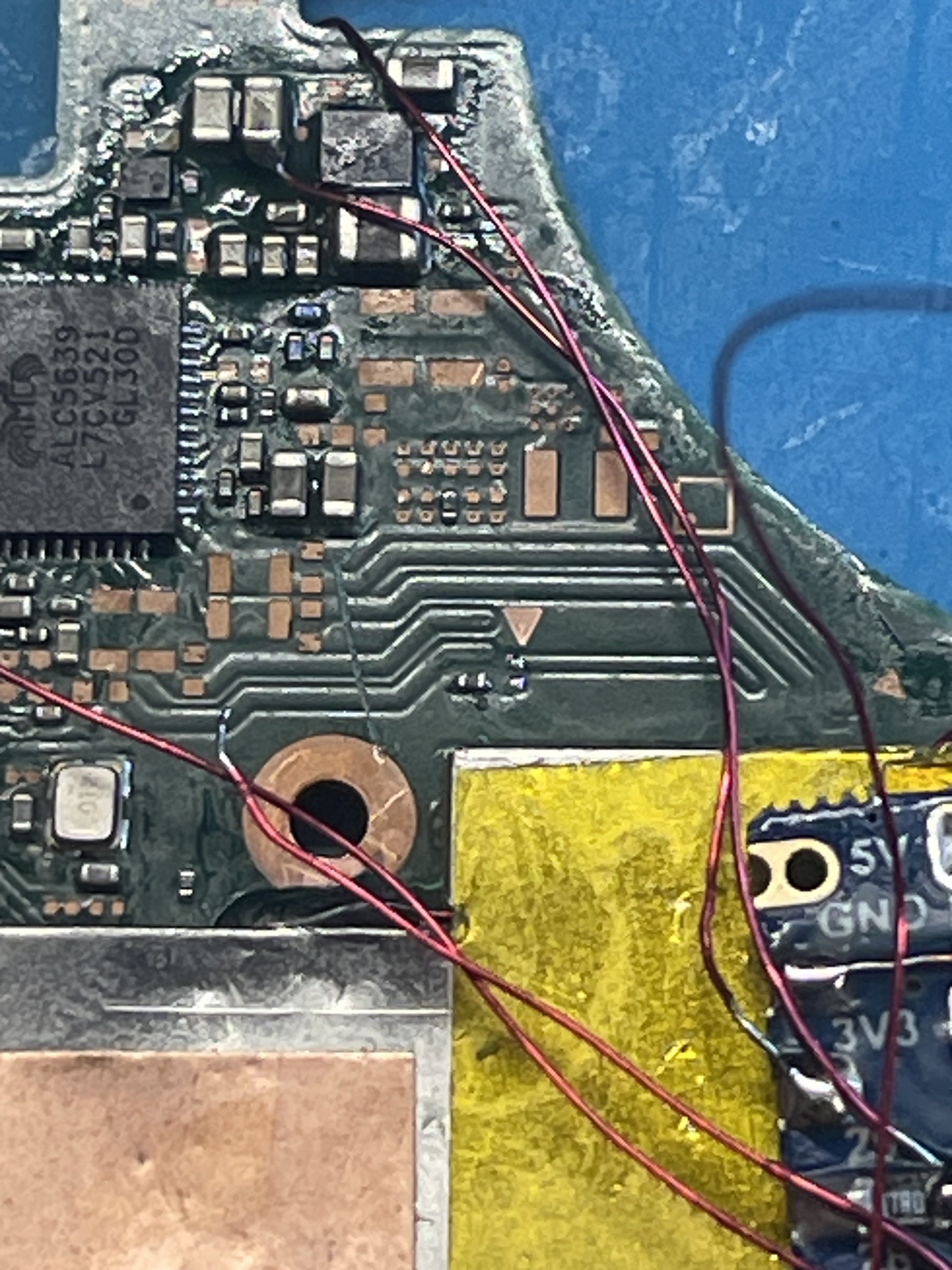

Does anyone know the value of this little guy for CMD on an oled? Accidentally took the end cap off.
