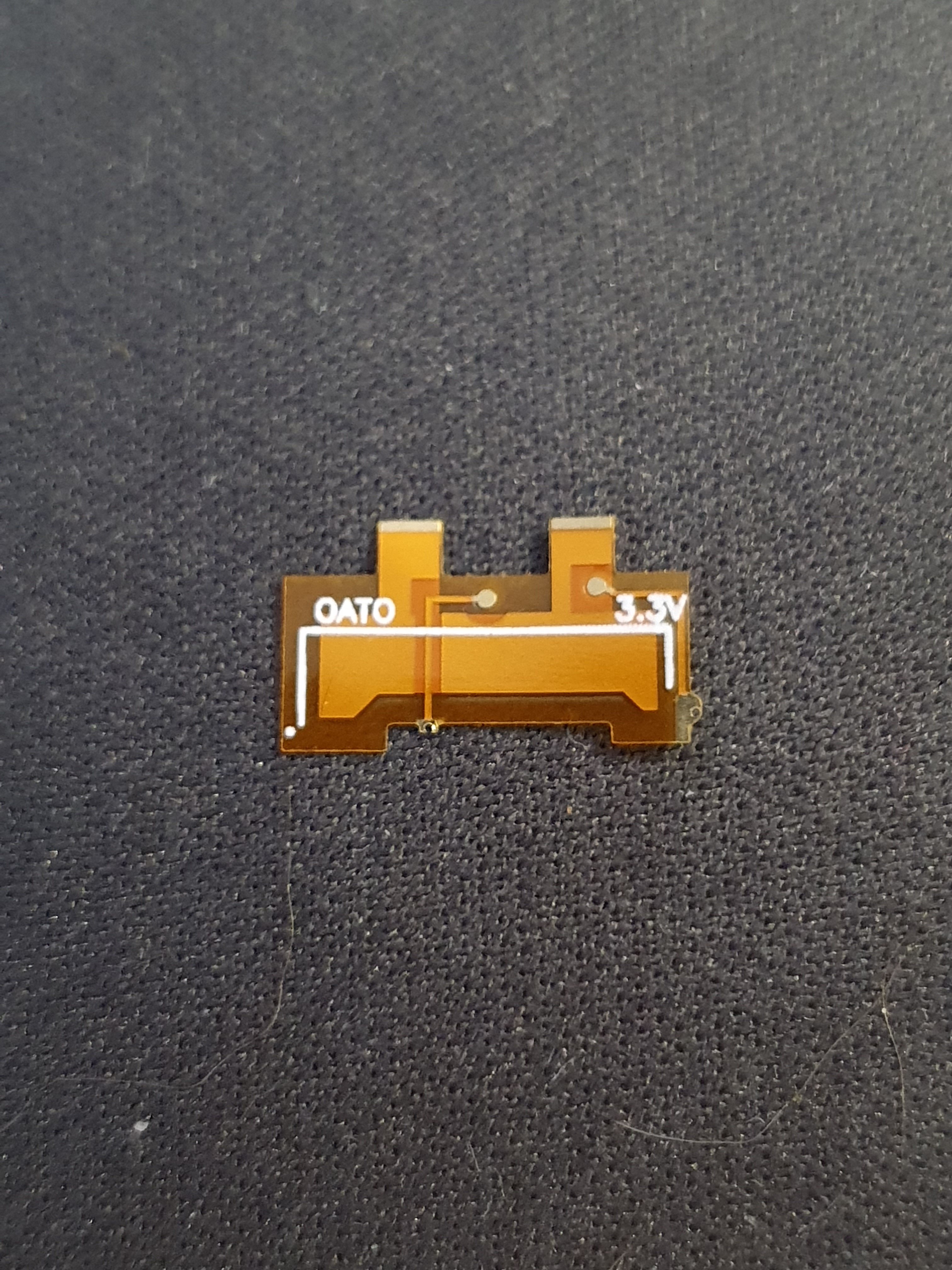

Hi everyone,
i've got a question for you !
I use this Dat0 for switch oled with rp2040zero :
i see 2 vidéos :
this one and no cut on the motherboard
and this one via the guide : and he cut the mother board
so i'm wondering what i'm doing to do ? :/ 😥

Well what u have there is the special 0at 0 adapter it needs to be modified check this thread or the main hwfly thread there is a example how u need to modify that adapter....
My opinion is just avoid those adapters and set permanent dat0 point but for that u have to reball and reflow
Well u where working on the board so maybe u accidently messed up some wiring
initially I grabbed the component in the picture and that was the wrong value. I’m wondering if maybe it killed the mosfet. Wiring hasn’t changed.
À very big thank you but I can't find this in the hwfly thread ...
So for oled picofly we don't need to use the 3.3 v on the dat0 ?
I can modifying the dat0 to remove this 3.3v point ?
as far as i know but dont take me by the word cause i never used and never will use those trash dat0/0at0 Apadter cause where ever u order u might be lucky and get a good one or not, the one u have for example is actual a piec of trash cause the risk if very high to bridge dat0 and dat1.
so u need to wait for @abal1000x to answer on that.
Don't use 3v3 on dat0. There is no need for it and it just complicates thing. Use the 3v3 provided in the PicoFly Guide by lightninjay.
Also cut that adapter as explained in this post https://gbatemp.net/threads/picofly-a-hwfly-switch-modchip.622701/post-10173282.
Good luck
This one.
You can read my post from yesterday https://gbatemp.net/threads/picofly-a-hwfly-switch-modchip.622701/post-10190949
I did this with ideas/tips from Dee87 and also from reading the post of Takezo-San, LogicalMadness, Phantomas77, lightninjay and a couple of other users here (too many to mention and can't remember the names right not) which were very helpful with everything related to this mod.
I would suggest you read through the Hwfly thread (the one with 500+ pages), because pretty much all the info is there.
