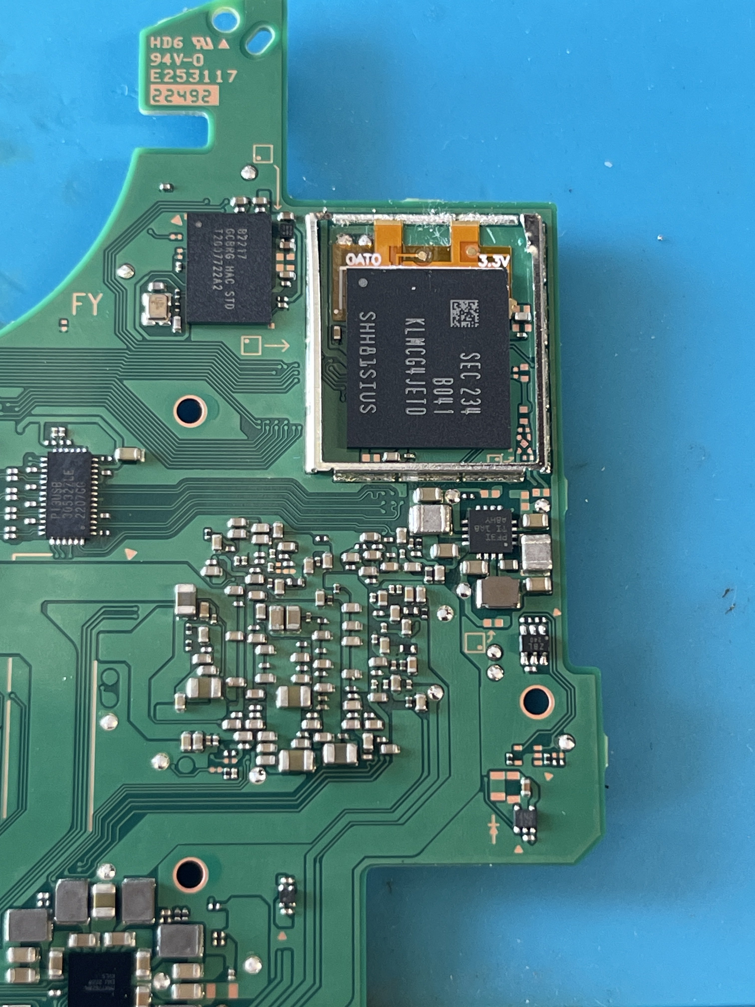

Getting .45v from this switch for DAT0. Used 3 different adapters. Is .45 sufficient?
Depends on the emmc not sure anymore think between 0.5 and 0.9
But ur using one of those 0at0 adapters which tend to bridge dat0 and dat1.
Best bet for u if ur doing a lot oled learn how to reflow that way ull never have such issues i have done 20 Oleds and never had an issue during the install.
In generell I only had one issue out of 40+ installs and that was on my first mod where I tried 1 MOSFET so I used 2 and never had a issue after that.
