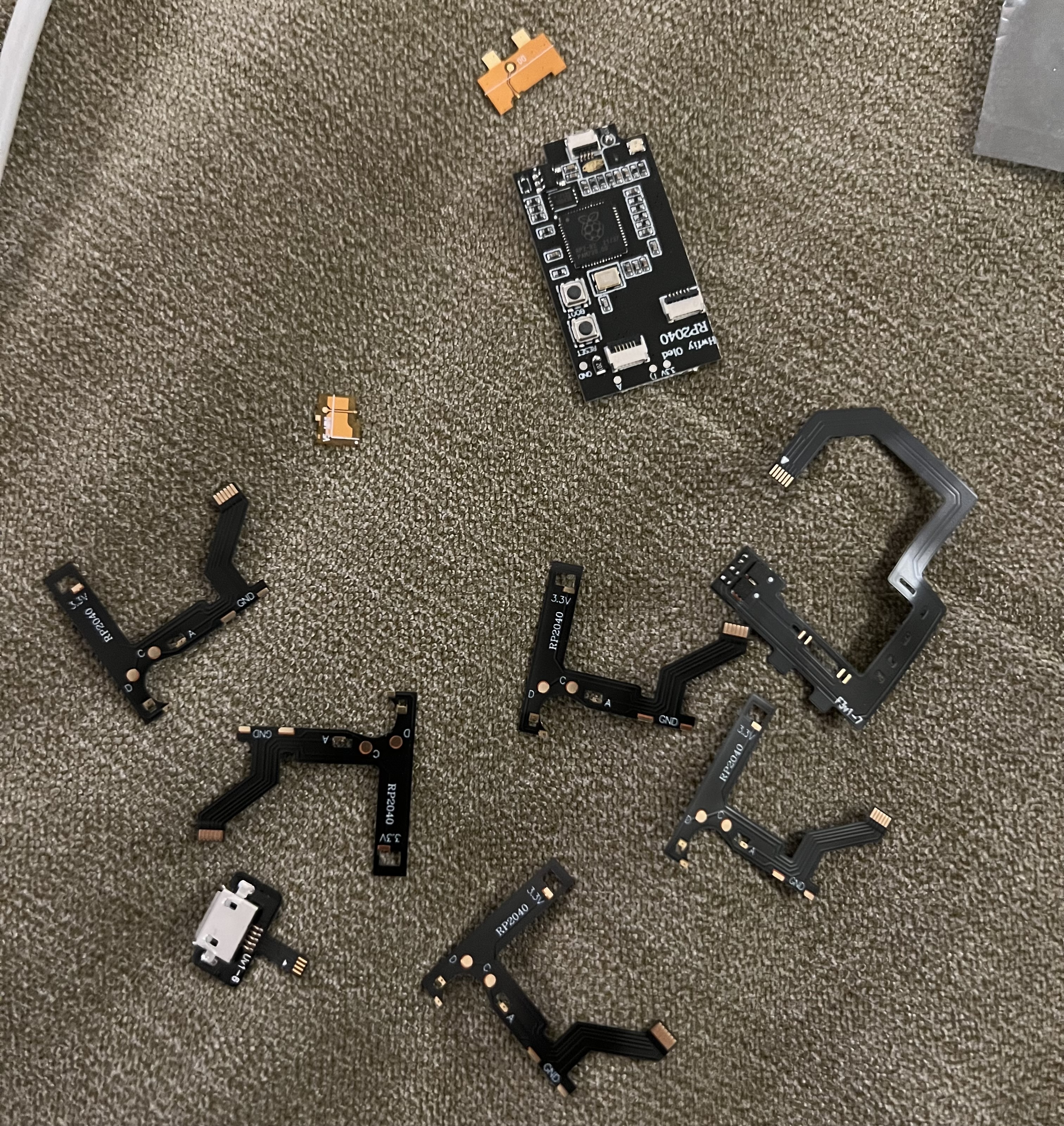

Hey all. Hoping I can get some help here.
First time Switch modchip installation here, but I managed to install the Hwfly RP2040 modchip onto my OLED this weekend. I was very excited to see the "No SD Card" screen and thought things were going to be fine from here on out. Hekate boots up fine.
However, any attempts at interacting with the emmc are failing, and if I attempt to Reboot -> OFW, I get the purple screen.
I've been trying to search the forums here and, if I'm understanding correctly, it seems like the most likely cause is a bad point A / CMD connection (or blown resistor).

I will open up the unit tomorrow to take photos (and probably verify / attempt another CMD connection), but to answer your question about which modchip, the attached image is what I received from Aliexpress. I used the larger dat0 adapter and the OLED ribbon cable.
Possibly off-topic, but I did not update the modchip so I'm not sure what firmware was installed on it from factory. When I run `picofly_toolbox` and click Firmware -> Info, it simply prints "Reading firmware info..." and then "Press any key" without any additional firmware information. I also attempted to update with the `update.bin` from v2.7.3 and it said it updated successfully, but I'm not really sure since it still doesn't print firmware information. I don't think this is related to the main emmc issue, but curious if anyone had insight into that part as well.

Did you used the included dat0 adapter of this kit?? If yes this is your problem. Remove it immediately!! And just hope you didnt corrupt the emmc chip or else you must rebuild.
