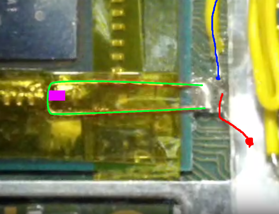

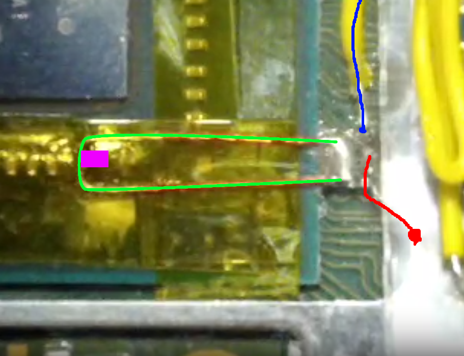

Here 1 mosfet IRFH3842 to 1 cap.
Glitch after train. <1sec.
And this is when i tried it a multiple time, to get the gist of the average glitch time.
Can you kind of explain what's going on in this picture? It looks like D and S are soldered together. And then are you hitting just the top of one cap or the bottom as well?
@abal1000x likes to double back his wires for the Drain to effectively double the capacity of the wire. The Pink is where the capacitor is. Red it looks like he's grounding Source to the APU shield frame, and then Gate goes to RP2040 like normal.
Oh i see! its in a different orientation than i would normally do mine
well maybe thats why he get it done with 1 mosfet :ohnoes:
guess ill try that the next time i get to soldering Xd
cause i try it again today and it did not work again so i dont know whats going on Xd

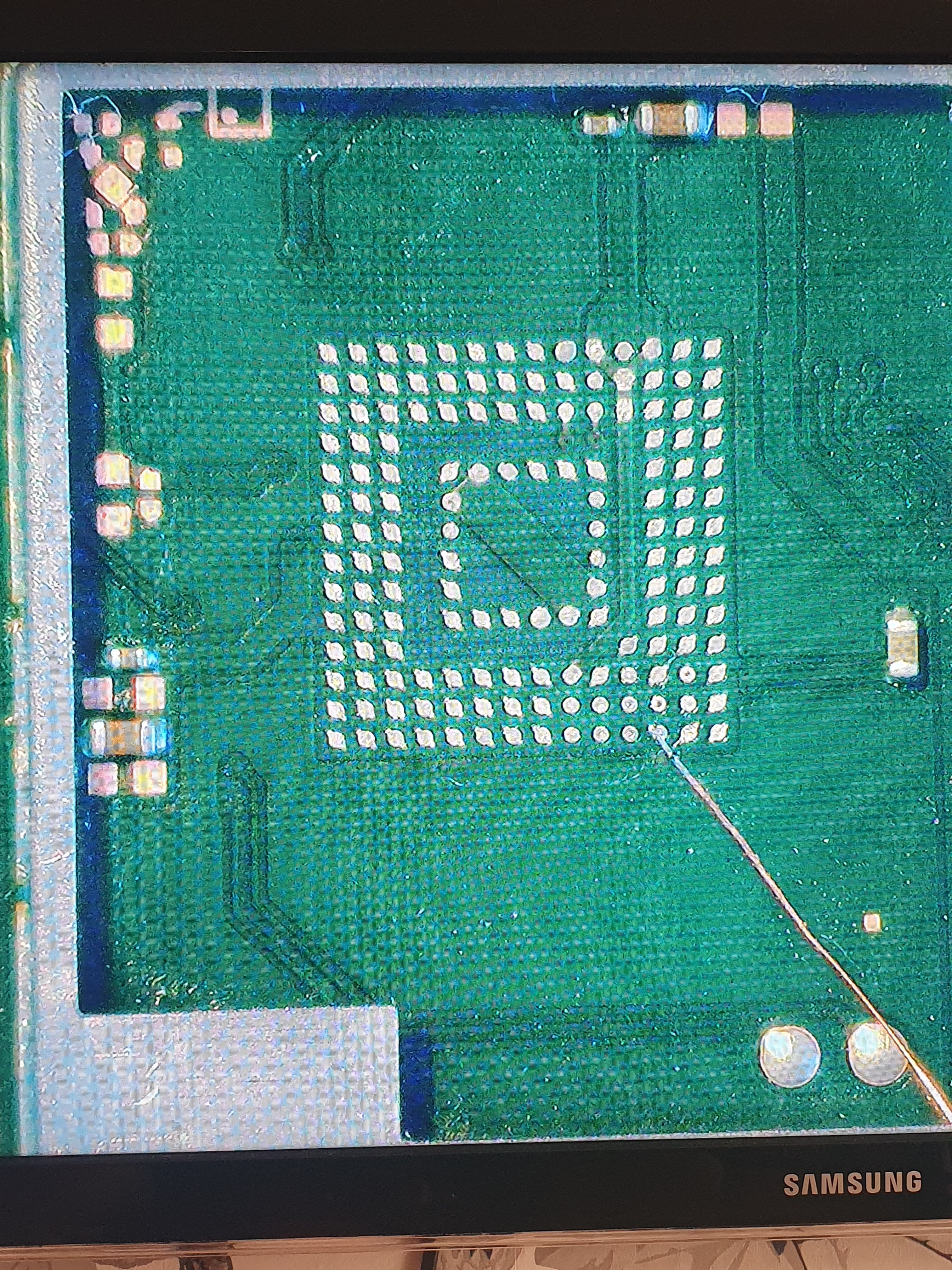

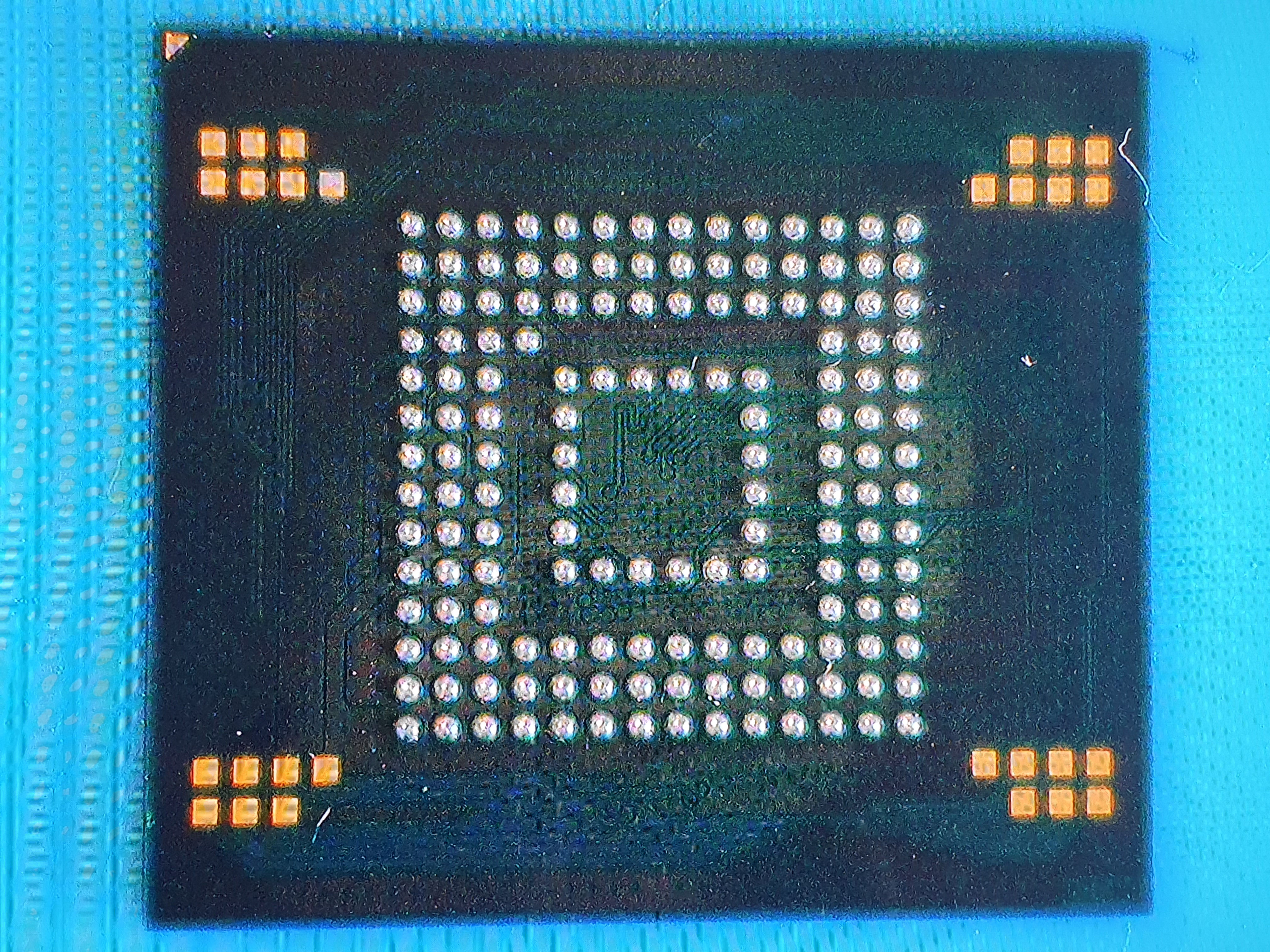

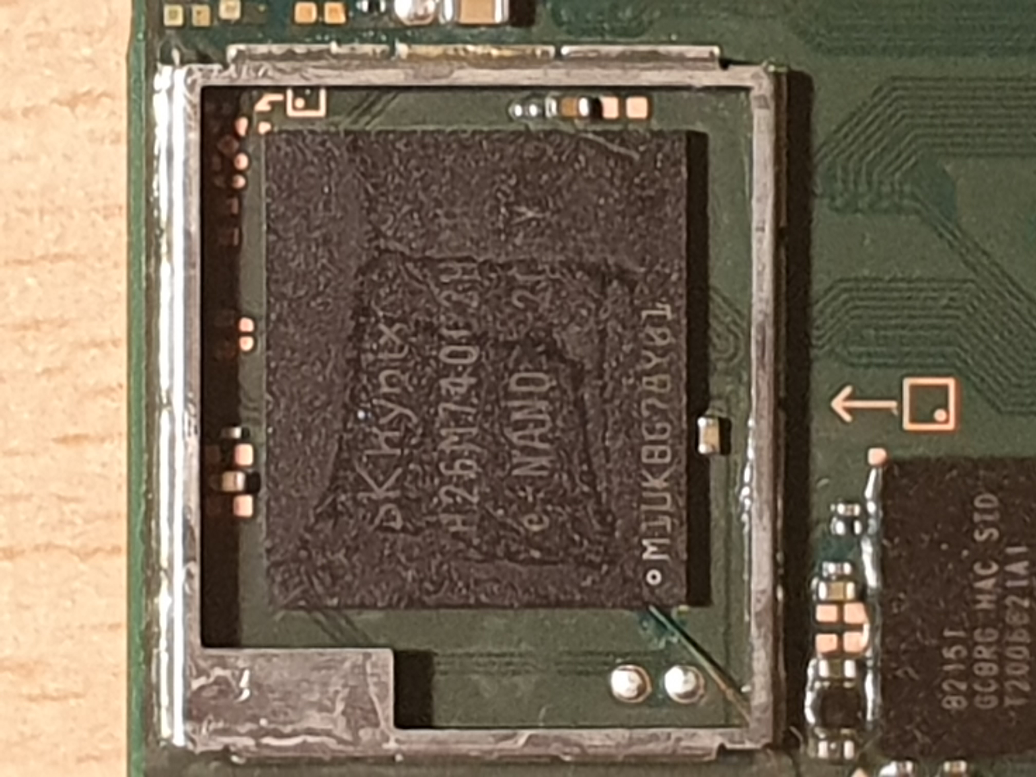

can anyone tell me whats wrong with this picture?
Or this reball job?
Only asking because I'm done! Got a value before and after of 594-627 for that Dat0 point with 40awg wire. Put everything back so i can work on the SOC side but just wanted to test by power it on and.......nothing. Not even a god damn charge symbol. Pure dead! To say I was careful with only 10% of the oled mod done is an understatement. Could the reball be shorting. Is it a dead emmc? WHat the flip is going on?

Dumb question but here it goes: is the chip positioned on the right side/corner?
Because otherwise everything looks good
Was only so hopeful because I practised with a dead board and the readings were all spot on with that and this. I wouldn't be so mad if I knew what I did wrong!? I even used kapton on all other parts of the pads of of the dat points so little chance of shorting. My assembly and reassembly was super smooth. Heating it back into position was good, snapped into position but im not sure if i went wrong here or its just the oled....not liking being dissasembled!? Honestly hate the Switch

I would position the dat0 cable straight
Is u look closer their could be something bringing,
Tha balls look "okay" they kinda look a bit "Crumbly"
If they look like that I would add son more flux and reheat them and slowly let them cool down.
What temperature did u use and for how long?
I don't know if it just the picture but the emmc doesn't seem to see perfectly, it should be kinda the same on the top left and bottum right square.
What reading are u getting?
Also I recommend adding UV mask above the emmc not under so the emmc doesn't sit to high.
After the emmc "floats" in place I always give it a very tiny hit in one corner so I see if sits correct
used 200 for 1.5mins then upto 300 for 1.5min then 400 for 1min. then backwards after it set itself. But if it was bridging, then why is the reading correct? I did notice that in the picture but it was just some fluff from cleaning. crumbly, maybe, but this is a super zoomed in shot. normal working distance look smooth.
Mh okay 400 seems a bit high I usually go max 320 for 20 sec if it doesn't move at 300 , but also know someone who goes max heat on it so not that sure if its an issue , thought emmcs do not like heat
