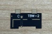

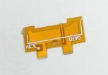

I see this black adapter being shown in the guide
The video linked though shows the orange adapter being used (trimmed however)
Is it ok to use the trimmed orange one as well or I should scrap it and get the black ones only?
The only reason the black ones are in the guide are as a reference to what is being spoken about. Any functioning Dat0 adapter will work. Several people here would urge you to skip the Dat0 adapter and just do a reball (I'm looking at you @Dee87 and @LogicalMadness)

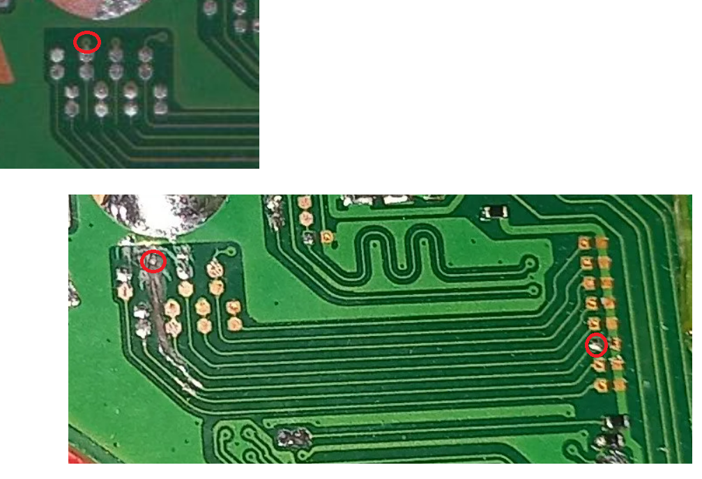

Someone can help me? :(
Broken thrills
I try tô fix but lost the point
V1 switch
Broken thrills
V1 switch
You need an ability to jumper with cable between these point to fix. You know its fixed when you can boot normally.
Or maybe better, just send it to professional for repair.

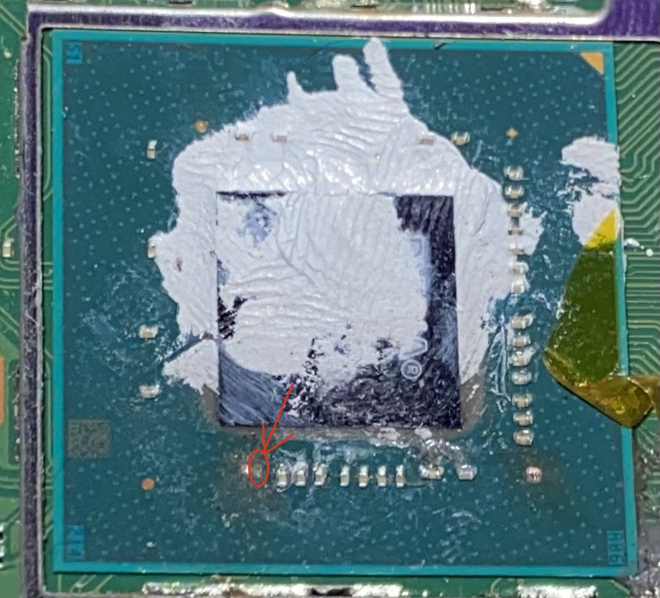

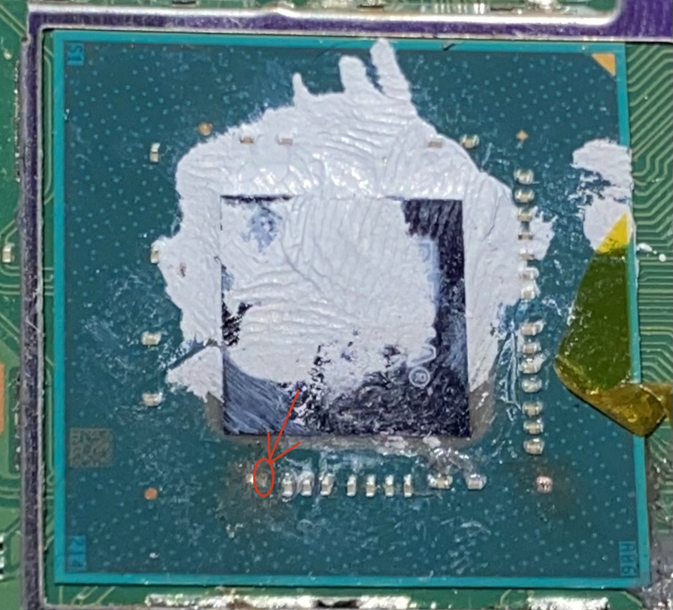

I broke the pad off the CPU, where the cap used to be. I assume there's no alternate soldering point for this, but i'm still asking?
If Switch is still booting just use the other cap. It works with just one of them
it's booting into OFW and runs games, but i broke off the pad that's used for the mosfet. i went with a single mosfet install and that cap needed to be removed, cause otherwise it's shorted
Does it glitch now?
nope the modchip never worked for me. i either got the mosfet error or the CMD error i believe. i can only run original nintendos firmware. i'm wondering if i did a dual mosfet install would it work maybe? btw i tried two different mosfets, Waveshare and Seeed chips and thats how i broke of this pad eventually
It should work. Maybe there is a problem with one of the solder points. Do you have pictures? What type of switch is it?
I would start from begining, pico with firmware 2.74, single mosfet, and SDA/SCL lines soldered as well. Then we see where that takes us...
