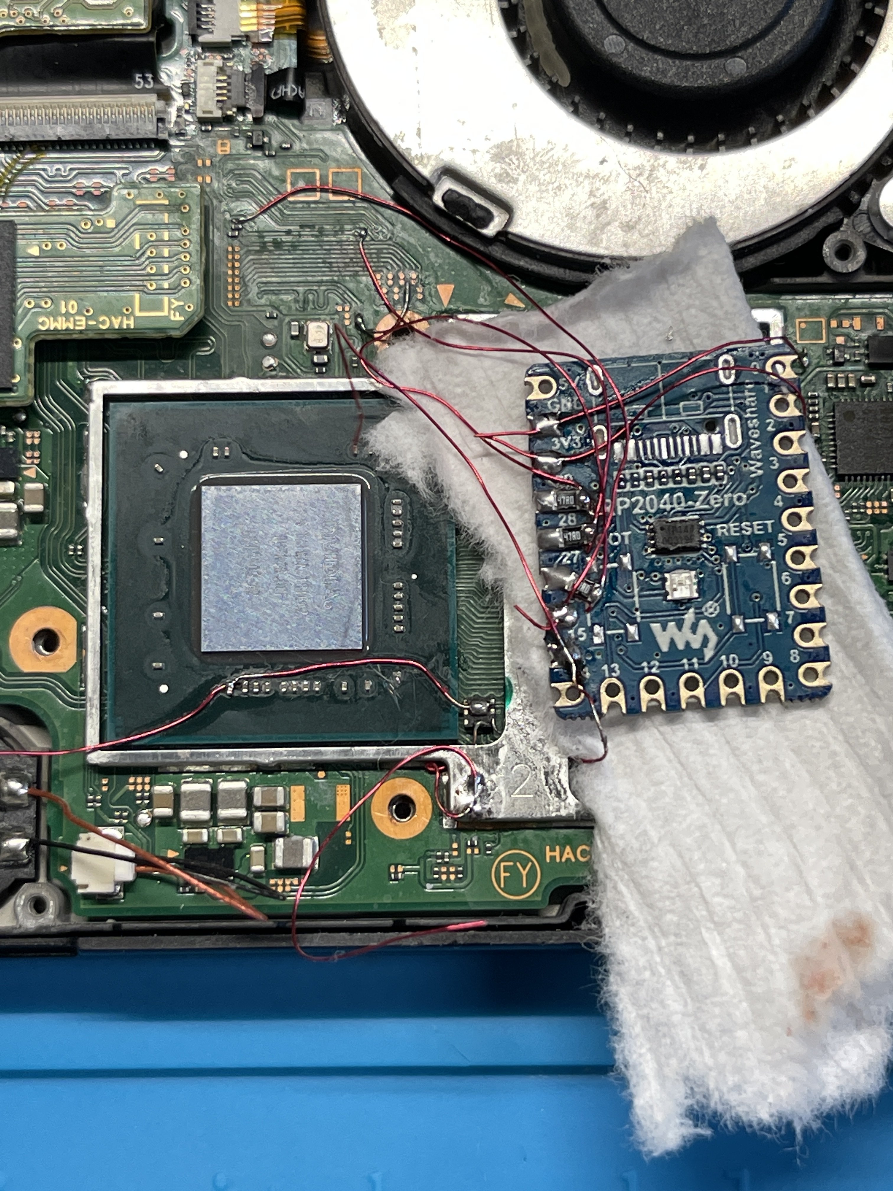

Well idk why it won’t glitch for me. I’ve not had a single switch glitch for me on the first try without having to use the SDA/SCL lines. Added a photo of my single mosfet install.
Try grounding to the shield. I've always done single mosfet installs without issues but ground to the shield as it's easier. Will try single cap next for my curiosity.
yes these are the correct mosfet
Ok well I will try a single cap when I get home. If it doesn’t do it then I have no idea what I’m doing wrong. Could you please post a pic of one of yours?
Thank you. Will try everyone suggestions when I get home.

I want to run this by everyone before I plug it in. It’s my first time doing a single cap and grounding to the shield. Is there anything I should change? I know it looks messy, but I promise nothing is grounded, and it'll get all cleaned up before going back together. ill move the ground to the top of the shield as well
looks fine.
let us know how it boots
looks fine.
ok im going to plug it in now. I have always used the latest firmware for the Pico. Will switch it up if this doesn't work.
if it doesnt work use 2 mosfets then it should work without a issue
it still didnt work. going to go with the two mosfets and will report back. Its amlost like it didnt even try to glitch before throwing the error code.
yah thats what i thought do a double mosfet like in the diagramms i bet its gonne work
so i did have time again to add the second mosfet and what should i say i glitches straight ahead not even 2 sec....
