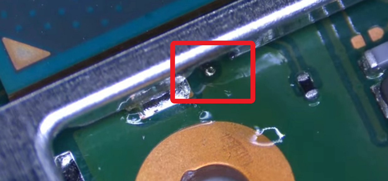

Some time console working fine after i close case after finish desolder every things it show nintendo logo then black secreen or not tearn on now it become boot to blue secreen... 👏 I read dat 0 point kimkaze it is GIVE value 0.645v not short or damge.
