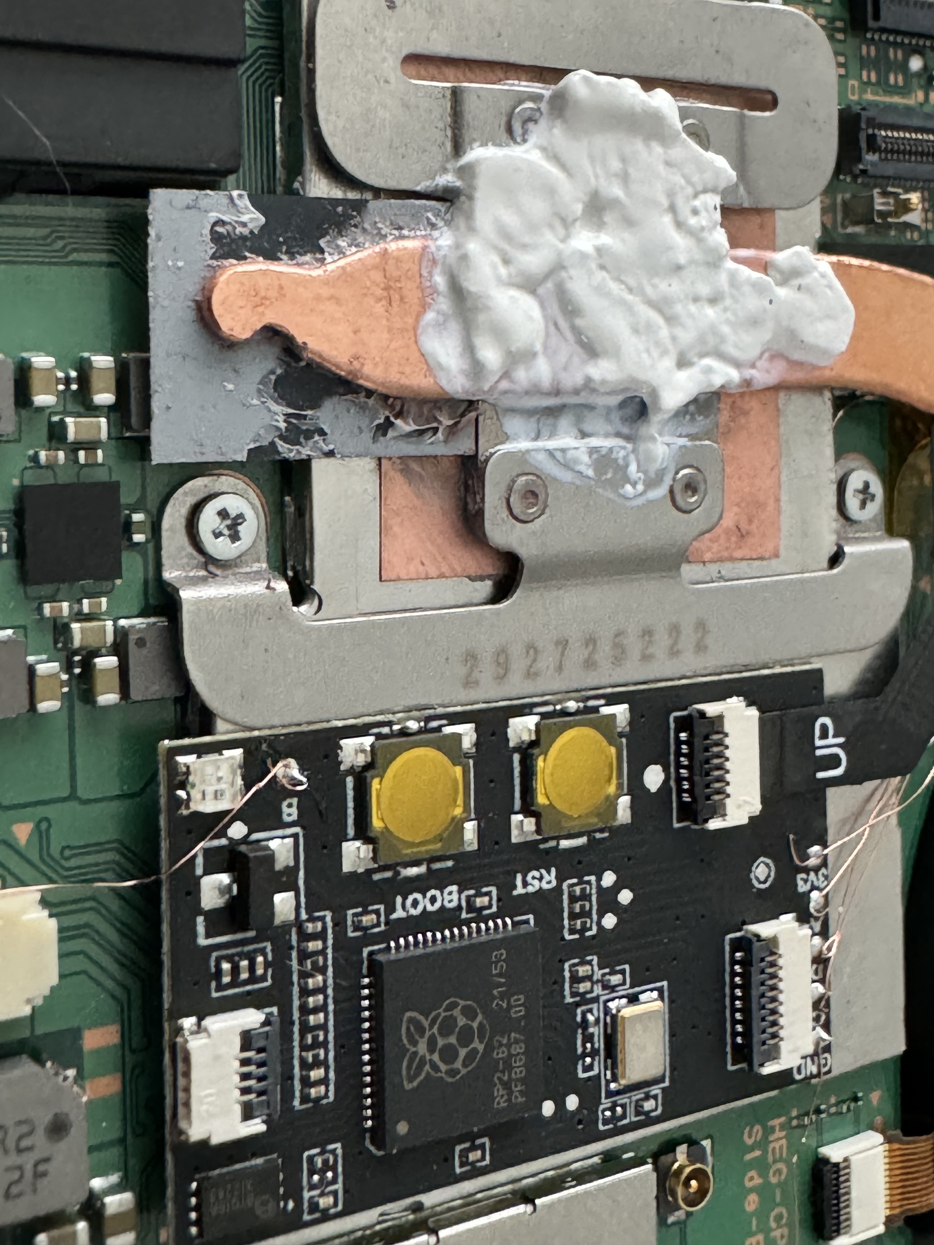

New clone hwfly install on OLED. Is this amber or yellow.. and what does it mean?? I had checked just before installing metal back cover, and received the “no SD card message”. I turned the console off, inserted the SD card, and continued closing up. Now there’s nothing on the screen, and this sequence lights up.
  • IMG_3165.mov
    27.7 MB
** RST is not connected
  • Love
Reactions: NizNoz and impeeza
RST not connected
  • Love

Fixed! Thanks for the help! It was indeed point B, but because I seated the chip slight in the way of the heat shield. Worth checking if anyone has a similar issue.. as you can see, B runs right next to the shield in my setup. I rerouted it, and shifted the chip a millimeter away.
