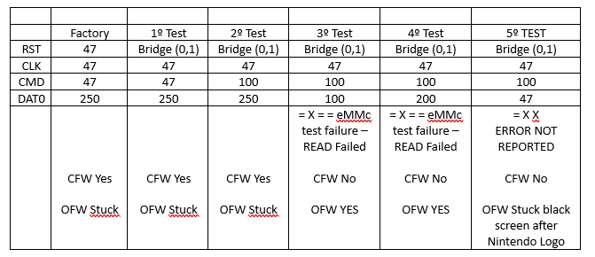

What are the values of these resistors?
B is the recommended values and the one to use, tried and tested since the beginning by the people here and as the picofly guide will tell you.
And i dont know why you keep on insisting with other values?
I come with some updates about, let me present the results.
Hi sergio can we talk via telegram about your findings to recover that OLED? @st0n3r_7
Looking from your table, looks like the DAT0 line is problematic.
When you use 250 all OFW stuck, when you change to 100 OFW working.
Maybe the nvidia try to read from Dat0 and failed, so the stuck.
Is this oled? if it is and you use the flex method, thats already explain by itself.
If its not oled, try to reduce the dat0 resistor to 47 ohms.
The standard is 47 ohms CMD/CLK/DAT0. Reset no resistor.
I use CMD/DAT0/CLK as 100/100/47.
BTW the rst should be bridged (no resistor). I try use resistor before, and it doesn't give any differences. Its only pull the voltage down to reset the cpu cmiiw.

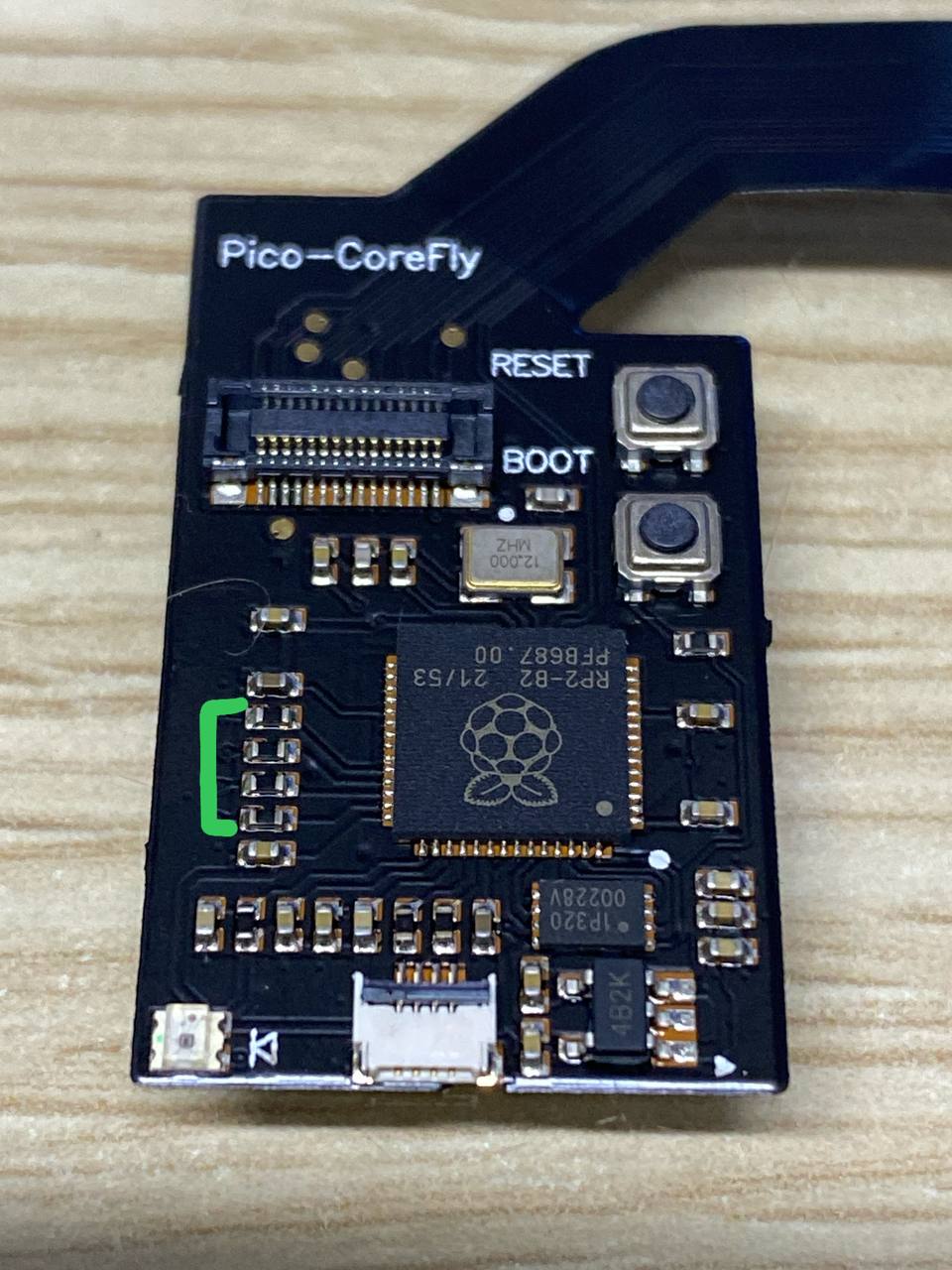

These or a very similar one are appearing on aliexpress. Nice quality flex though, clean cut and lines up well. The kamikaze connection looks promising but i havent used it. from vaalpaev store.
How do you achieve such a cleaning ? You have no trace of flux, no trace of IPA, everything looks dry and clean

So I’m currently working on an oled doing the kamakazi method. I keep getting =*** (emmc initial failure). I’ve cleaned everything and am getting the correct reading. Any help would be appreciated. Just checked and the switch still boots normal so I know I haven’t broken the trace.
Just installed a dat0 adapter to check that I have continuity between the two points and I do.
Reactions: Danook28
Resistor values? Which modchip? I had that same error once, and the cause was too much resistance on the CLK line (47ohm + the modchip had another 47ohm on board already).
Reactions: Danook28
And how do you solve it? Bridge de CLK line too?
I'm now on the 5th attempt according to recomendation on the forum.
