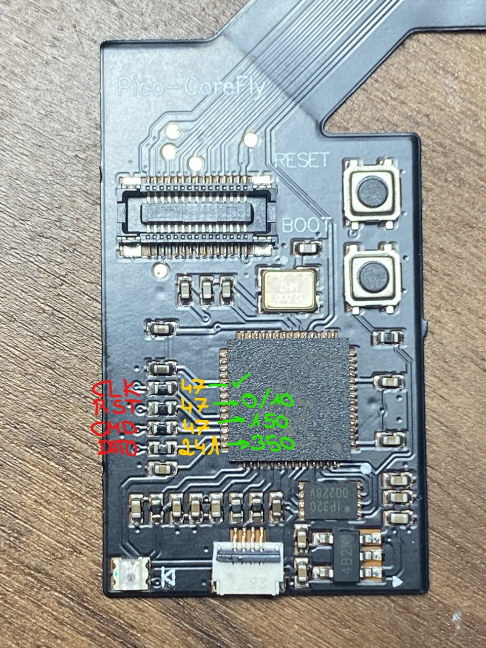

Issue: 1 of 150 units modded (1 unit is an OLED and 1 unit is a common Switch) doesn't turn on OFW from Hekate (stuck in the middle between the first and the second logo, sometimes stuck on the second logo too, some times black screen after second logo...)
Recommendation from the forum: As well said by all of you there're differents brand of CPU and RAM that require Change/swap resistance.
Evidences: I'm curious about that, because i'm getting those measured values (YELLOW) and what I see you recommend using HWFLY OR WHATEVER (not a dev board) = in green.
The following image is pico-corefly for a Normal Switch.
Are those values in GREEN the good ones my lords?
Will this green values work for every CPU/RAM combination?
Will this green values work too for a OLED?
This can be solved just updating the firmware RP2040 with the last Rehius version 2.79 ????
Thanks in advance

I believe the 1st 47 ohm from top is RST not CLK.
So you should remove/replace rst 47 ohm with 0 ohm or blob of solder
Thanks in advance
No, the recommended values are
100ohm on dat0
100ohm on cmd
47ohm on clk
And like the guy above said, you have mixed up clk and rst placement on your picture. It’s the other way around.
Just exchange them on the chip with the correct resistors , really easy.
100ohm on dat0
100ohm on cmd
47ohm on clk
Ok, so wrapping up, for NS V1/V2, OLED or Lite the common working values for all CPU/RAM/NAND combinations is A or B, or it dpends if it's V1/V2 o OLED, or just when try when Read values not working?
B is the recommended values and the one to use, tried and tested since the beginning by the people here and as the picofly guide will tell you.
And i dont know why you keep on insisting with other values?
