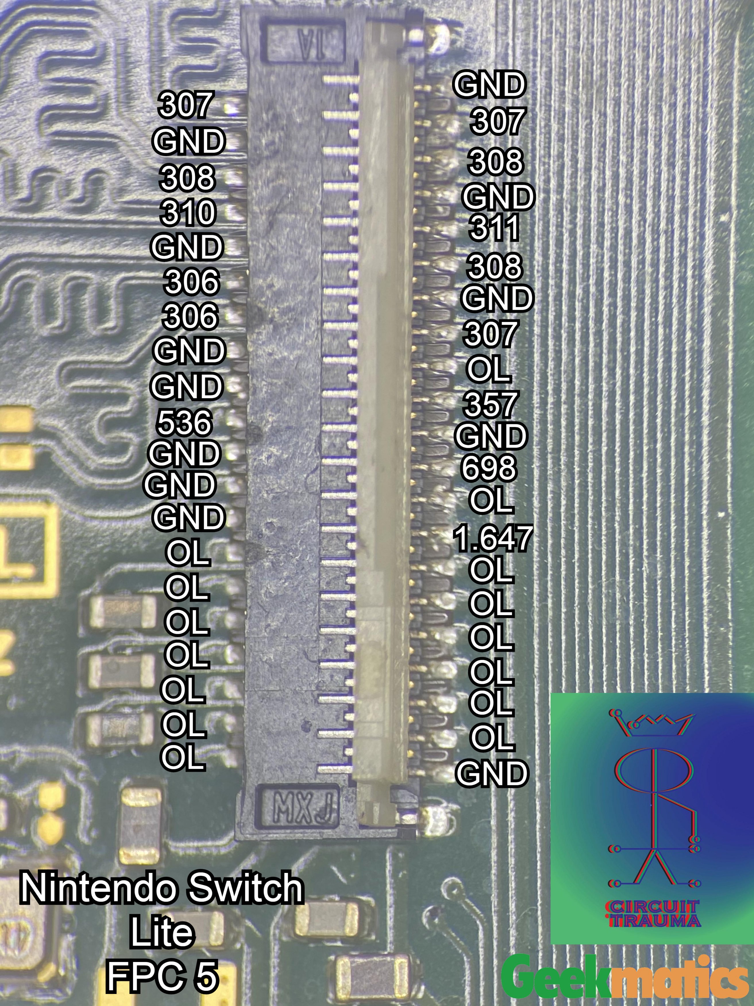

Hello! I'm researching the switch lite's LCD panel. At this moment my goal is to connect it to a generic MIPI -> HDMI board, so now I'm stuck because I need to solder an adapter because the connector is proprietary and there is very little info about it. Does anybody know anything, or maybe can help me with reverse engineering?
Thank you in advance for your answers! I look forward to any ideas or corrections.
What I found:
  • It uses a proprietary 41-pin FPC (pic)
  • It is a 4-Lane MIPI
  • The full list of boards (according to hekate sources) is:
    * [20] 94 [10]: InnoLux 2J055IA-27A (Rev B1) (6203B001P4000) * [20] 95 [10]: InnoLux 2J055IA-27A (Rev XX) [UNCONFIRMED MODEL+REV]

Board views are already out in the open :
https://usoldering.com/switch-lite/
Another approach to look into would be to retrofit the PI3USB chip that generates the DP over USB signal and then use a USB -> HDMI adapter. Not sure if the firmware would support it.

It seems unlikely that they used a modified version of MIPI. It's rather unpractical because provides no benefits whatsoever. Proprietary connectors on the other hand are a commonplace because they are not standardized
Retrofitting pi3usb seems way harder and requires much more elaborate modifications than making a middleman board. Aside from that, it would require soldering (Even though support for a proper docked mode would require it too, but to a lesser degree I guess)

I guess it should be possible to analyze it with a multimeter. Using some knowledge about the protocol you should be able to figure out the pin function knowing its voltage and when it's active.
