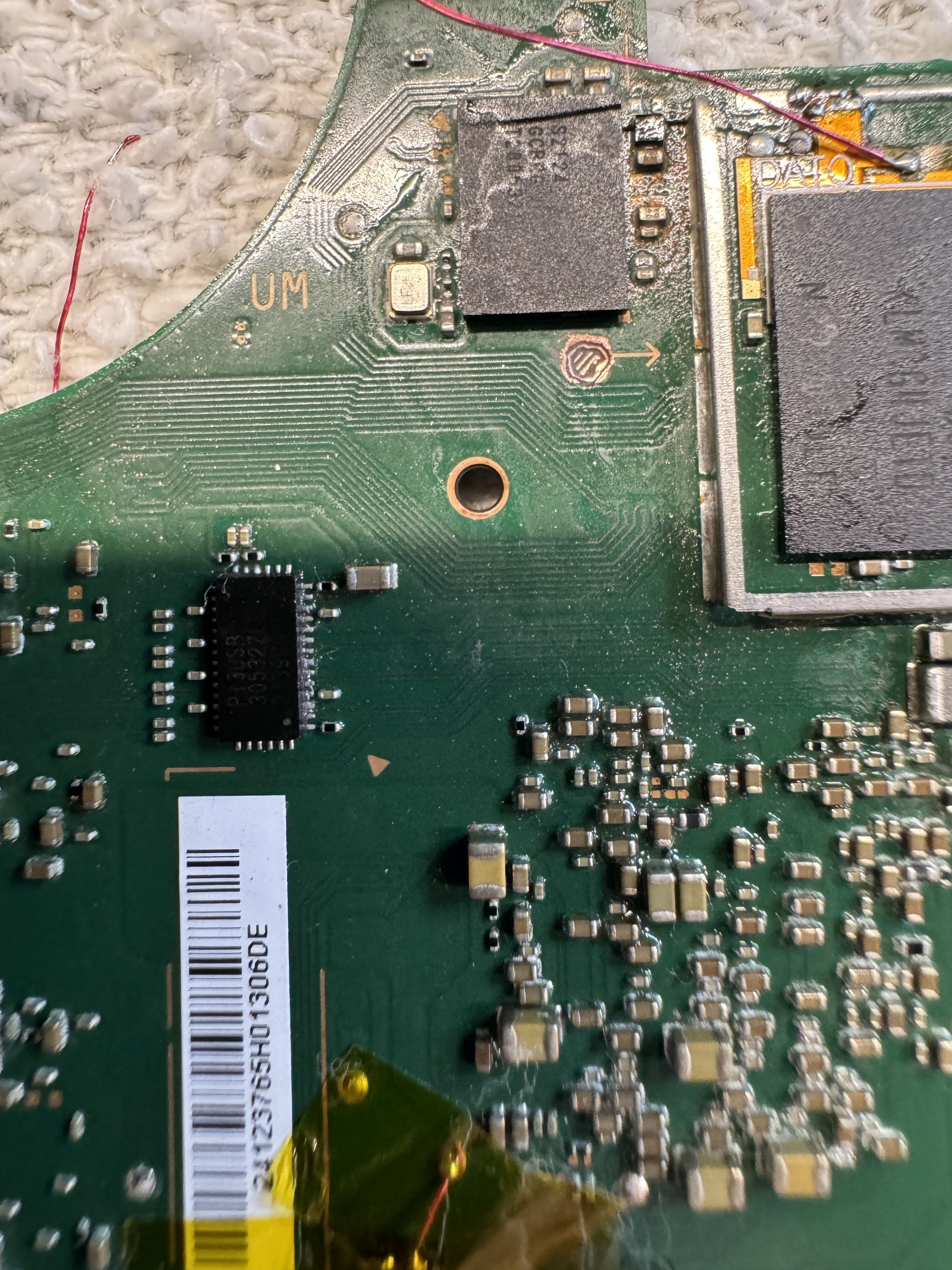

dat2, if I remember correctly
That so funny i use that point to dat0 on chip that coz not glitch and mosfet burn and porple secreen the console working oh gosh so Speed unblog battery. Thank you ma man... 👏

Heeeeeeey you and me both now haha
We both underestimated the method and got cocky. I've read it's super difficult to repair so I'd take it as a learning experience for next time and me personally, I think I'm sticking to the back side dat0 kamikaze. Let's say, 1 down and never again. My best kamikaze took me an hour but it was clean. Will aim for that sort of level of care next time.
I didn’t even know there was a back side dat0 kamakazi. Where is it at?
I'm sorry to read this, unfortunately it's always a lottery after all. if you have a black screen you probably interrupted the track. even if the tester continues to give you the correct value, if you don't fix the track it won't start
Yeah I kept getting the correct value so I must have just pissed something off unfortunately. Will take it as a learning experience. I have two donor oled boards I’m going to practice on before I do another for real
Reactions: Takezo-San
Reactions: BlueBeans
By track, are you referring to the Dat0 track!? Or some other track?

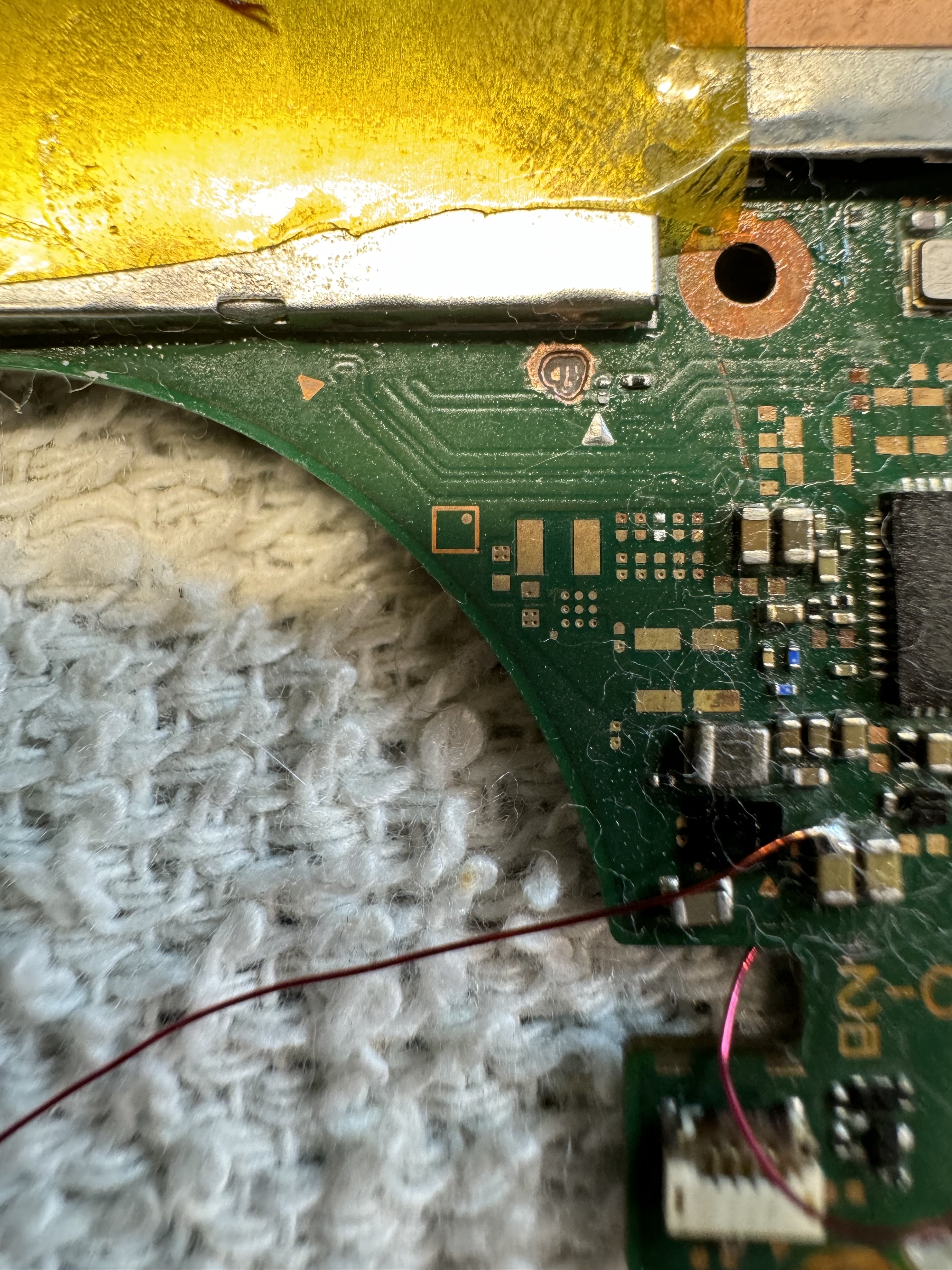

After reading a bit of the forum threads, I saw you recommended someone redoing the track at the eMMC. I followed a video where a guy cutted it. Here's the link:
About the blinks, it was 2 quick yellow blinks 3x (thrice) so I got confused. Sorry for the confusion.
EDIT: I redid the track and resoldered the RST point. Now it gives me a long yellow blink and a fast one.

Alright. Got a little practice in on a dead board. Getting a better feel for it.
Why are you guy calling it dead. Just retrace it man. It just take you about 2' to retrace it with a little wire. You are wasting your money friend. And the front side a more easier than the backside. If you made mistake at the front you are likely double the chance of ruin it at the backside. I just do the backside when i fix customer board which they ruin the front side already.
