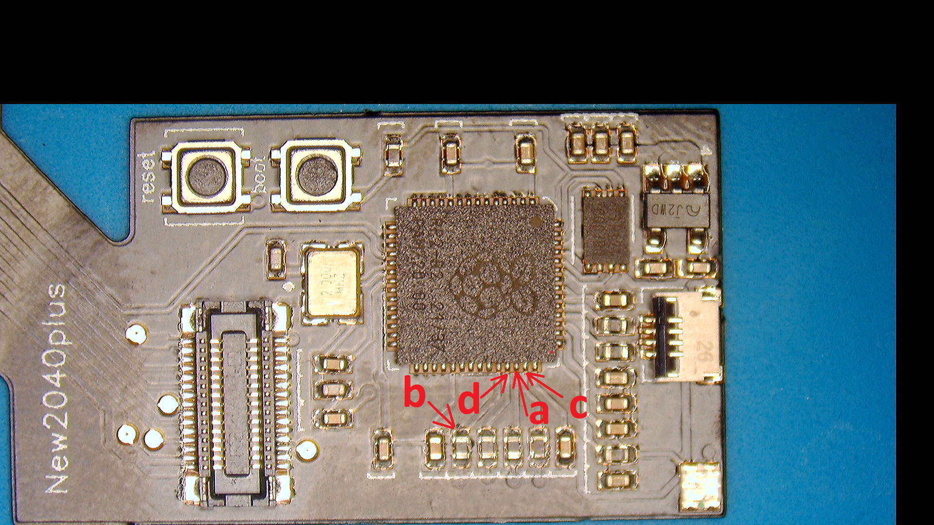

Hi,
Ive modded a ton of v1/v2, but here i have an unit that does not want to glitch...
It goes white, then blue blinks for 2 minutes, then white again and then blue blinking again...
It never glitches, i've replaced the flex and the modchip... Not better...
Do you have any idea ?
Both are 2.73 firmware

I tried 3 core chips with same result. In fact it does glitch but it takes 2-3 minutes...
I could ran wires but on the core model, there is no indication for the points A B C D and 3v3...
https://ibb.co/dKt5j8M
From your picture. From the left side of the cpu. From bottom to top,the 1st one is 3.3v, 2nd is d0 , 3rd is cmd , 4th is clk , 5th is rst.
The c/dat0 point resistor is 240. Change it to 50 ohms and if it doesnt work change it to 100 ohms. This is the main reason of the problems with these chips on certain consoles.
Also if it doesnt work remove b point resistor and bridge the points
I had same hwfly type rp2040 modchip came in last week, it does everything except boots to OFW.
I tried 100ohm up to 400 ohm on dat0 same issue. Maybe the B/rst 47ohm was the real deal
I had a v2 and it was the first time after many modded consoles that it refused to boot on ofw with any combination i tried on all points (dat0, cmd and clk). What fixed the problem was using 50 ohms on dat0. On 100 ohms was same result. Don't remember the exact error code that i got.
