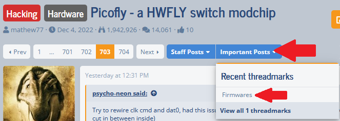

Hi, what do you mean by THIS firmware?
I went to the first post of this thread but couldn't find any attachments?

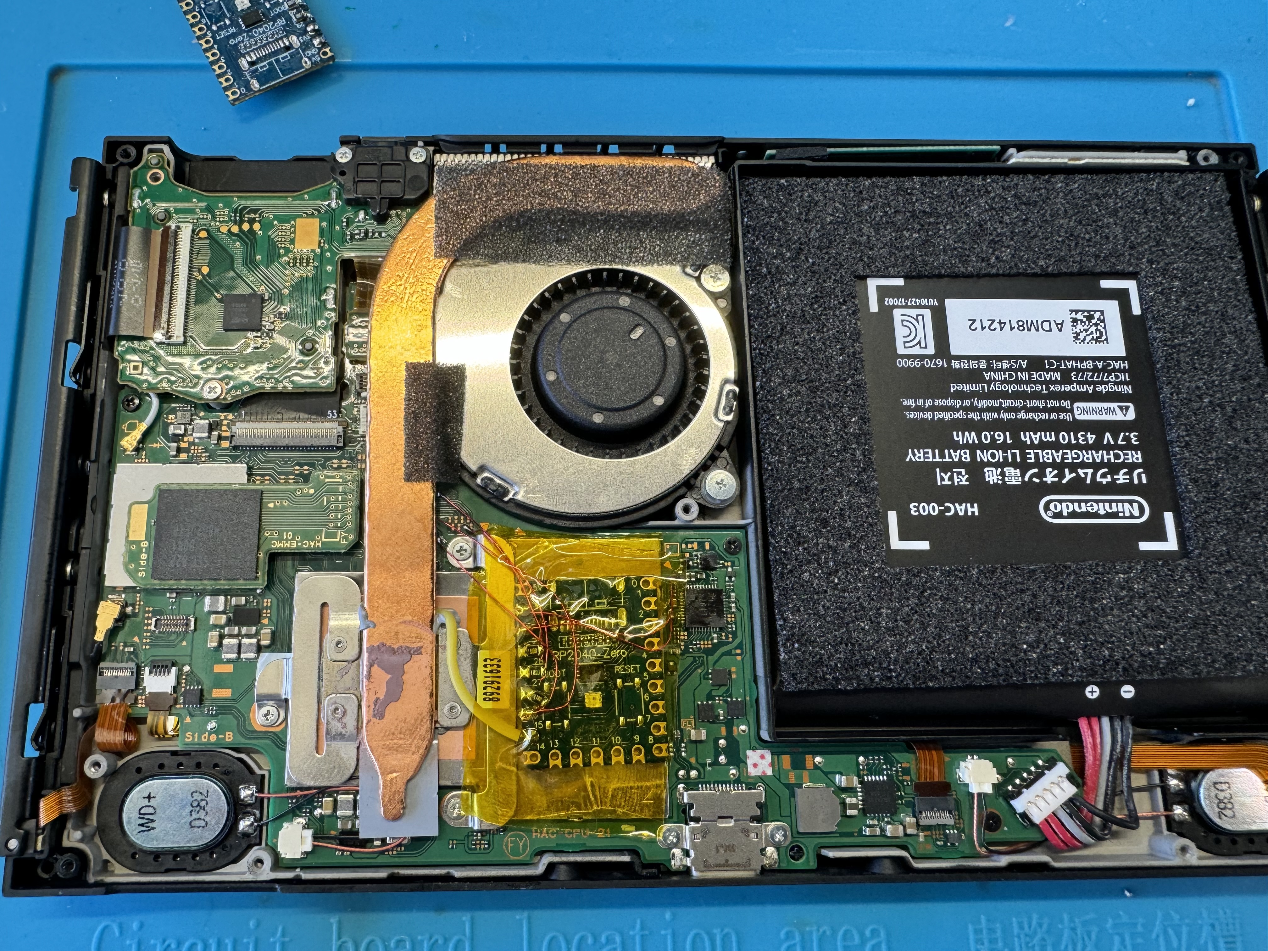

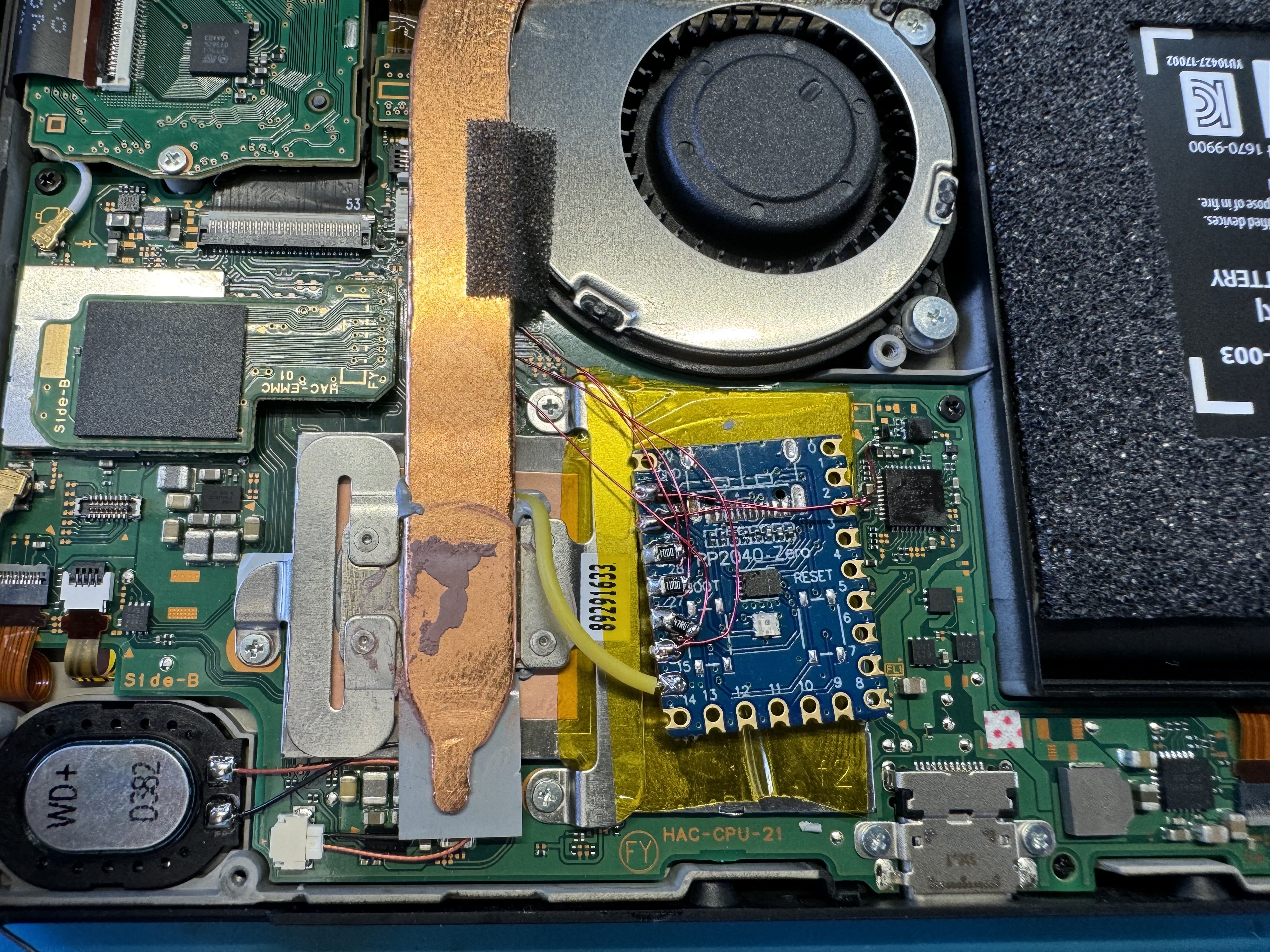

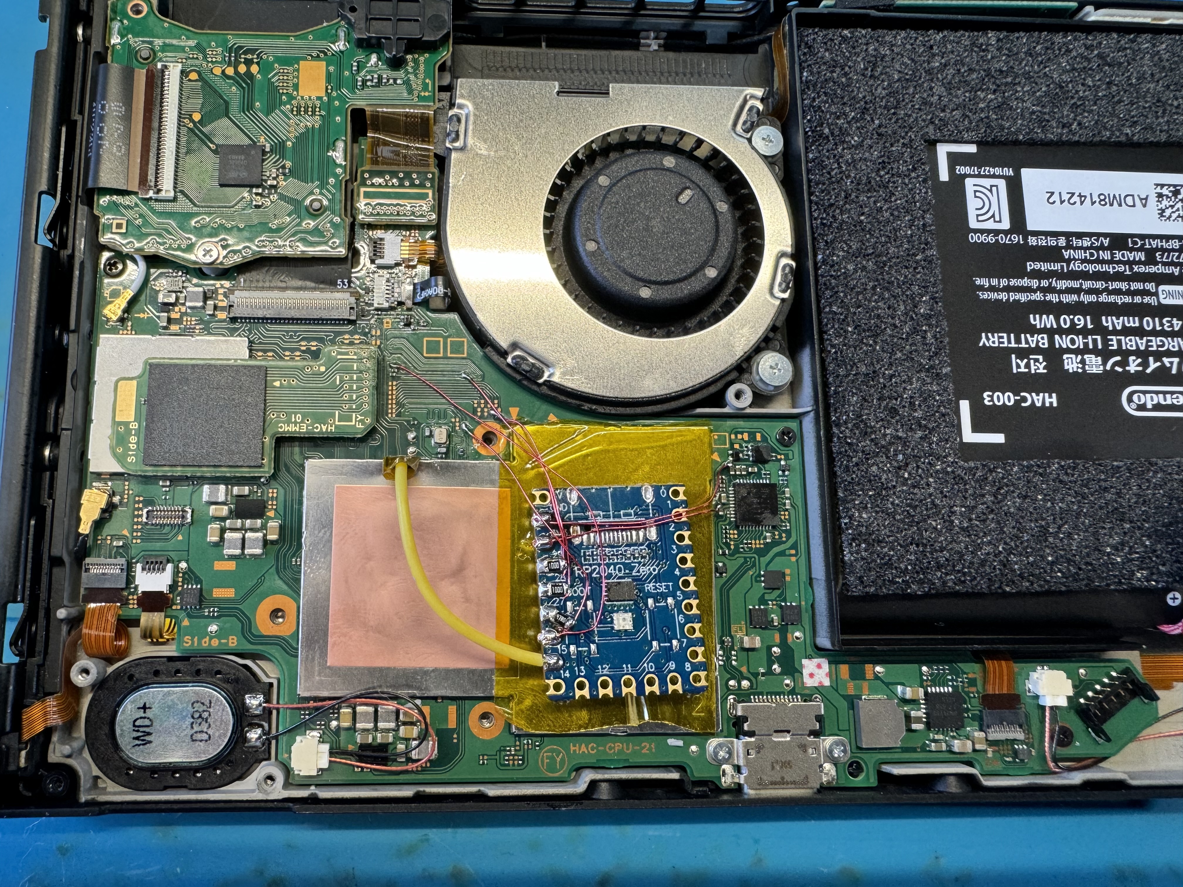

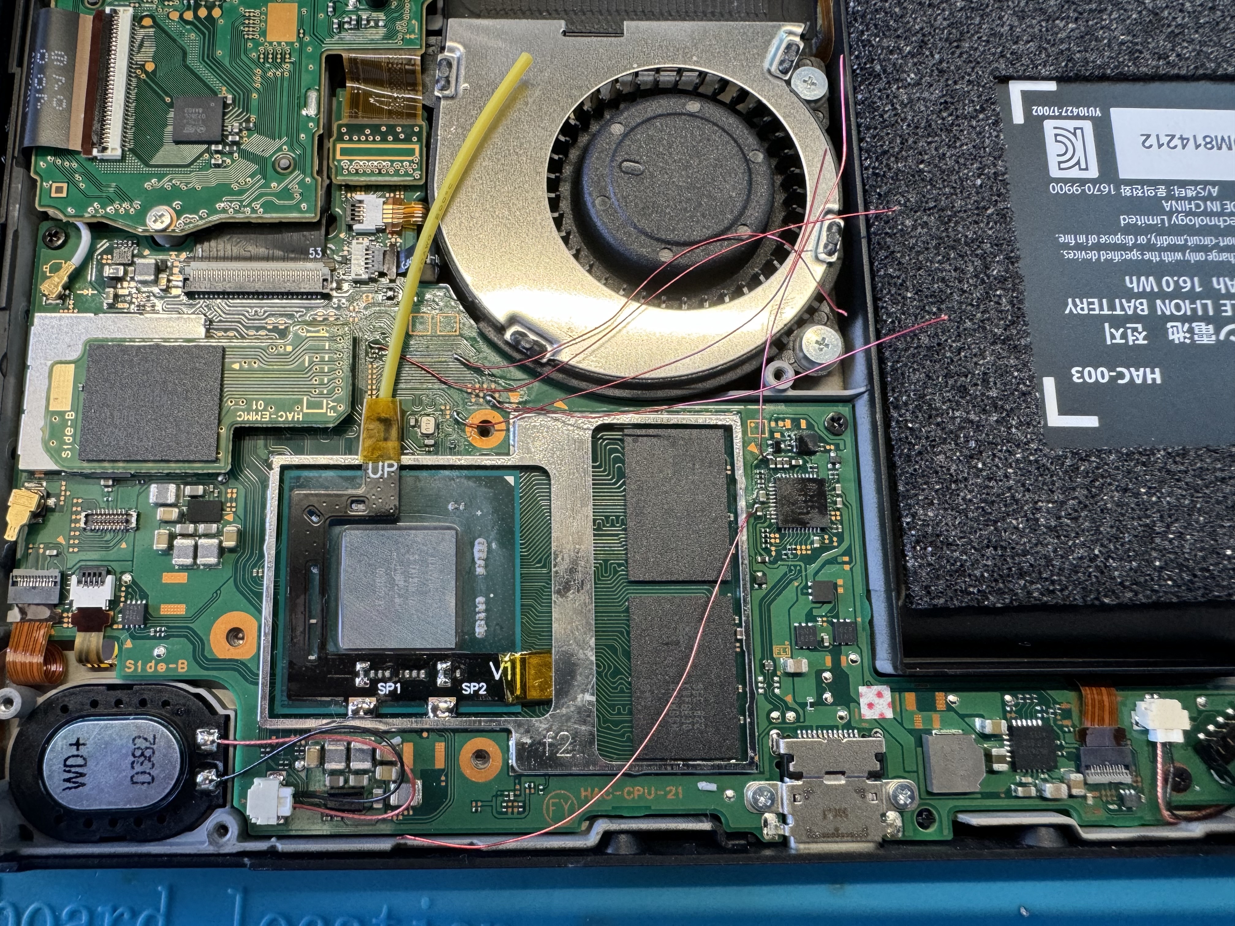

Here’s my install on a V1.
Isn't your CPU line too thick? @.@ I think that heatpipe contact will be an issue. You can use 36AWG for cpu line. It works fine.

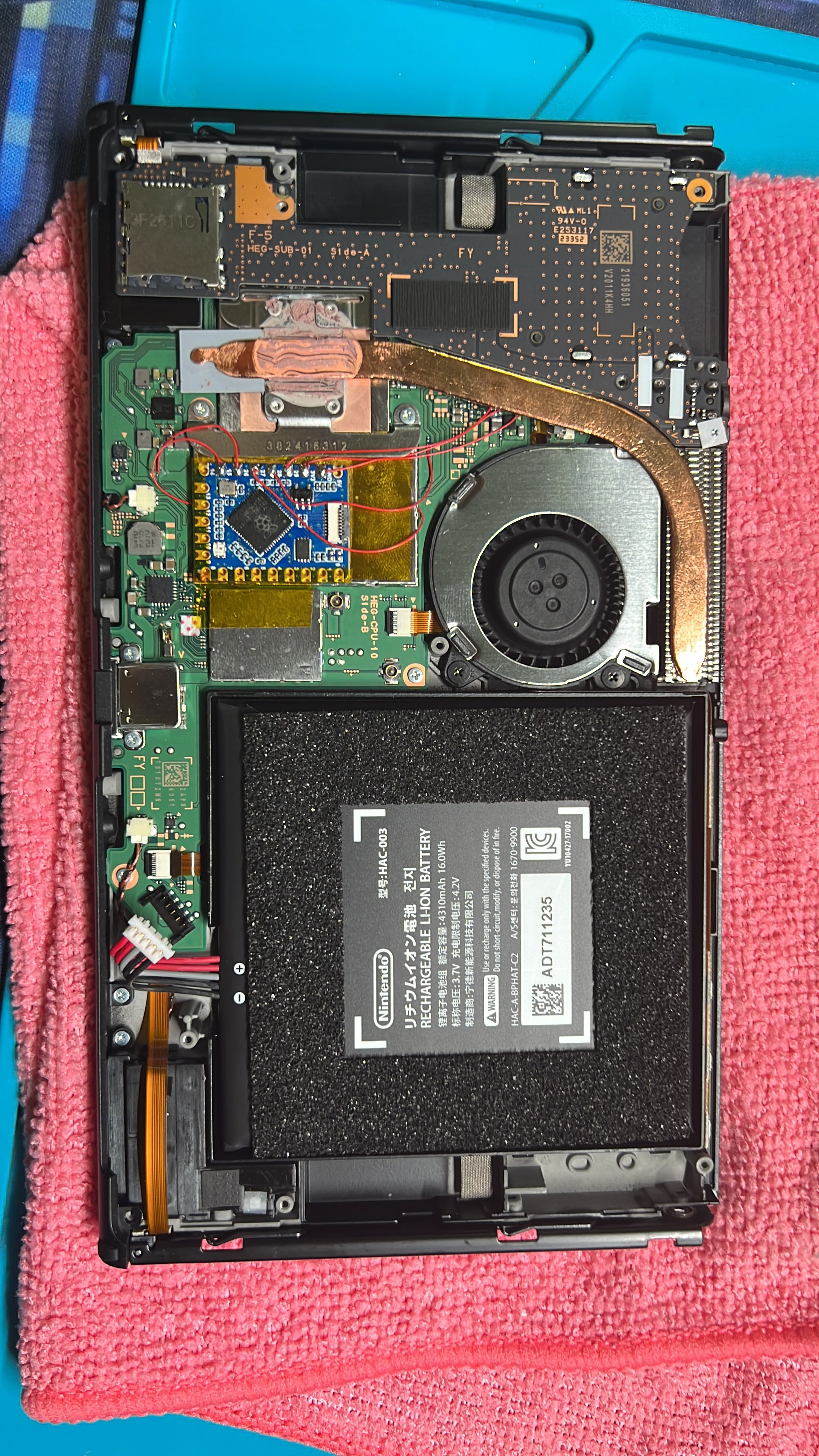

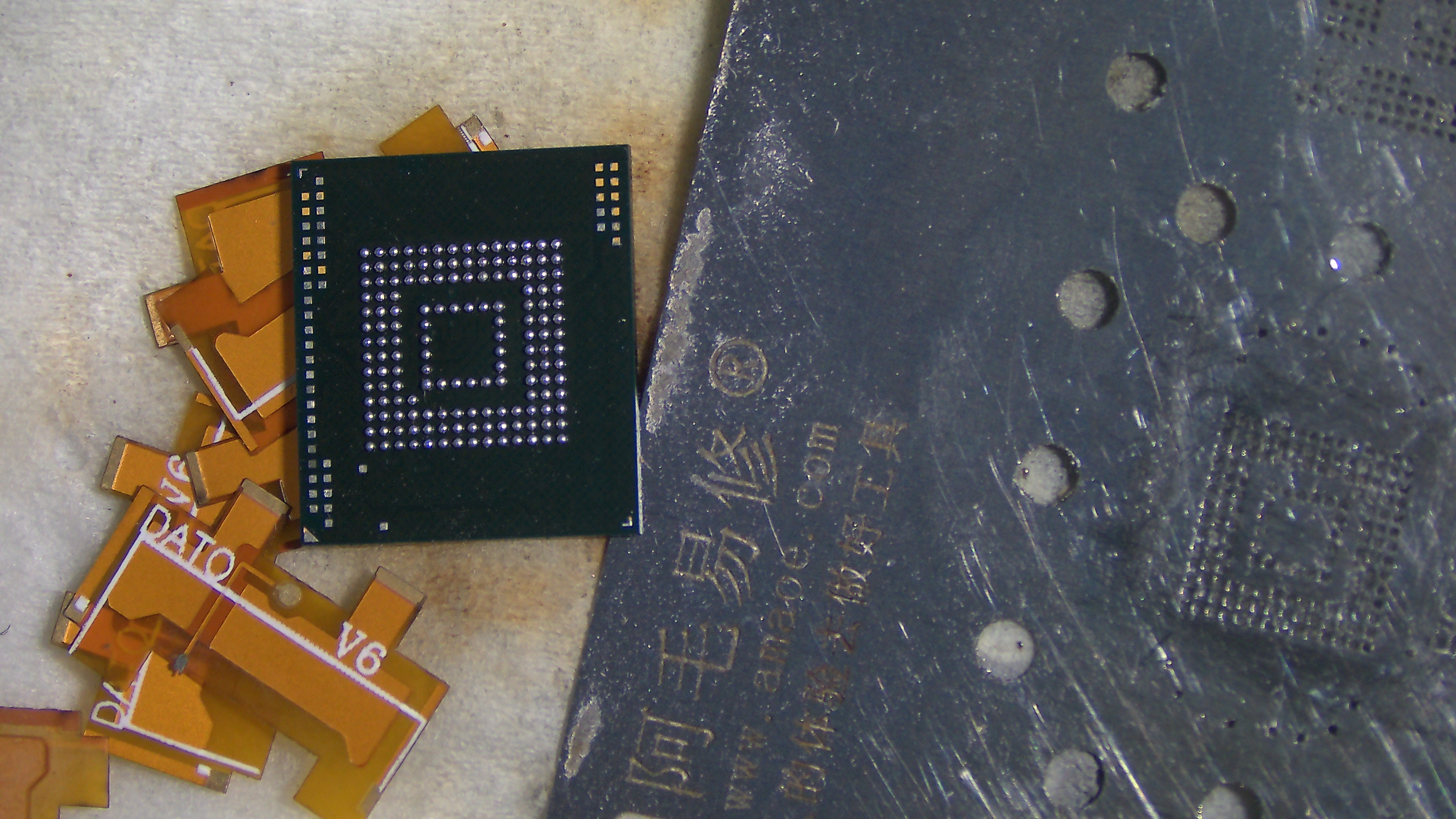

Another OLED done! Got the hang of using the dat0 adapter on how to properly anchor it without resorting to kamikaze method. ❤️View attachment 408268
i have just gotten a bad batch of dat0 adapter now. these chinese seller are tricky one. first i bought 15 they shipped me the good one this time i bought 50 and i got this shitty ones. i will rely on reballing waiting for another batch.
Post your work. I have a v1 here I need to do and I’ll post my work as well. Are you using a flex cable or mosfets?
