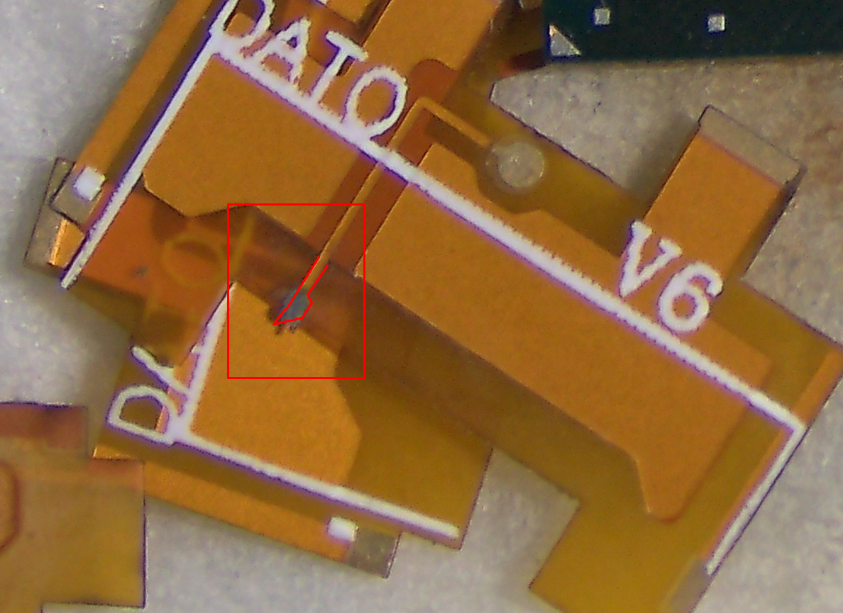

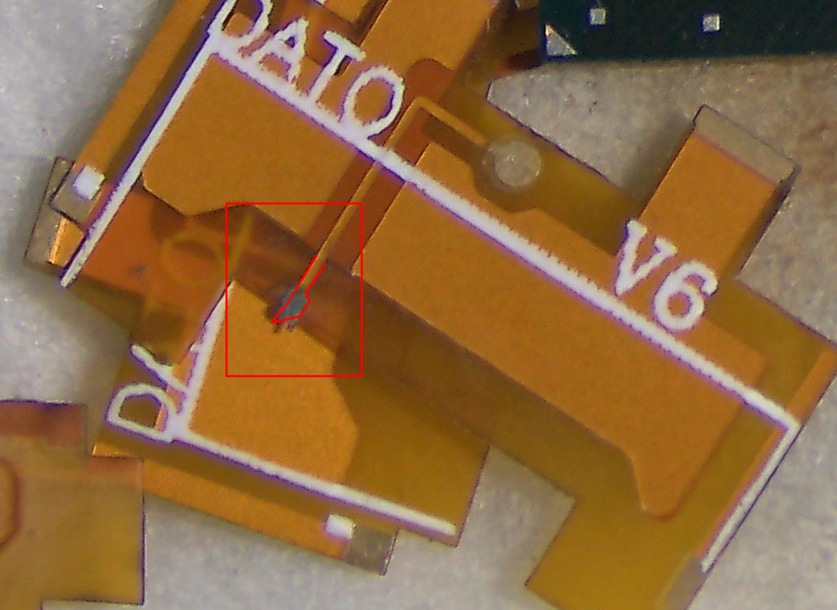

i have just gotten a bad batch of dat0 adapter now. these chinese seller are tricky one. first i bought 15 they shipped me the good one this time i bought 50 and i got this shitty ones. i will rely on reballing waiting for another batch.

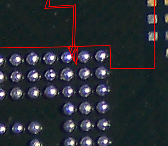

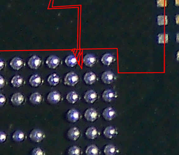

I got a better result when I cut the contact point into triangular shape like in the photo shown. I don't have to worry about the left solder ball as it is not connected anywhere and can be bridge.
never got loose even once even after stress testing also. You can try. :)

These look good to me no need to modify anything. I've long tested these adapters and they were never the problem whenever an issue appears. For me it was always the flux causing problems so I stopped using it near the chip and I never had complains ever since.

I can agree about the flux, I recently stopped using nearby the chip as well.
Unfortunately for the dat0 adapter I had with me were all poorly made, an old design with ring/c shape cut instead of U cut. So I had to trim it off.

i will try it on another oled. i don't want to waste this batch either. thank you

Good luck! I have plenty of crappy adapters as well, and experimented many of it til I got the perfect fitting.
Kamikaze on the other hand is the thing I don't wanna risk. I tried once, almost cut a line. So maybe, never again for now. 😅

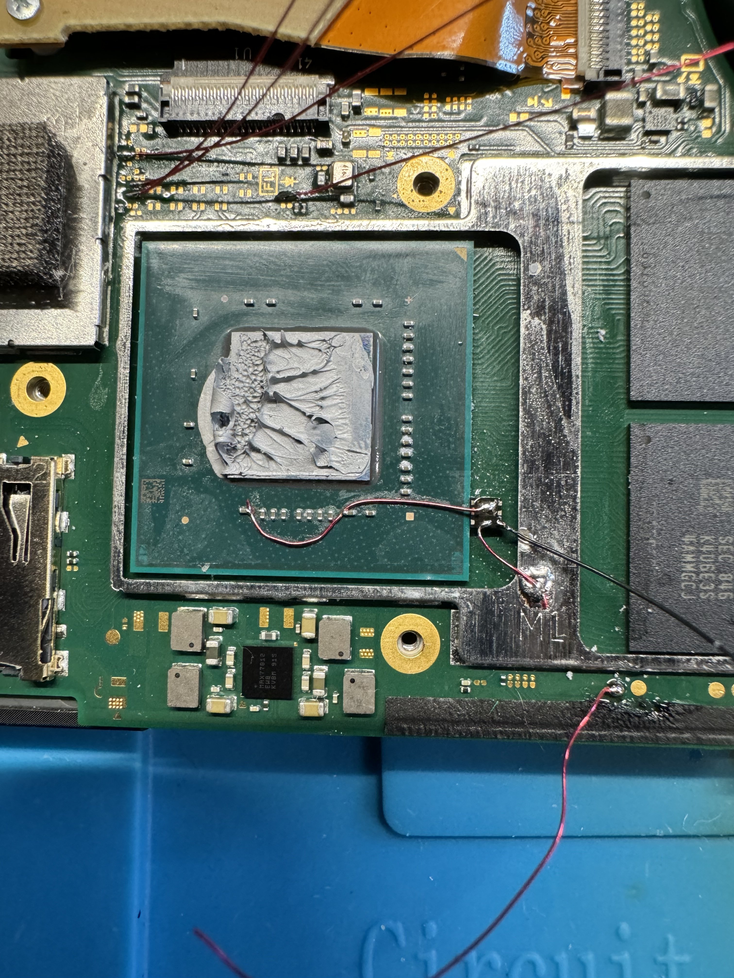

Trying the single mosfet again. Is this how it is supposed to look? When I put it all together my error code was ==*. Drain and Source are grounded but not touching. Is that right?
This is the wire I’m using
drain should have been around 8-14 ohm. change your mosfet
Drain has 14ohm

Wierd. Your error code indicates a failure mosfet but you have a good reading. Maybe check it for a few time to rule out if it is stable or not.
What do you mean? Like turn it on and off checking the error code? I can get two to work with the mosfets I have but never 1. Could the wiring be too thin?
