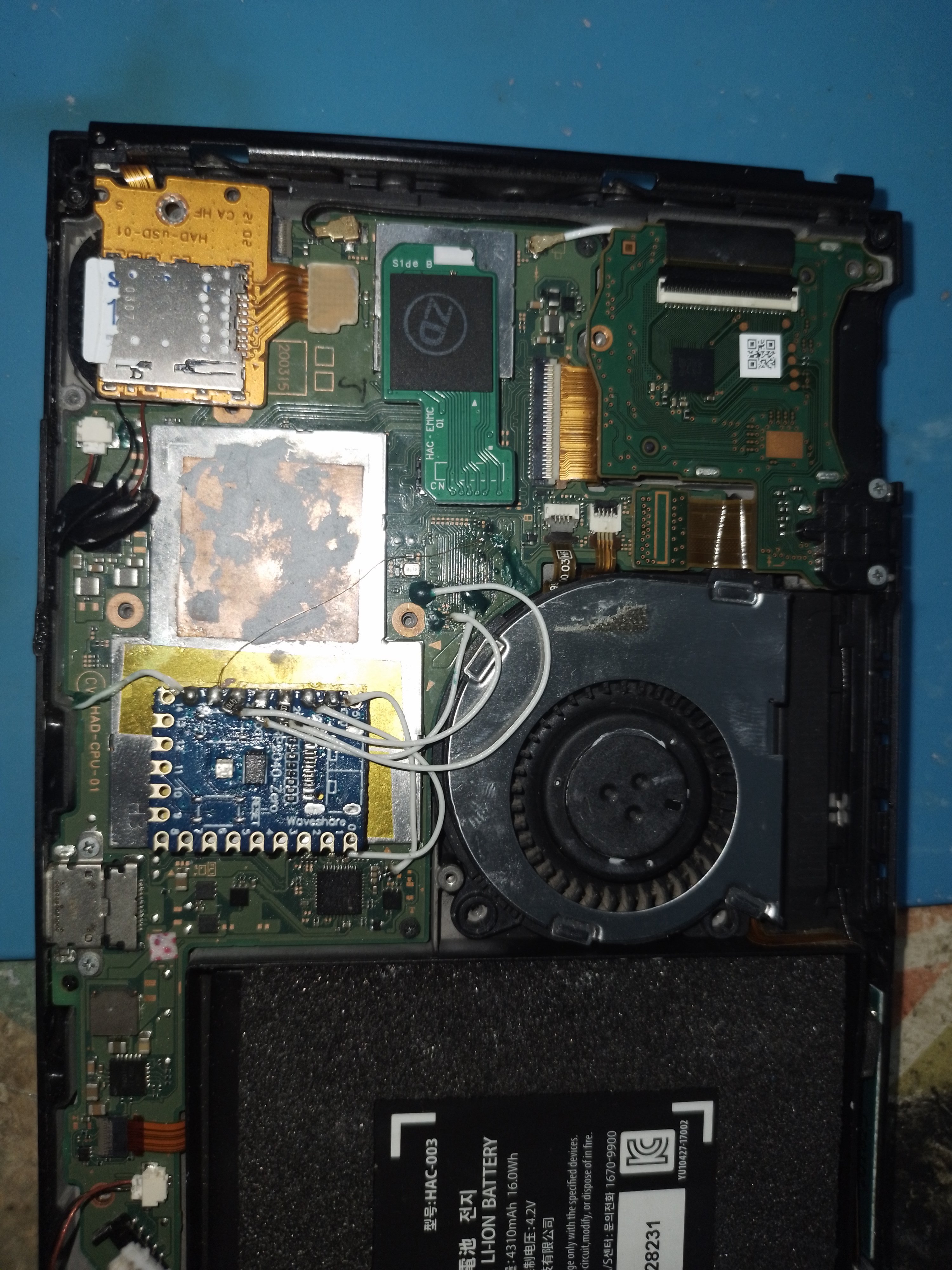

hello friends. my switch's emmc is in slow mode so i odered a fresh one to replace it. i have backed up all the nand already. I have watched a lot vids on youtube but they always say enter hekate and restore it, but i don't know how to enter hekate with the new one.

Should try extra 47ohm resistor on dat0 and CMD instead of replacing EMMC.
it was just a general question :) dont know what is happening with your emmc
after reballing it runs well. but i benchmarked it and the result was 258m so i'm thinking to replace it. And i'm having a dead switch showing nintendo then black out. so i wanna test that switch with fresh emmc as well. i bought 2 of them.
i think your emmc is fine, this should be normal speed
maybe, but when i reballed it there was a missing funtion vial. i don't know how but the ball still sticking to it after reballing and funtion as well. but i'm scared that will cause problem in the future when i sold it to customer. so better make it stable before i sell it that is what i'm thinking now.
Reactions: Motordriver122
since ur having issue with slow mode eather take a 100ohm reisitor and replace it with 47ohm on dat0 and cmd or add a nother 47 ohm resistor then u wont have slow emmc read anymore.
