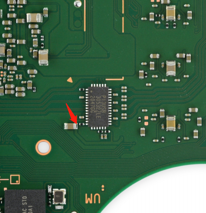

There is about 2mm you could cut off from rp2040-tiny right pin0~pin8 and you could have the 3.3v sourced from big cap next to pi3usb.
