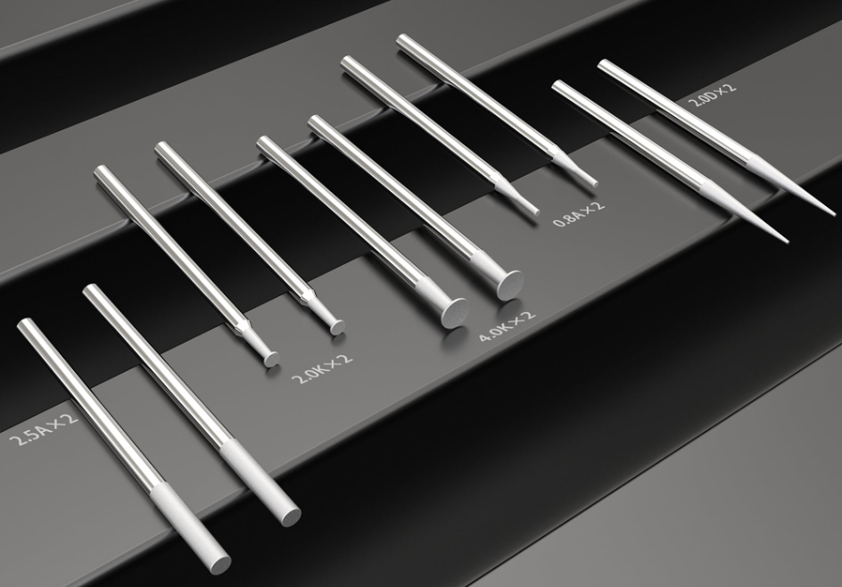

No matter about time. Im a hobbyst and i have a seven months children.
which of these tools do you use for drilling?
