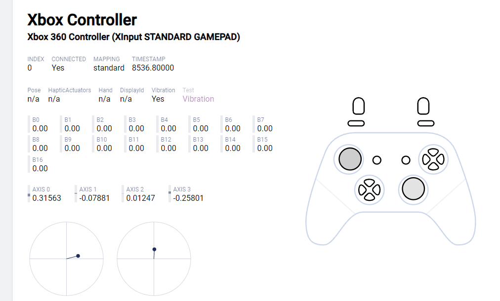

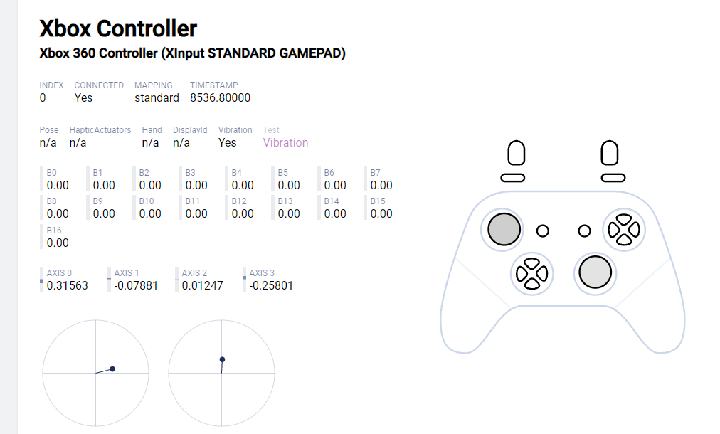

Hello, I replaced my joystick with the set from Gulikit for my Switch lite and calibrated them on the main OS. However, when I boot into Switchroot, both stick are still not calibrated and have default offset (please see the attached image for more details)
I'm wondering if there is anything I can do to calibrate them on Switchroot. I have tried to use program like Tincore but to no avail.
I'm currently using Switchroot Android 11 on Switch lite.
Any suggestion is much appreciated. Thank you!

Thank you for your reply. Unfortunately, it seems that this issue sterm from the fact that the joystick also offset in hakete and result in the switch.cal dump file retains the offset.
I have tried using the nyx file from ctear but to no avail (https://github.com/CTCaer/hekate/issues/890)
I'm currently looking in calibrate the joystick in hakete (or the switch.cal file) and will update the thread with any solution I come across.
Thank you!

Sorry for late reply. Good to hear that you got it to work in the end.
To clarify some confusion for you and any one come across this post later:
1. The Center value is the value show in the online tracker when leave both joystick in the default position (center): Most of the tracker online will be:
AXIS 0 = Left X = Left Center Left - Right
AXIS 1 = Left Y = Left Center Down - Up
AXIS 2 = Right X = Right Center Left - Right
AXIS 3 = Right Y = Right Center Down - Up
2. The offset value is when you move the joystick all the way left/right/up/down: Most of the time you don't have to care about this value but in some rare cases when the center is drifted too far, adjust just the center will cause the offset value (yellow dot) not matching the joystick movement
In case this happens to you, adjust the Center value first until the joystick no longer drift, then start adjusting the offset value of the direction that doens't match joystick movement
3. Joystick Calibration in HOS is saved in HOS settings itself, atmosphere and others OS doesn't have access to those data.
