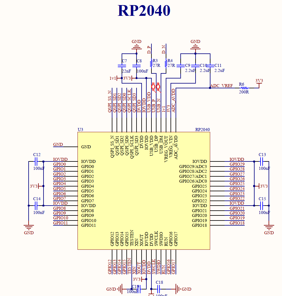

I will check if smaller value capacitor works.
I am using the WS2812b LED from rp2040zero. The one from seeed Xiao seems have different spec. Will check the difference as well.
I am using the cap at the third pin below the rp2040, the led seem not work right, It show green but not blinking, not stable at all. The led on rp2040 also get interference from this second led, it became red. I guess a bigger cap or sth wrong with wiring. About wire and wireless mode still work fine. the video below is some rare case it change from green to blue then turn off. I just wonder if D out of the led place on the other pin of original led could be the problem

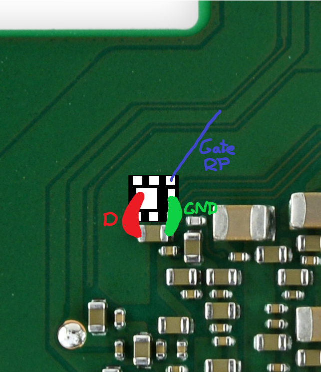

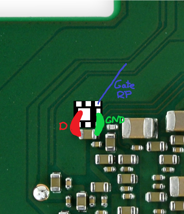

For those of you who like big pads and cannot lie, here's a super easy and perfectly working mosfet position for the OLED with virtually zero risk to surrounding components.
Amazing all the finds making all this easier!

Excited to be trying your back-mosfet method @abal1000x

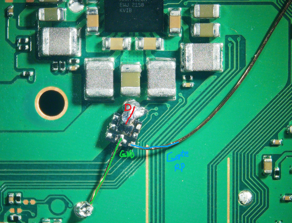

This is my first attempt and it is on a lite. I am getting the mosfet error (==*) and booting into OFW. Maybe there is not enough solder on the mosfet?
I mean it looks like you didn't solder the correct pads? You only soldered the corners.
See:
where exactly is the cap from? most caps near type-c port on rp2040-zero are 2.2uF which I think is too much for this mod.
See:
Those are connected within the mosfet itself. Same points. It's possible that bridging them externally increases how much current can enter the mosfet though.
Yeah add some more solder , that's what worked for me :-)
Flooded them in solder to bridge the points. Still getting the same error.
I ended up just using a CPU flex cable so that this doesn't keep me up all night. Excited to try the back mosfet another time.
Ah I see yeah, makes sense though about them enabling higher current, I think that's what they were mentioning too, to have a good solid blob for current.
