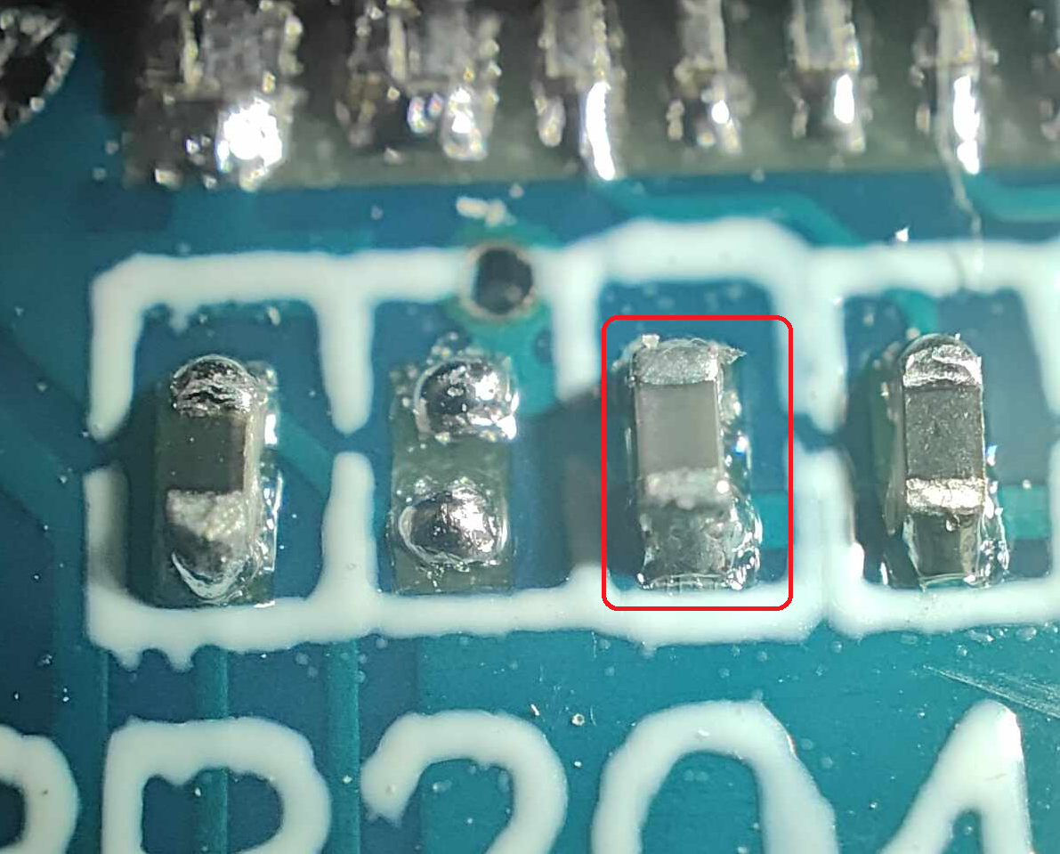

where exactly is the cap from? most caps near type-c port on rp2040-zero are 2.2uF which I think is too much for this mod.
this one, these cap is so tiny

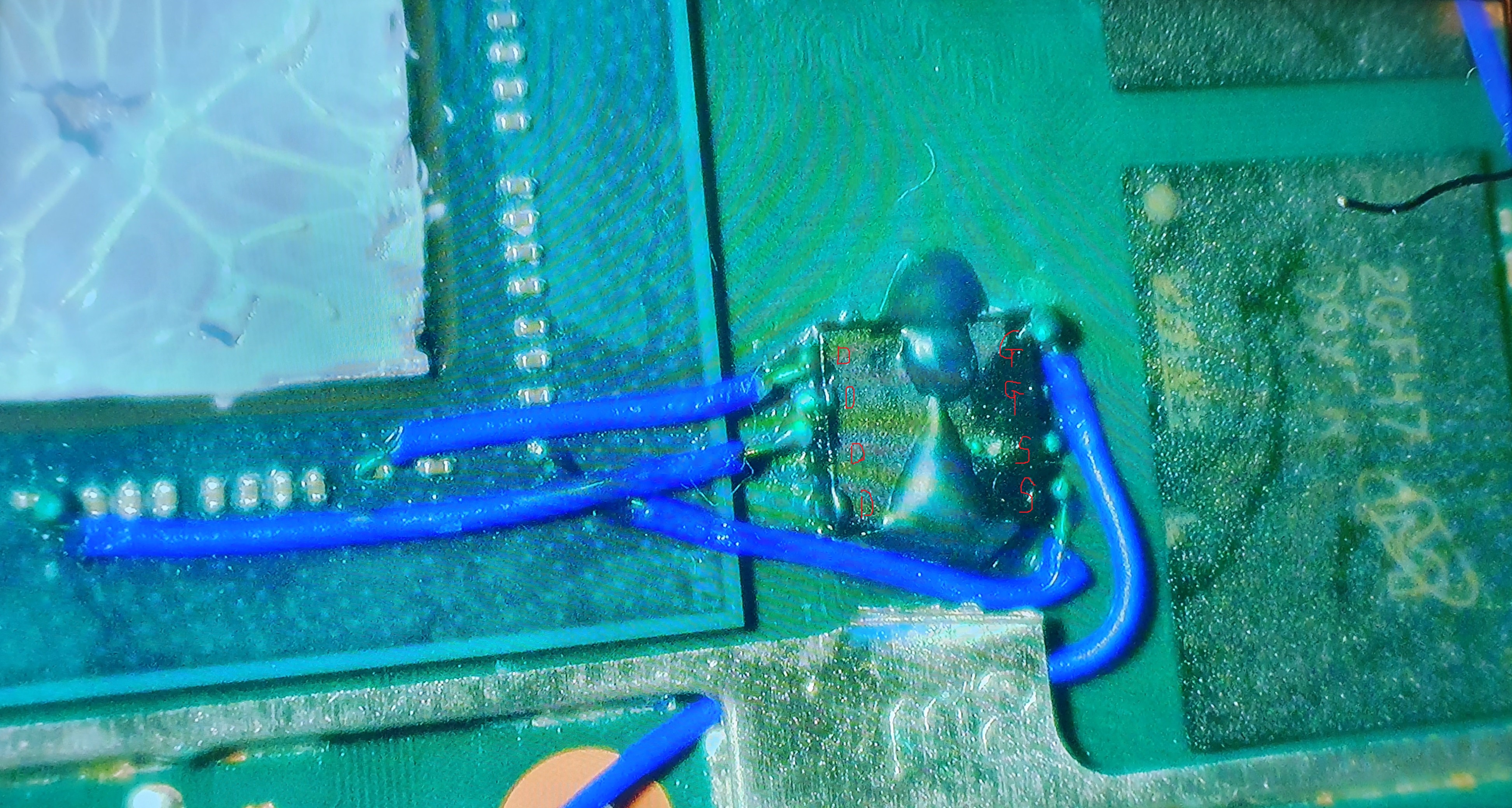

So i tried the aon6554 mosfet on an oled today. Reball was a breeze with the reball jig. But the mosfet didn't work. Had a 1k pull down on it and thought maybe it was the issue. Removed that and nothing. Same issue. Cyan light, cpu line error. cleaned up solder points, checked cap values, all good. Put everything back and still same. Either its probably a dud mosfet or the mosfet is not that great for this mod. Ended up using a spare filthy nasty cpu flex cable....yuck. did it so quick and and the pico glitched so its not my soldering and thank god I have a good run with reballs and oled so far. Looking for a solid mosfet that doesn't need a dual build.
So anyone ever tried that mosfet before?
edit - oh wait, does it matter if its installed face up or face down? Was I being a doofus this whole time? Herers a pic if anyone can spot a mistake i may or may not have made.
(Solder mask blob down the middle was to secure it down and stop it moving around.)
The AON6554 has only one G terminal the other 3 below it are S so as long as you did not bridge the 3 and 4 together you should be OK as far as wiring goes (see picture).
I am assuming that this is the orientation, so 1st pin bottom right (please check since I cannot see the mark on the mosftet from the picture)
Anyway, I think there is something else at play here.
The mosfets that work (tested by me) example IRF8342 has a total gate charge Qg of 4.2; AON7506 Qg 4.3; AON7518 Qg 6.9; IRF8714 Qg 8.1 while the one you are using AON6554 has the Qg of 21.3
@abal1000x what are your thoughts about this?

My concern with the bare mosfet install is that we may be over-loading the output pin from the RP2040 which could cause internal damage to the IC.
General practice is to have a resistor in the gate drive line to limit the current drawn from GPIO.
This article may be informative:
"The initial current is very high. It slows down as the capacitor charges. That initial current rush, also known as in-rush current, can be a problem. Even though it is a short time, there is a significant current surge that can damage an I/O pin."
https://www.baldengineer.com/7-mosfet-myths-and-misconceptions-addressed.html
Although Rehius explained why this should not be an issue in this case, the article you posted was a very good read and the best explanation on some aspects of mosfets that I have read. Didn't know about this website, it has some very nice articles, thank you
Puzzled... I have a bunch of these aon . these are my main arsenal now, probably installed 10 units, single mosfet everytime. Although i never done an oled yet.

Puzzled... I have a bunch of these aon .. probably installed 10 units, single mosfet everytime. Although i never done an oled yet.
Well, that pretty much rules out the Qg theory then since if you got just one working then the problem it's likely a result of other variables.
Let's wait for @Takezo-San comment for the soldering part, or maybe it was just a bad mosfet.

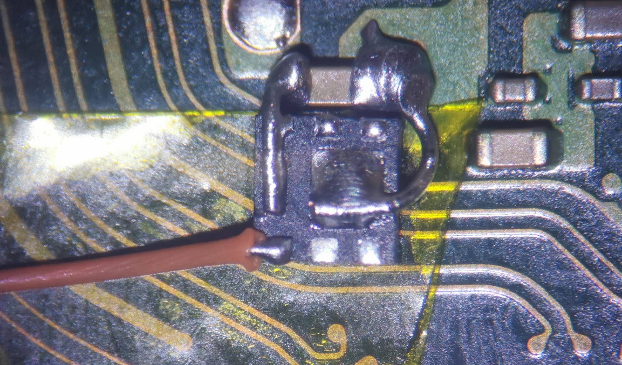

Can you guys please take a look at the video and help me decode what the errors are saying? It looks like a D0 problem, but I’m not entirely sure.
This feels a bit different from a 2.74 firmware instability issue.
It started with being able to glitch after disconnecting the batter for 6 hours. Then I received this 2618 error on atmosphere and I can no longer glitch the switch even after disconnecting the battery for 6 hours. So confused @.@

The error clearly is dat0 not connected =*
Can you check on dat0? Try to redo that one more time. The Atmo error also looks to be related to that.

The previous technician installed the d0 adapter like this (in the picture). When I took it to the new technician, he reconnected everything, but I’m not sure he’s aware the d0 adapter was installed somewhat awkwardly.
Ok, so that is one of the worst dat0 adapters currently available and most likely the source of at least 70% of all Oled problems in this thread.
First, you need to move the wire away from that very sharp edge of the emmc shield since it might scratch the enamel coating of the wire and create a short (see point 1 in picture)
Second, the dat0 adapter seems too far to the right and at this point it might have lost the contact with dat0 point on emmc. That adapter is supposed to a little bit offset to the right but not that much.
You should try to push it a little bit on the directions of arrows (see nr2 in picture) but only by around 0.5mm or so and see if it works.
In any case, you need to change that adapter if you hope to resolve this issue permanently.

Very much appreciate this. I had a creeping feeling this might be the problem, but was trying to cope that it wasn’t 🥲. Is it the black d0 adapter that’s recommended?
