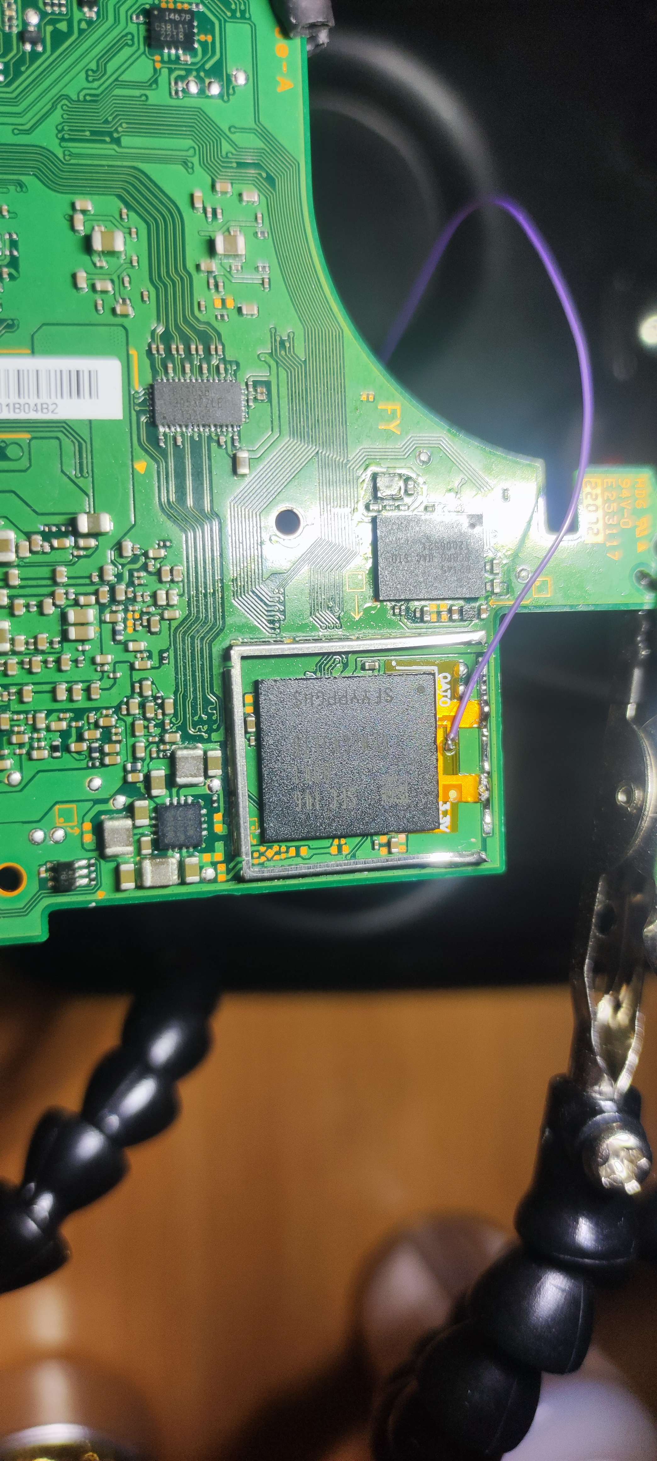

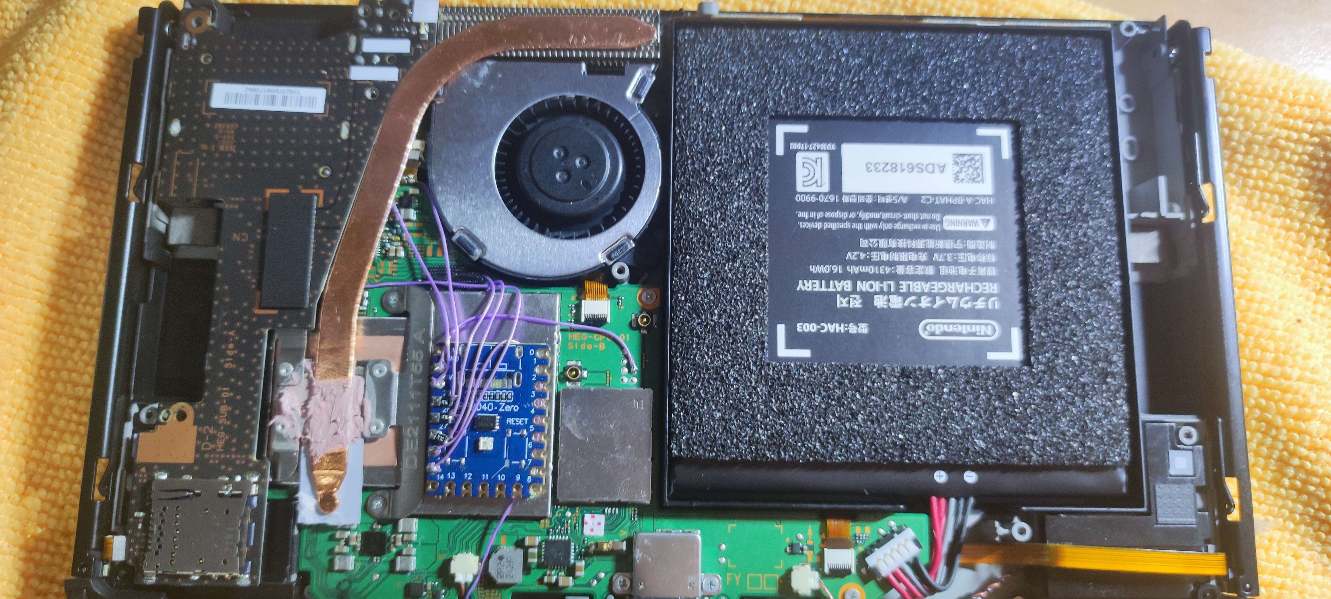

Hi everyone!
I did an install, and at the end the diode values seemed to check out (the CPU pin was a little above 0.900 but my multimeter shows direct probe to probe as anywhere between 20 to 120, so I figured it would be inside the 0.900 range). So picofly works, no sd card screen, all good. After I put in sd card package black screen. Removed sd card, pressed volume+/- to go to OFW, purple screen. Purple screen means I screwed up CMD point. Fixed it.
Now I get a blue screen, so it seems I may have screwed up more than one thing. Everything I found pointed to the APU, so I removed the hwfly flex ribbon, disconnected the pi, still blue screen. I was really careful when installing the flex cable, I knew those caps are heat sensitive so I tried to be as quick as possible, pre-tinned the cable, plenty of flux and everything.
Is it possible I fried one of the two caps and that's the reason for the blue screen? Since the pico manages to glitch shouldn't the caps be fine? I suppose that if there was a problem with those SP1 and SP2 caps the pico would give an error code.
If photos are needed of RST I can post, but since I get to the no sd card screen I'm guessing that shouldn't be the problem. Also don't have photos of the apu with the flex cable since I removed it for testing.
Sorry for the long read, just wanted to explain the problem the best way possible.
Appreciate any help!

Blue Screen could also be corrupted nand - check your clk point looks like its grounded to the ground point. Dat 0 also looks a bit wonky

Since blue screen and I sat ur using one of those cheap Oat0 adapter I would also say something's wrong with u nand
Also check clk with ground seems to be bridged
Thanks for the reply!
Yeah, the clk isn't the best of jobs, but i made sure the jacket covers that ground point and have tested several times against ground, getting around mid 0.800's, my multimeter is a bit wonky, direct probe to probe goes anywhere from 20 to 120, so I think it's in the high 0.700's at the pico.
As for dat0 it's a bit crooked because I followed sthetix video and heard it's better to not short with dat1 in these adapters. And I also got the expected readings from the point.
My question is, woulnd't the pico give a led error code in any of these cases? Or would it reach the no sd card screen all the same. I read that if you short the dat0 to dat1 and then turn off the pico without removing the shorting adapter, HOS will write to emmc and corrupt it due to short, giving a blue screen, and I unkowingly did turn off the pico without removing the dat0, but I was already getting blue screen before that when pressing +\- at the no sd screen. But wouldn't the pico give an error code if those 2 points where shorting?
Sorry for the amount of questions, just trying to understand where the problem might be coming from.

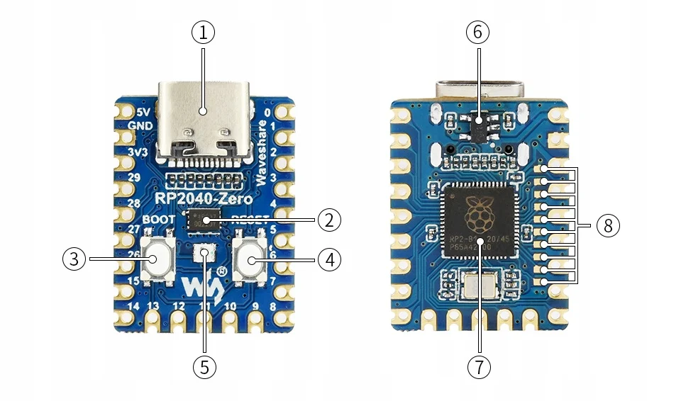

Can anyone confirm for me if number 6 (on the diagram) is the voltage regulator? That isn't really required for this mod and can be removed because @impeeza wrote a while ago 'that regulator is for convert the 5V of the USB to 3.3V and you can get 3.3V directly from console board.' Is it safe to do so?
Thank you in advance.
Yes, you can remove the LDO (Low DropOut Voltage Regulator) after flashing the firmware through USB. Once you remove it though, it becomes more difficult to flash over USB.

Update: Resoldered the flex cable, turned the pi back on. Tried running UMS-Loader as a payload and it ran. Not sure what to make of this. Since it only uses RAM and it works, the problem must be in the APU?
Would appreciate any help, really lost on this one.
ums-loader only uses nvidia's iram so the cpu is okay. i might check the connection between apu and dram the next of it. Theres lot of small trace which might broken because of mod activity.

Thanks so much for the reply! Okay, going to test that! Any specific caps around the IC I should check for shorts?
Thanks for the reply! I haven't messed around too much around there. Could a tiny spec of thermal paste do anything like this? I noticed that when I cleaned the APU with IPA some tiny pieces of thermal paste went under the metal shielding and near the ram chips, I tried cleaning as best as I could, but maybe some tiny spec ended up in the wrong place? In the photo I've attached there can be seen tiny specs of thermal paste between traces. Anyway, I'm going to check those traces right away, thank you!
