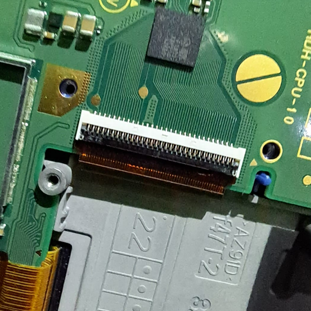

My main enemy for this to be easier is this lcd flex connector, its hard to reattach at least for me.
And for Lite this method of instalation will take more time than the default SOC solder.
For thermal paste i say if the unit is new then just leave it as this will also make the soc header cover still in perfect condition.
In my experience of fpc/ppc, that connector is fragile.
Do not take it off using nail. That is the most common mistakes people do.
I bought cheap spudger for that. Use the appropriate tool was always the answer.
And luckily nintendo use a more rigid one for the lcd connector.

Yup it should be better with specific tool as you can control the force to open it with more precise, and minimizing the change to break the connector mechanism. For reattaching it though its a diifficult process, it takes full consentration :rofl2: or bam.. one of the pins will bent and you know what follow.
Anyone have tips for these reattach process ? as i see that the flex needs to be inserted vetically in the middle of connector, not on the bottom like every other flex on this mainboard.

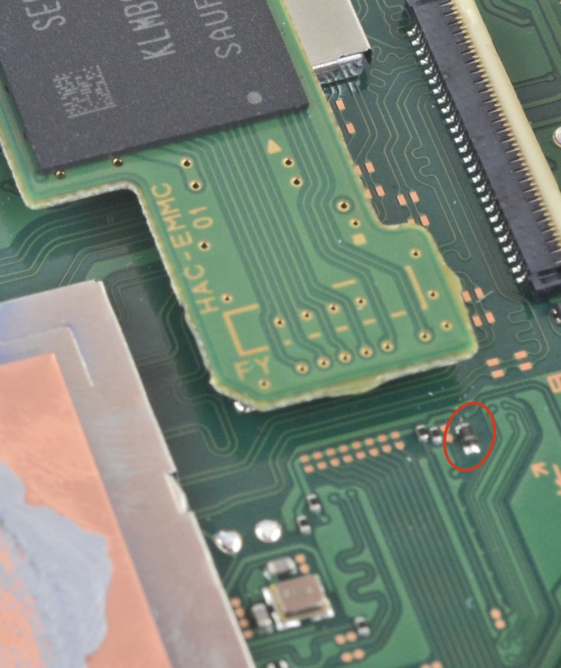

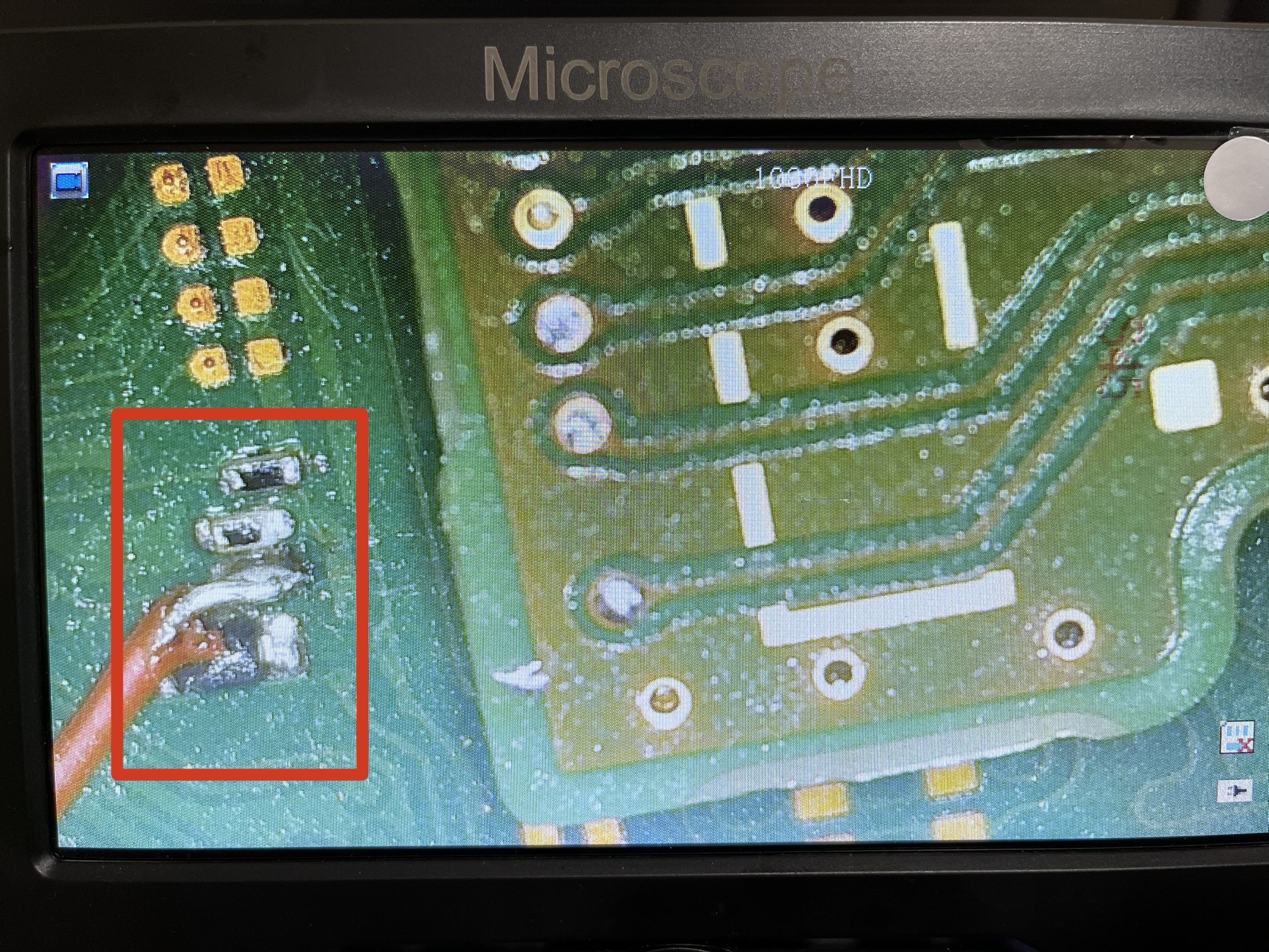

Hi! Somebody could said to me the value / specs of those components (around the RST point).
Hi! The values of resistor are 4,7k, what about the third component ? I am not able to identify it. I am going to order it in AliExpress and I need to know the value because I damaged it. Thanks
