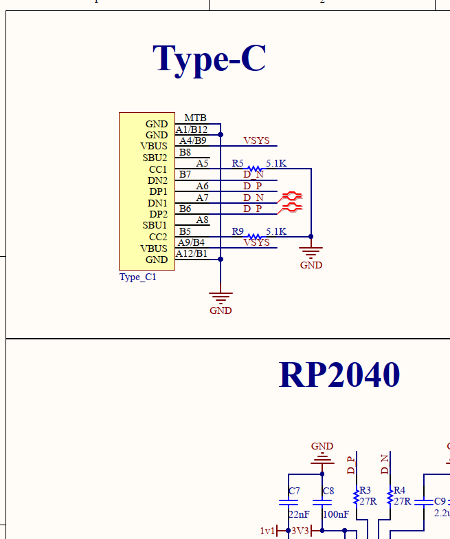

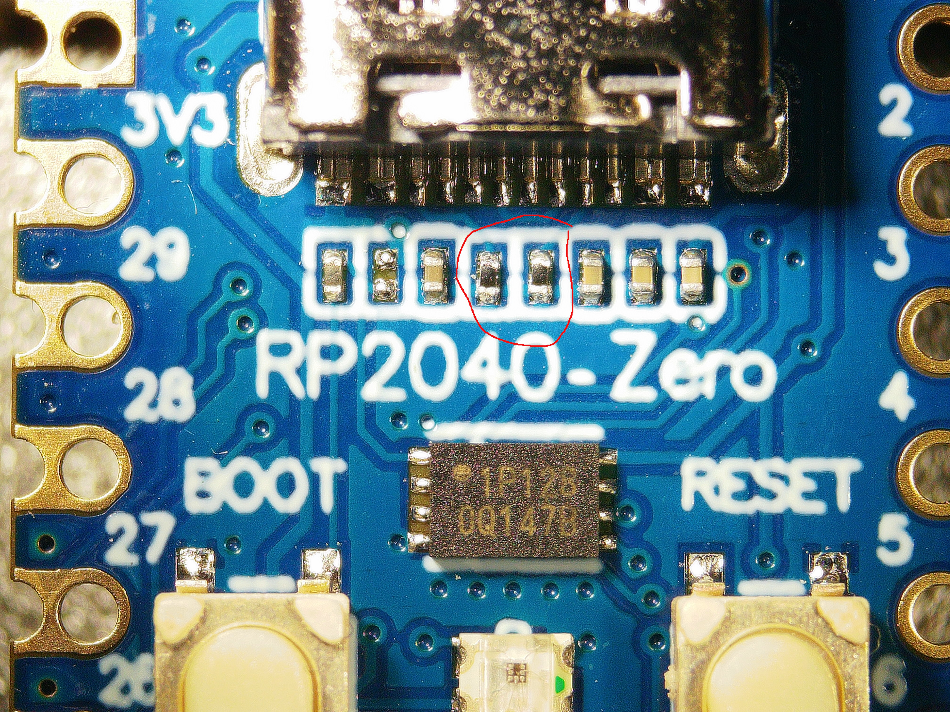

But… if I take the resistors from the rp2040, it will stop working? Or it doesn’t need it?
