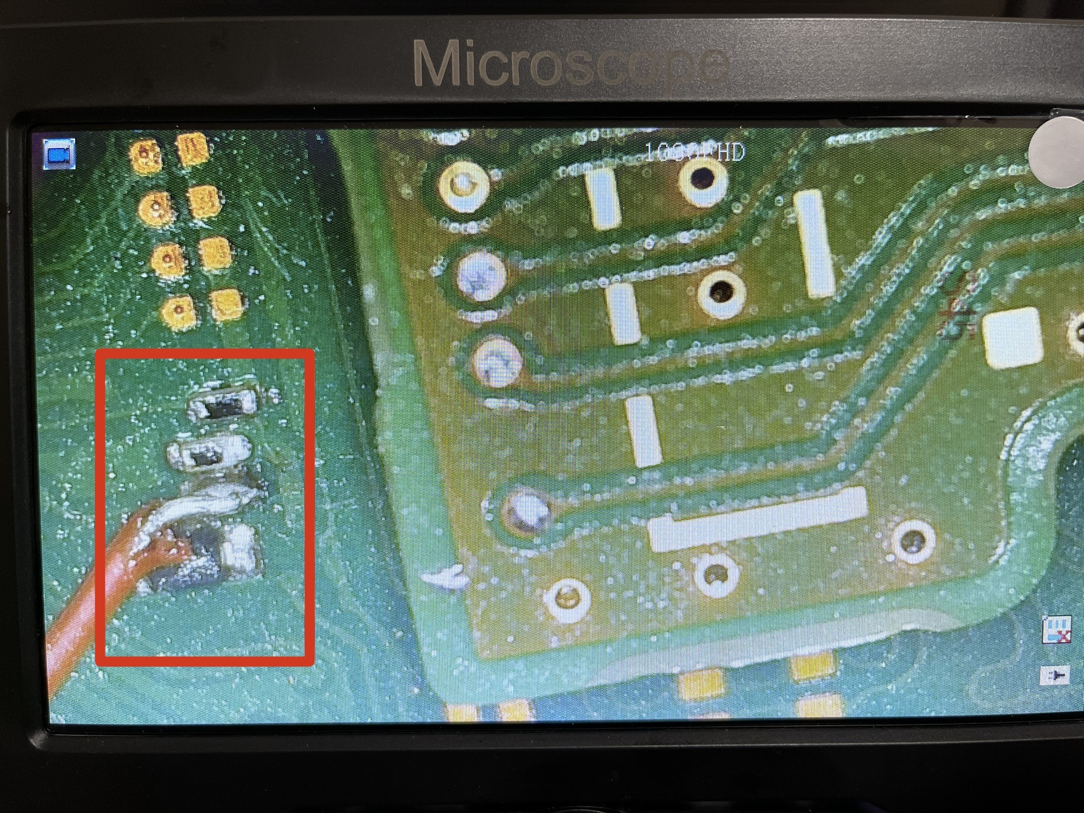

I happen to find another technician who can do micro-soldering. He wasn’t experienced with switches but like you guys, he chuckled at the work the previous guy did when I asked if he can clean it up . Looks like he really cleaned it up, what do you guys think? It now glitches!
Edit: Apparently there’s still some inconsistent glitching, it seems to be D0 and/or RST again. Would appreciate some leads to see what may be wrong.

Thats beautiful

well that looks pretty good , way better then the other guy.
whats the code?
Then its left with this issue you need to check:
You could read it on the Q&A
Q: GREEN, but instant reset
A: Clean flux near the RST point
Editted:
I think i misunderstand your cases. I previously think that your picofly are randomly reset, even though success. But it seems not. after read your comment again i think the flows already correct:

Hey no problem, thanks for thinking about my issue, it's appreciated!
I agree, it feels like the Switch and Picofly is working corretly but I somehow I broke the screen. Dumb question time- is the long connector between the motherboard and daughterboard (around the battery) responsible for the screen? Because that's the only thing I actually disconnected in order to unplug the battery.
I’ll see if I can get a video but my technician said either RST or D0.
I would guess the rp2040 is fried by now. This job looks great.
Yes it is. Its connect the backlight 4pin (right of 4pin power+vol flex) to the main board.

Hi! Somebody could said to me the value / specs of those components (around the RST point).

Do you know the size? Maybe 0201???
yep 0201. if you need to replace them, you can steal from the rp2040-zero
