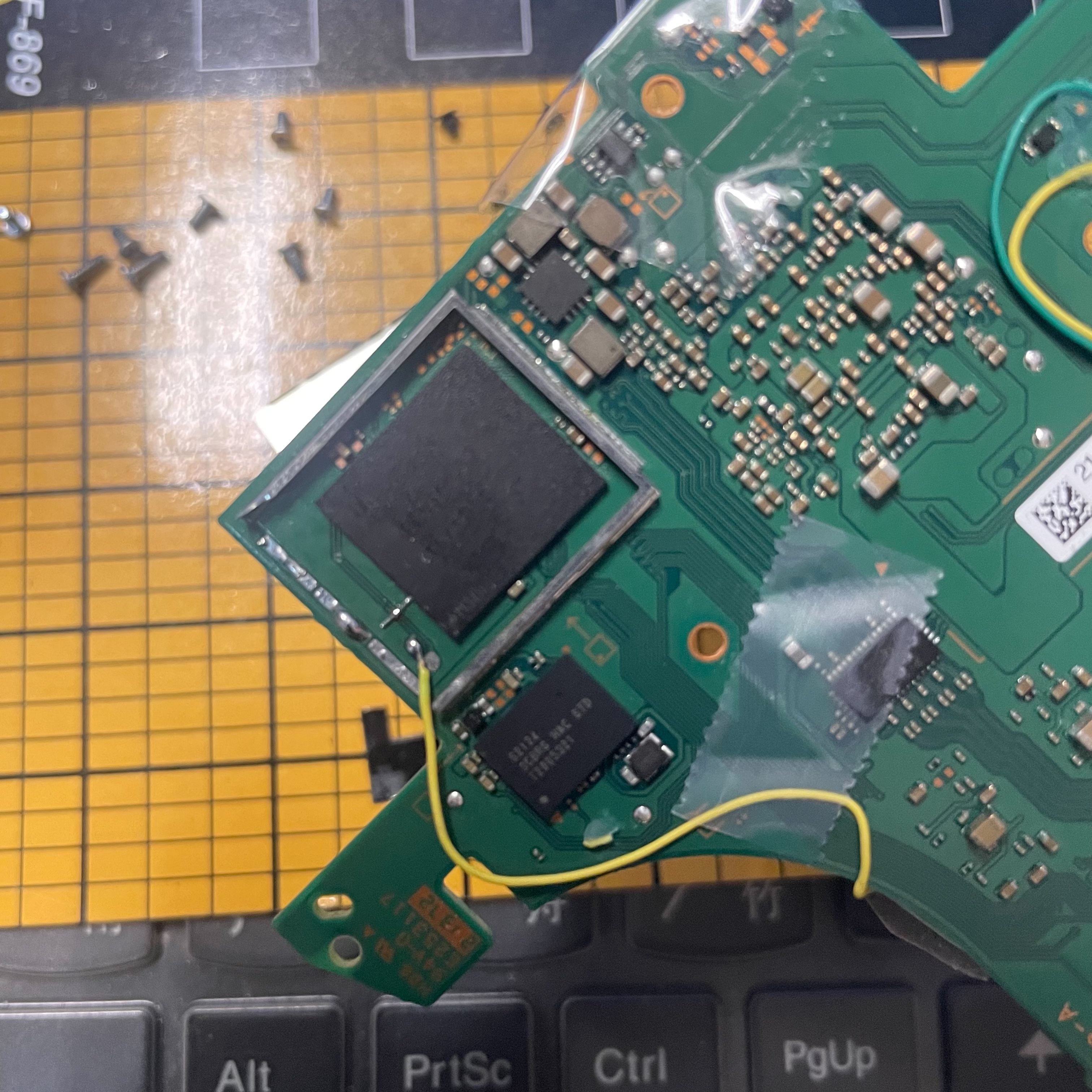

Yesterday I did several installations.
Among these is a dispute that I don't know how it works (after replacing the display) despite the bent mainboard.
There is also an oled made with Reballing, if it can serve for some ideas, I also used new connections for the mosfet.
Photo release (The photos are mixed up).
I'm continuing to use FW 2.67 which in my opinion is fast, stable, reliable. What am I getting into by not using the new FW?
As for this problem, I carried out the unbrick level 1 and 2 procedures, after adding resistors (actually I redid the whole installation (the one carried out by the customer independently was disastrous by my standards).
Now I don't get slow memory error anymore, and in emummc everything works, even waking up.
I can't get into OFW though, after the black screen nintendo logo.
What guides can I follow?
I can download the keys without error, it takes like 190 or so.
hi guys, can they follow some procedure for this?
DAT0 fell off, thought before use, sure it is feasible AWD30 OK line cable (flattened) needle-nose pliers can control the flattened variable

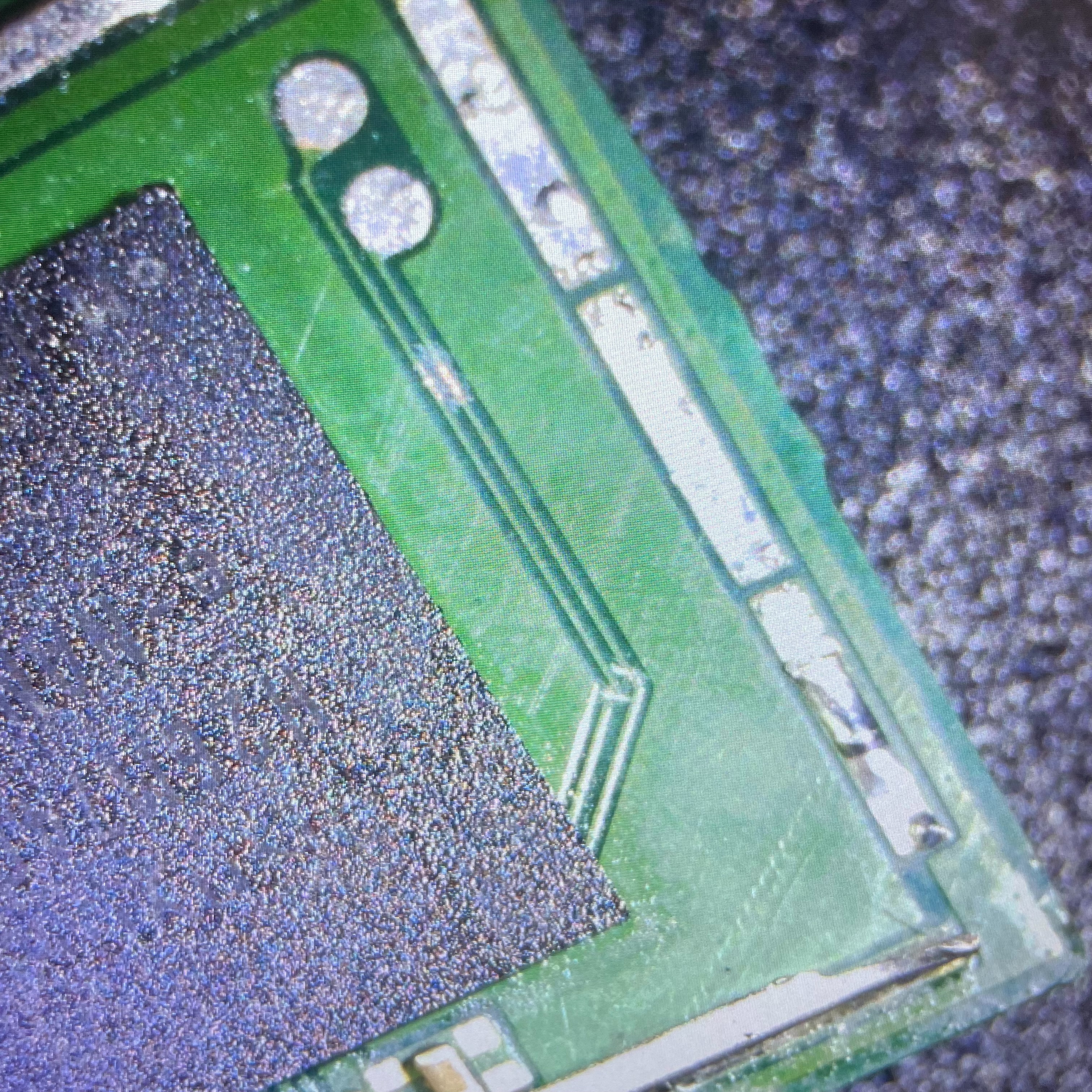

i dont think so ive scrapped any green mask nor im aware of it ????..can you put some light on what is green mask is it to be removed or not ??? regards
Solder mask is applied to the board to prevent solder from sticking during manufacturing where they don't want it to stick. If there is solder mask on any test pads or whatever you want to solder to, you need to carefully scrape it away first. Here is somebody doing it on an old Atari 2600. You need to be quite careful on a more delicate console like the Switch that has very small pads and traces.
What techniques are people here using to remove solder mask from test points before soldering?
you guys remove solder mask before installing picofly on switch??? i havent seen anyone doing in tutorials available correct me if im wrong
