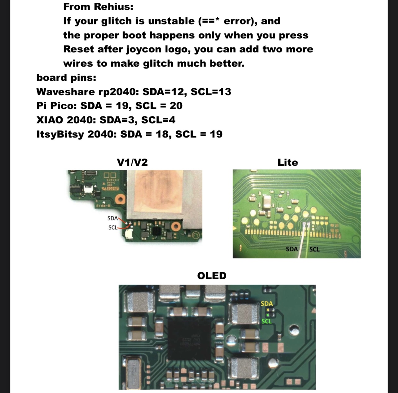

Can anyone tell me which side of the board SDA and SCL are in the switch lite?

The backside, you need to take the board out and flipped it.
I realized that right after I posted. 🤦‍♀️ looked at a donor board. Thank you.
I’m getting this error. Lights are yellow. Normally I’m able to fix this with the SDA and SCL wires but it’s not working this time. This is on a switch lite.

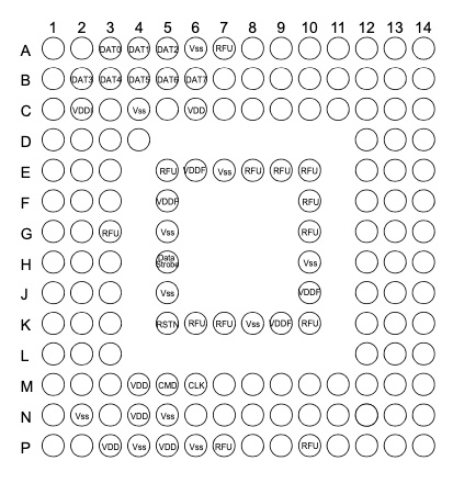

@abal1000x I've read everything you said about dat0 adaptor, Someone once shared the pinout of the eMMC and claimed that shifting the dat0 adaptor as far left as possible is the safest bet. Since the point left to dat0 is empty. Do you agree?

Yes i agree.
That is me, the one who suggesting to shifting to left (to right if in front view).
This already tested and works? how many times now?
The idea is to shift the short possibility to unused solder ball, or even better target the space between it to purposely shorted it. This also will make it more firm and secure in my opinion. So instead of shaping it like a crescent it will be like a spear.

Error: ==* CPU always reach BCT check (no glitch reaction, check mosfet)
Check mosfer wires.
This is the error which is mostly fixed by the SDA SCL wires ( =*= CPU never reach BCT check, should not happen)
