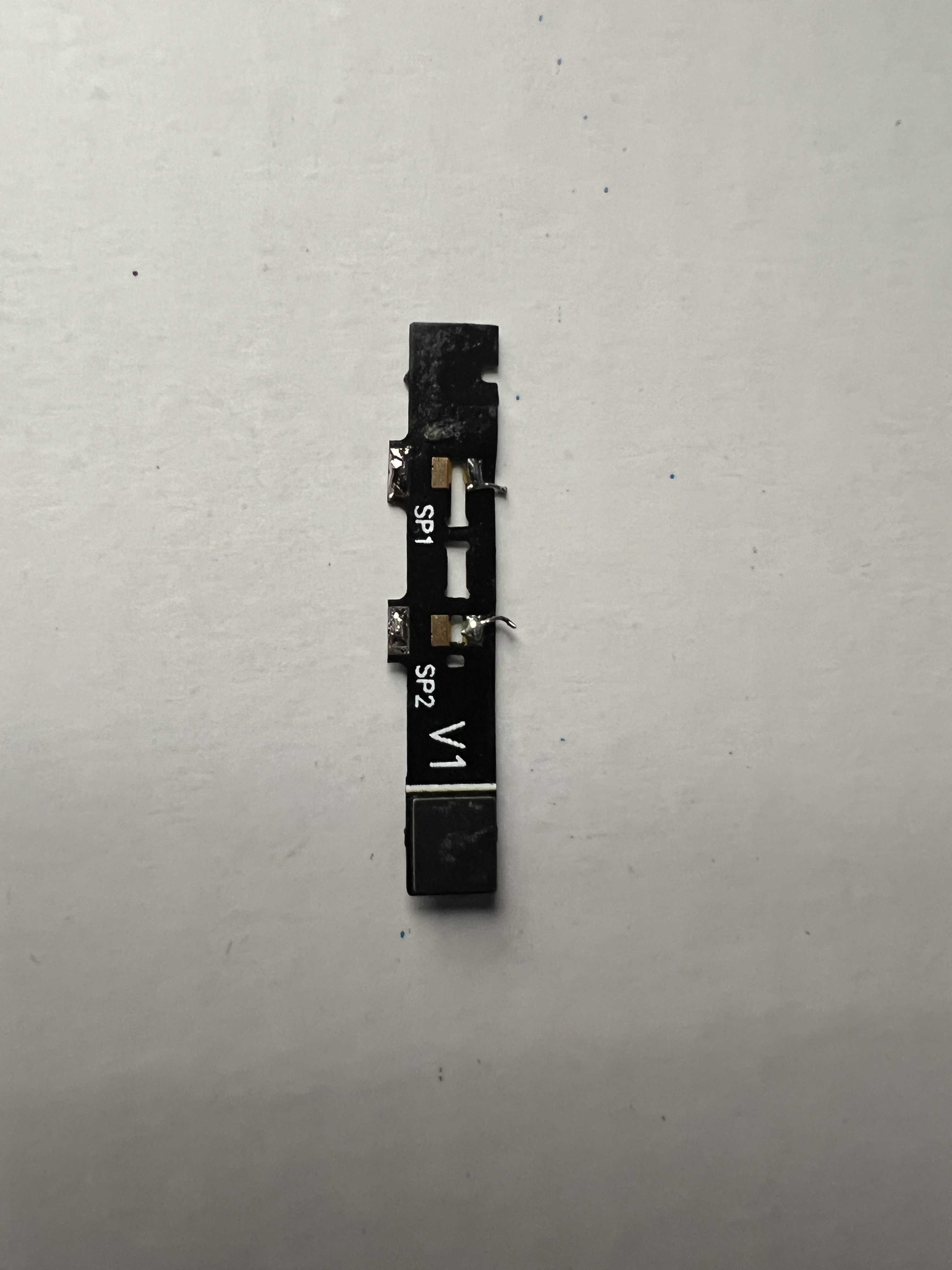

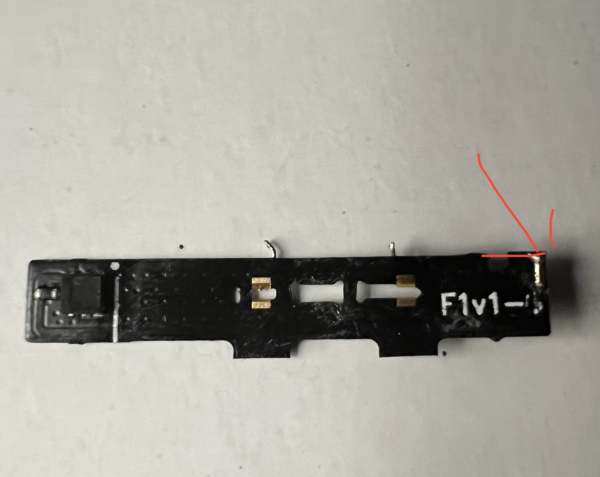

Can someone point of what I’m doing wrong, the red pointer is where I had the cpu

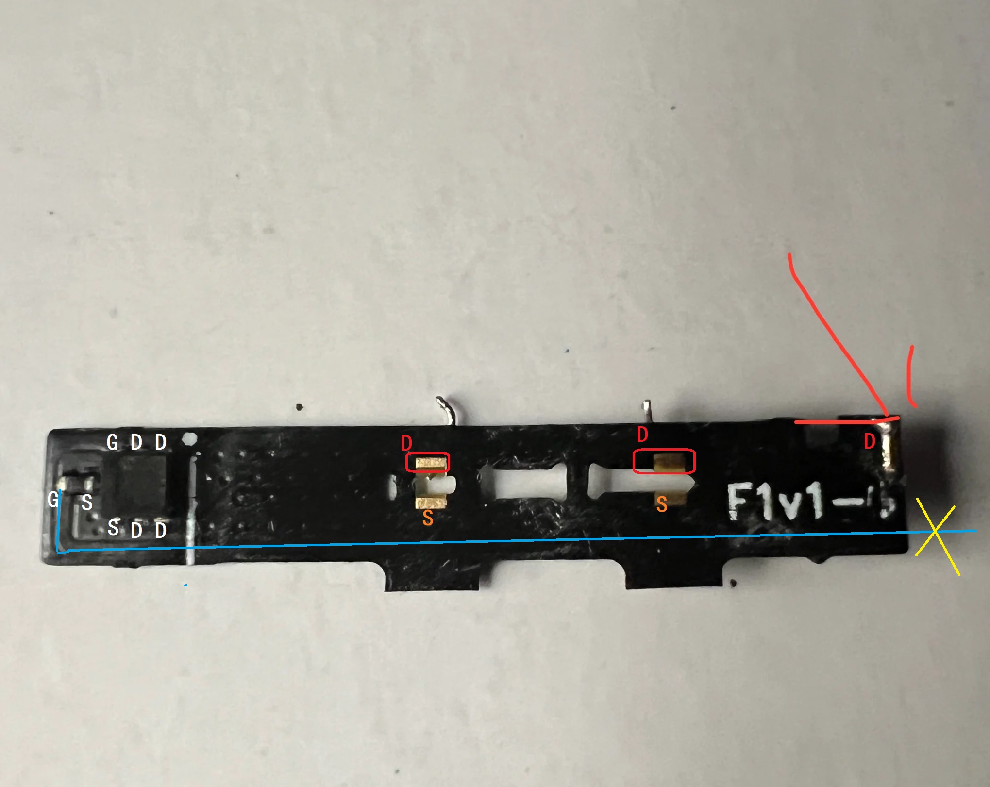

I Believe your red point goes to the Drain on the mosfet,where your top sp1,sp2 solder point. You can check it with multimeter.
You should use the left side resistor as the Gate point/CPU
Reactions: QuiTim
