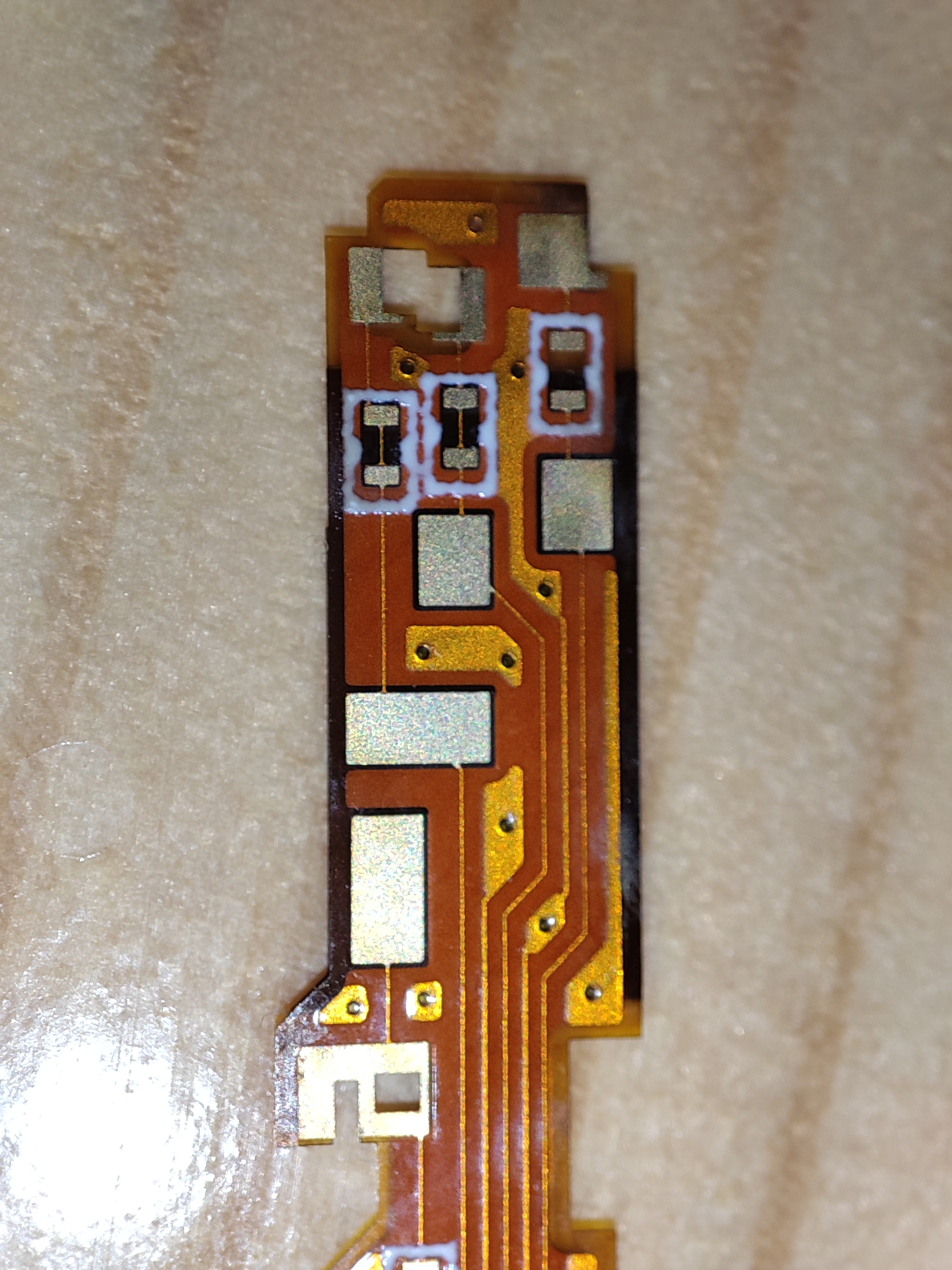

It look interesting. May i ask what it is?
Is not about the address, but its about the line is not properly prepared. For example if the Dat0 short circuit with the Dat1, then when write command send to the CMD line, any pulse goes to Dat0 will also goes to the Dat1 and vice versa, this signal is the data stream to be written.
The pico also write. Even if you remove the pico but not removing the problematic Dat0 adapter. The HOS (OFW) will also write something to the emmc when he is normally working, which will be fault, since the Dat0 adapter is short circuit.
If i take a guess, its not the pico whose corrupting the data, but the ofw. Because i also experiment on it, but it doesn't failed (blackscreen). When i am experiment i never goes to OFW, only until nosd, then shutdown take the battery off. Maybe people take the pico off, but doesn't take the Dat0 adapter out, then reboot to OFW, which make the data corrupted.
Yes its usually about short circuit. But we need the detail scenario to understand correctly the why and how to prevent it.
This is why I, specific in Lite already move the Dat0 solder point to an alternate safer place, even though its harder to solder.
But on oled i think we need a better procedure to guarantee a perfect Dat0 instalation. Its too risky to just hoping it will work.
Or maybe the adapter should not target directly to Dat0 solder ball but next to it which is not connected.
