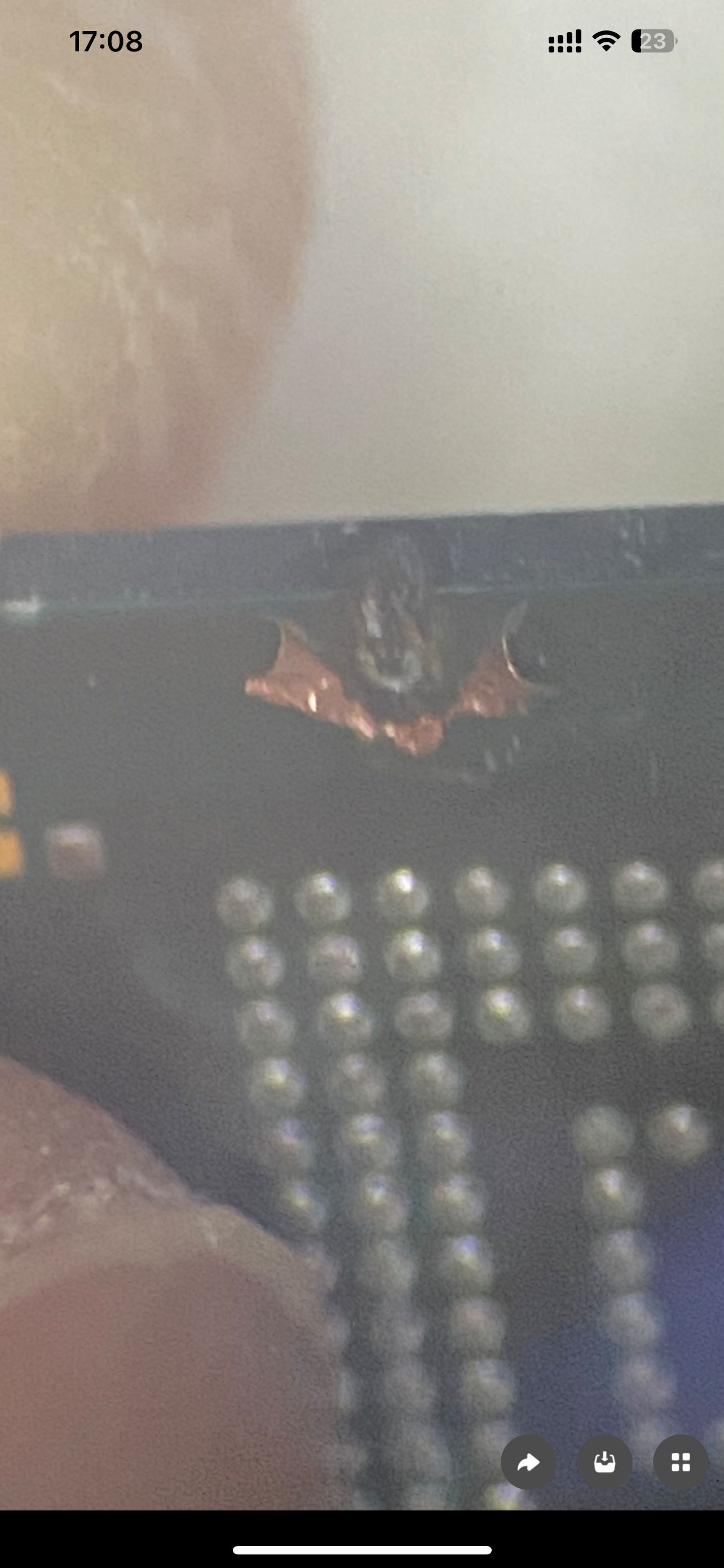

Multimater 200 kohm read is 027.2 k ohm (resistor read) . Diode read from left 0.612 v from right is 0.364v nintendo switch lite motherbord the one green (x)
No, I measured it as 4.7Kohm from another machine.
100ohm
064.9k ohm resistor read in 200 k ohm resistor read multimater.
A note of caution here. If anyone is measuring these resistors in circuit, the values may not be accurate because the meter is measuring not just the resistor but all possible circuit paths between the two probes. The value measured in circuit will be the same or (potentially much) lower than the value of the resistor itself.
Whether the value is good or not will depend on the surrounding circuits. Whether this is important or not depends on the circuit the resistor is in.
