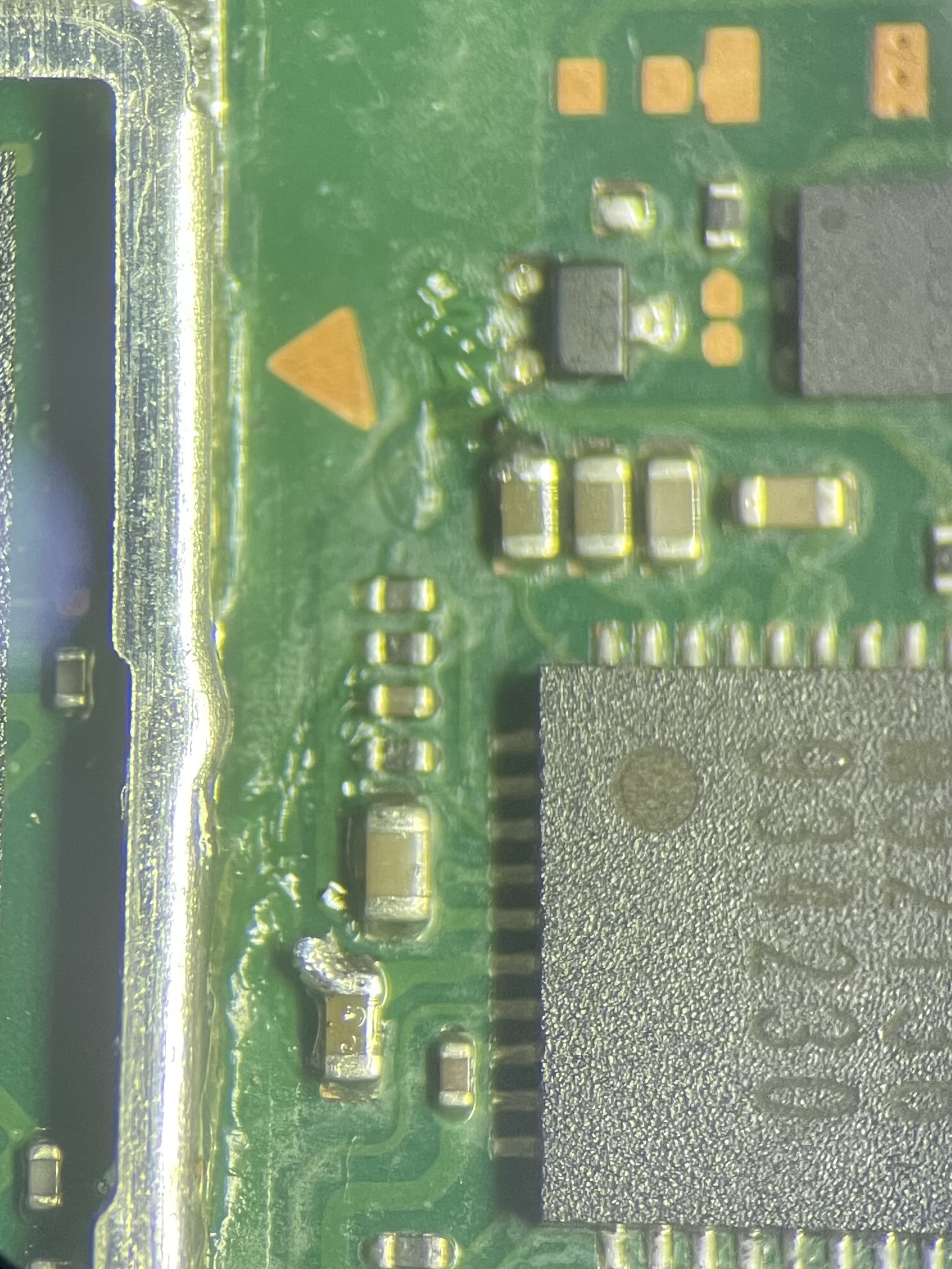

I got wierd switch v2
Yesterday i instal picofly
All perfect, try to reboot many time
And today, something wierd happening
After turn off, swith cannot turn on again
I left about 2 hour, and switch turn on normally
So i remove pico and every cable
Still the same, cannot turn on
Plug in usb charger only draw 0.2-.03 ma
I left switch while charging maybe like 1 hour
Turn on normally to ofw and usb draw 1,6a
What happen with this switch?

Some time you need disconect battery charge soket from the conector then conect and some time press 15 sec and then perss one on power. Me be your pico fly glitch is or ps1 sp2.
I already did that, still the same
Even i press restart
Switch can’t turn on
Like short or just ic nearly dead?
Is charge cable charge when you flip it???
Turn the charging cord over and see if it charges from both sides, from the top and bottom.
