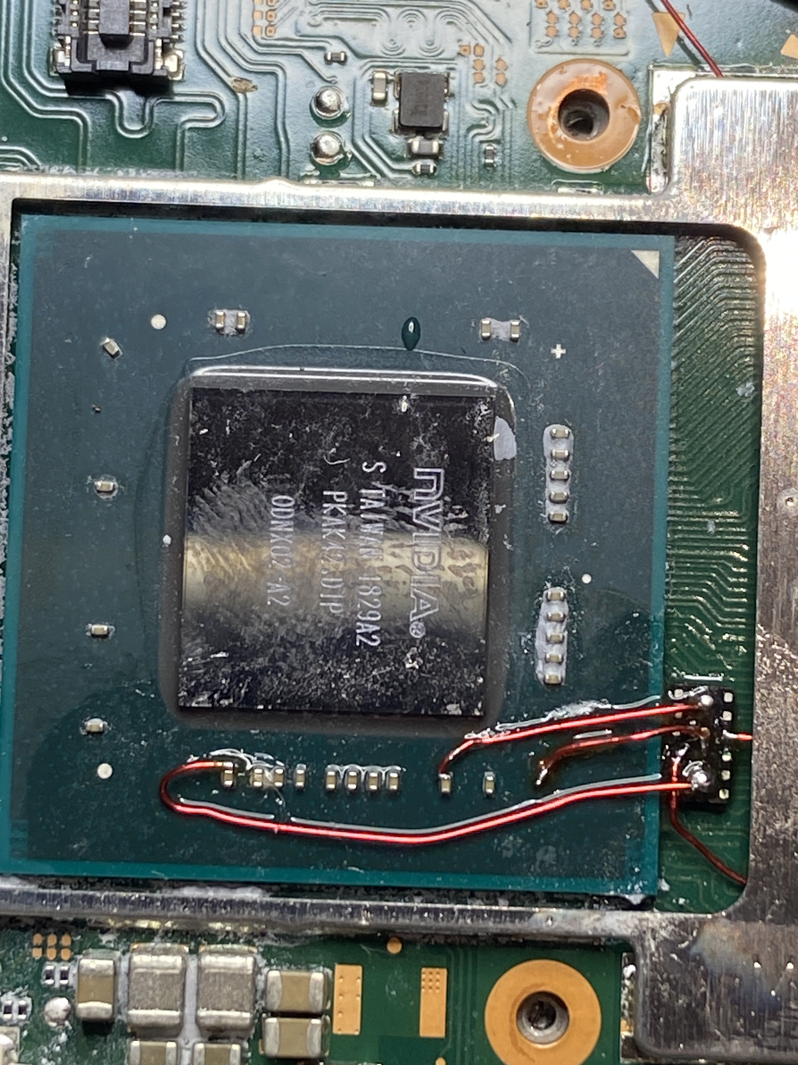

Your LED code seems to indicate an issue with your MOSFETS, mind taking a clear photo of your mosfet install?
I figured as much, but the install looks clean to me.
This scenario happened twice and I won't be able to stop it if I didn't know what's wrong, it goes like this:
Switch works fine after install ( NO SD card logo)
I insert an SD card and get a black screen
I have to press power button for 10 second to get the no sd card logo again.
The moment I start twerking with it, ( sometimes as much as re-opening the case) I get a blue screen and that's it.
Removing all wires doesn't help.
What do I keep killing the CPU? Is it related to my MOSFET soldering. This happened to me on a Lite, OLED, and now a V1.
P.S this pic was taken before I masked everything with solder mask.
Please @Dee87 and @QuiTim @deeps @Adran_Marit @bilalhassan341 if you could troubleshoot this for me.

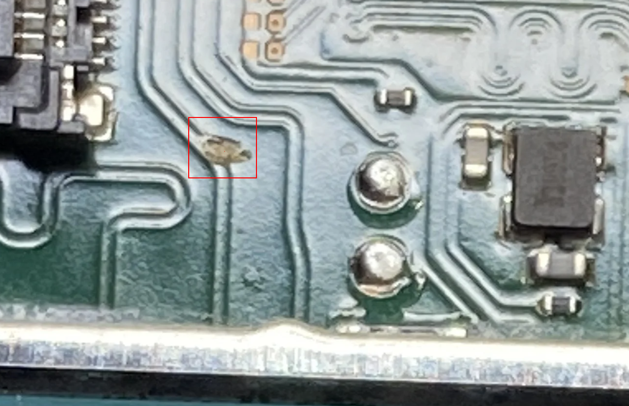

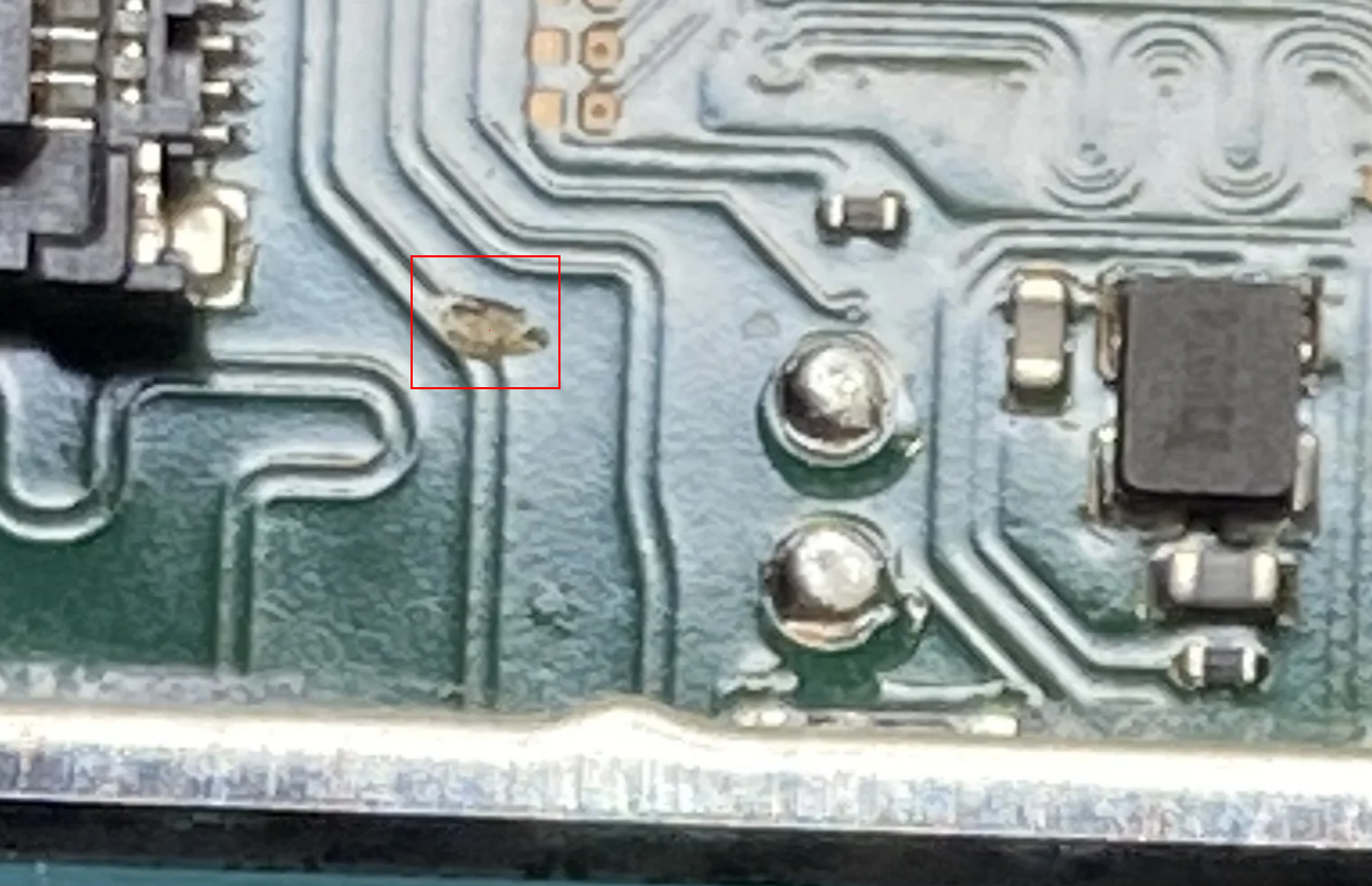

Try changing the ground for the mosfets from the pad on the APU to something like the APU shield. Also, your left capacitor looks as if the solder joint could be made a little better.
Also, what's going on with this trace?
Sorry I removed everything and I'm still getting a blue screen. I figured it's dead and done and now I'm just focusing on knowing the reason and avoiding it.
Could the grounding, or left cap soldering cause a blue screen? Why after SD card insertion, why not immediately blue screen?
Good catch! didn't see it. Will look into it.
Blue screens are APU/RAM issues typically, but if you accidentally corrupted your NAND (Bad wiring, wrong resistor values on specific lines, wires disconnecting while "twerking" with things), you could potentially get a blue screen with no picofly installed. The picofly being properly installed should at least let you boot to Hekate (with a properly formatted SD card) and restore a nand/boot0/boot1 backup (if you have one) or rebuild a new nand (without online functionality) if you don't have a backup.
Thanks. The trace was just some dirt. Is there any chance that poor MOSFET soldering could result in a blue screen. What I fail to understand is that this happens ALWAYS after inserting SD card. If I had poor wiring somewhere why am I still getting a no sd card.
As you mentioned in your own post, you only get a "NO SD CARD" screen until you start "twerking" with it. If your soldering joints are making continuity, but are weak, then the glitch could work, and then disconnect while in operation, which could cause any number of strange behaviors, not the least of which could be a corrupt nand.
I know you are frustrated, but please do not blame the mod, as there have been countless successful installations to this point. Always assume that we (everyone doing this mod), the installer, are the ones at fault when something goes wrong. It seems like you want to find out what you've done wrong, but you are still fairly married to the idea that your install was "perfect". As I've said before, if an install is perfectly done, you wouldn't be posting here on these forums.
I agree. I also had a number of successful mods with Picfly, will never take that for granted. I'll never blame the mod, I'm 100% sure if you were watching me while doing the install, you would have caught something that would prevent this from happening.
