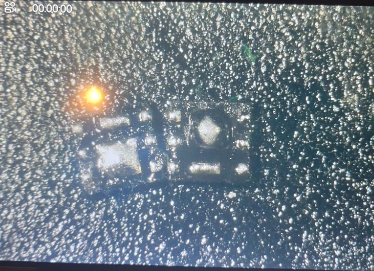

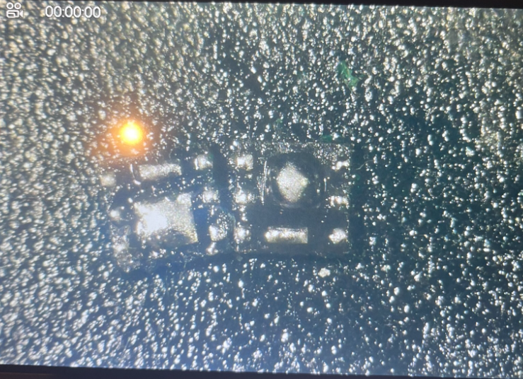

Long story short, ordering 0201 smd resistor would take 3 weeks to a month and in our local shops here only has 0402. Can I use 0402 smd resistor and will it affect performance or something?
It fitted? Same situation...but next to the rst pad...ripped off one resistor and cant find 0201..
Is there any chance i can use 0402 resistors for these two.
