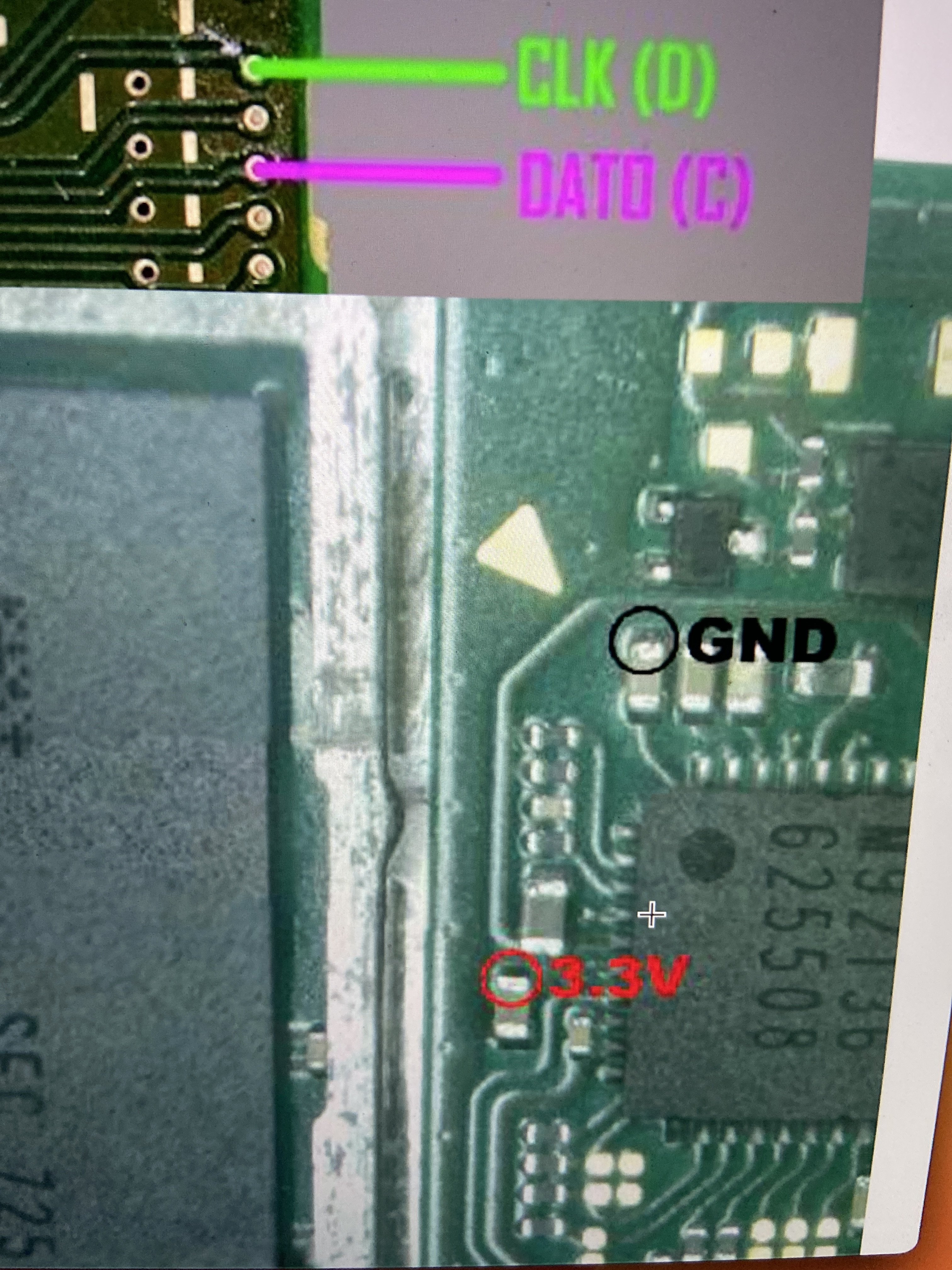

There no caps on nand point.
V2 for reference.
V2 is the easiest, Lite harder, OLED maybe ill try next, V1 haven't met any V1 yet.
I would say the lite is easier than the v1/v2. it has a much easier 3v3 point, and doesn't require any shield cutting. The other points are about the same difficulty, simple (but small) test pads on the motherboard. Everything accessible without removing the motherboard on both models. The oled is by far the hardest though.
Type wier you use and that wier hold glue you do job very nice brother.
