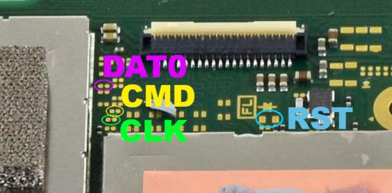

After some success with "No Sdcard", i got " *= CMD is not connected ", but i don't know why, if it's well connected.
On diode mode is giving me now 385, i know that's low, but was working before.
I tried changing the cable, soldering again and no success.
What can i do?
Those points must be bridged

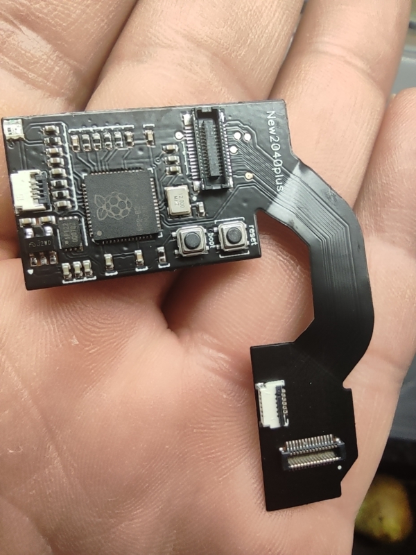

I bought this chip but contacted the seller who gave me old guides on its installation, from the previous hwfly. I saw that the chip, even though it is a custom version, still needs wire soldering. Any chance you could tell me how to do it, send me a diagram? I have a switc hac -001(-01) 2020 which would be a core v2. Thanks

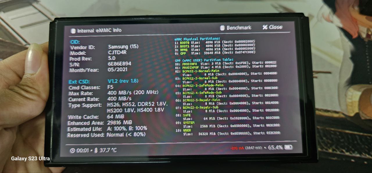

Does anyone ever face with this problem? when it boot into OFW, it stuck on Joycon logo. then it was boot into CFW and it loaded atmosphere logo and after it turned into black screen. Anyone know the solution, pls help. thanks
Your sd card fat 32?
You add releases Atmosphere cfw files?
You see System update?
Your dat0 adapter value?
You can do nand backup?
You| pico fly firmware is?

sd card is fat32, Atmosphere last version , dat0 value 0.745v , able to nand backup, pico fly firmware 2.73

Do nand backup for more safe.try inter emummc cfw. Befor do that. Make emummc but that make partion on sd so backup sd befor do that. For more safe.

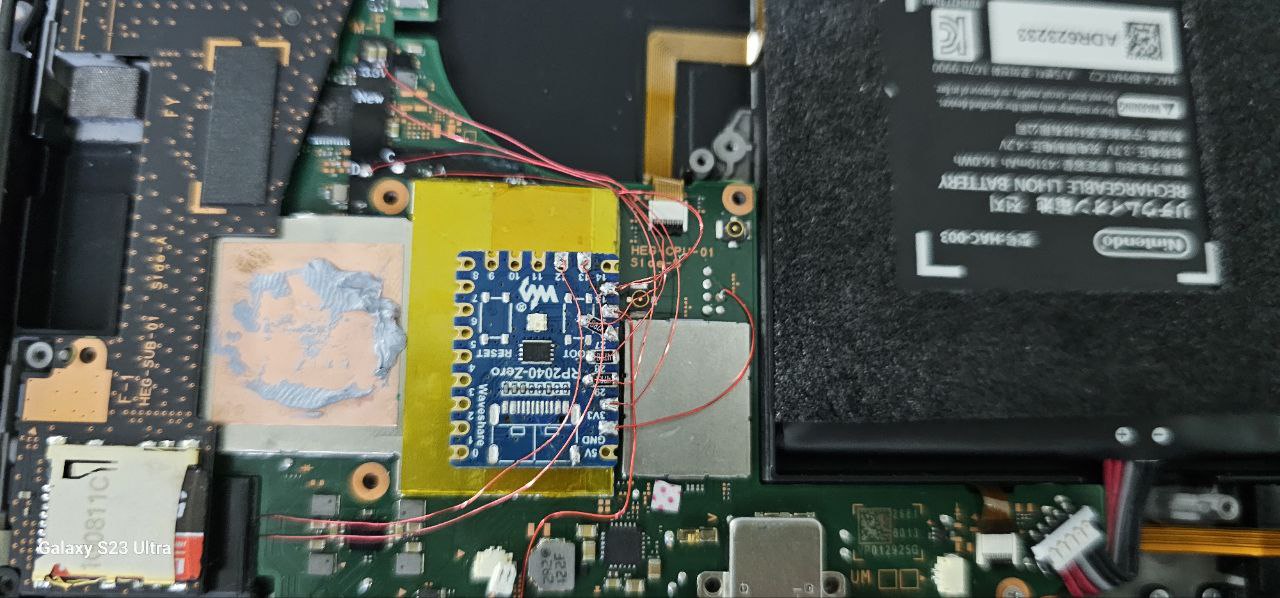

My first rp2040-zero build. Note that I newer did microsoldering but everything turned out ok. I let the usb-c on the rp2040-zero to flash new software when it's needed. Thank you guys for the help
no need for leaving the usc on since we can update firmware over picotool box B-)
