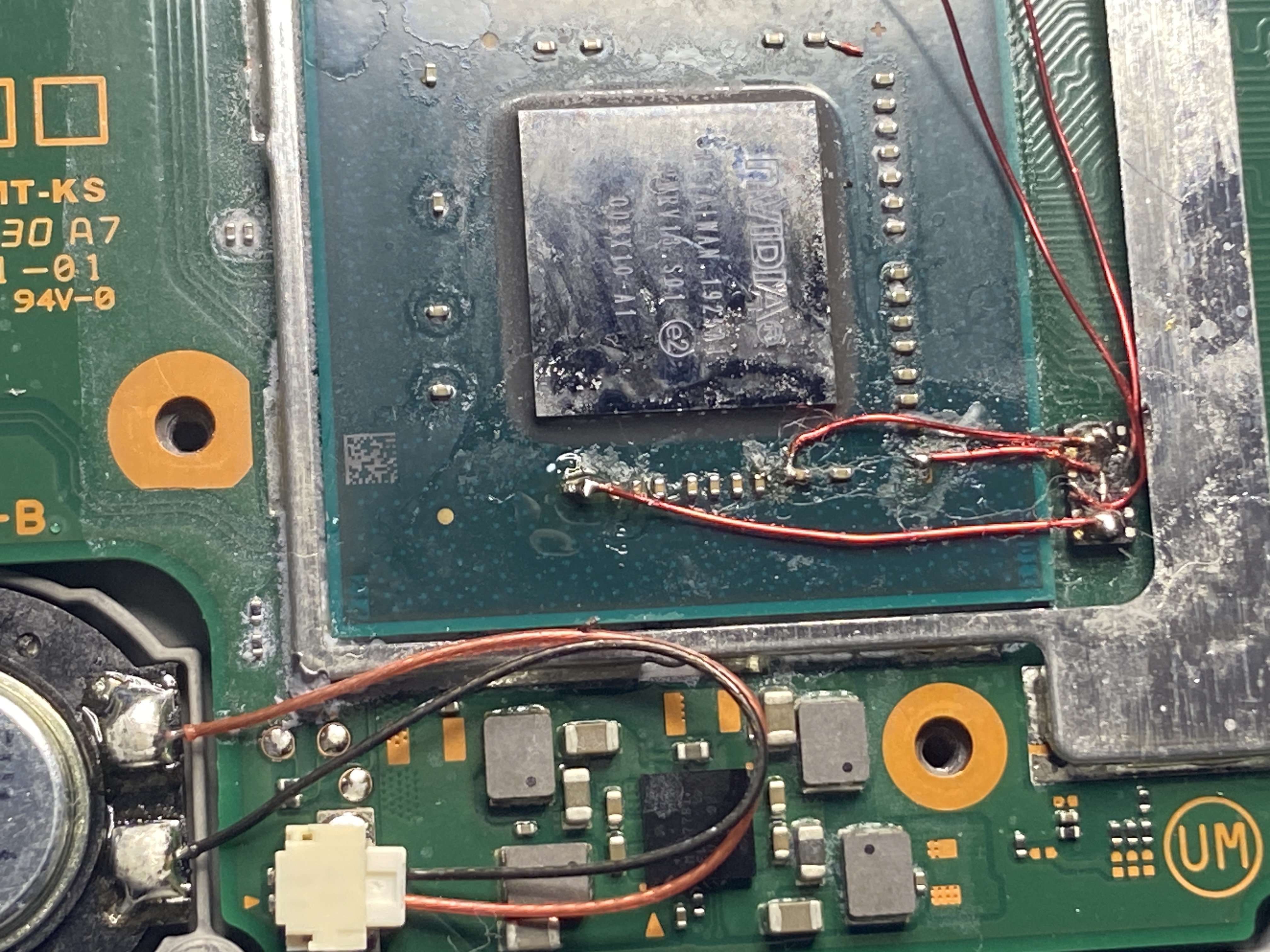

Yes, that is what i'm thinking. But I would still go with 2.73 since it has a way more advanced diagnistics. Or you could try 2.67 and then 2.73, up to you.
I agree. 2.7+ Diagnostics are a life savior. I did a V2 and was working fine, then it slipped out of my hand and was hit to the ground. Ever since it's been booting OFW. I checked the lights and it was ==*. I knew it was the G point wires because it's the most difficult for me to solder and was not happy with it. I resoldered it and now it's working fine.
In previous firmware it would have given me a blue light, I would have resoldered everything again.
This community is beyond supportive. It's amazing to be part of it going forward.
