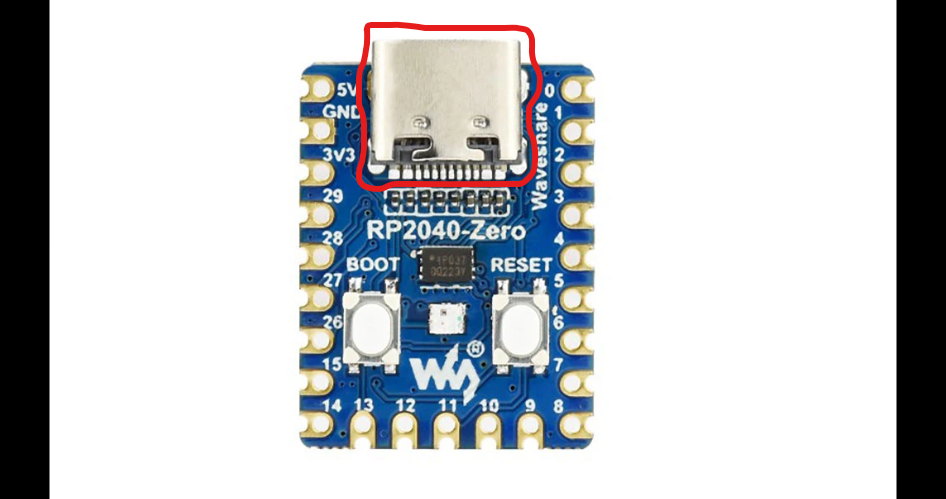

is there video/tutorial
how to remove usb-c port
RP2040 zero ??
without heat gun.:whip:
using iron soldering.
i only have manual iron soldering.
:creep:
RP2040 zero ??
:creep:
*CAREFUL, GIANT blobs of solder*
Edit: ugh, I wasn't ready to send...
Solder wick and maybe a flush cutter too. Once I get my next shipment of PZeros, I'll make YouTube shorts on the various ways.
RP2040 zero ??
:creep:

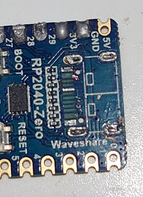

I removed it using a soldering iron. And don't ask it is pain in the ass. Add a solder to all four points and start heating it for sec and then move to second. But remove to first upper two points then move to lower points. But I can assure you the port will be remove and buttons as well .But there will be no more pads left😂😂😂. But first check your are using latest firmware.
It will look like this.
Edit: my finger also get a burn a little bit from the port Because I accidentally touched it🥲🥲🥲, it was F hot. But please be carefull. Also, don't laugh at me.
can those 4 legs
cutted ?
maybe using nail clipper ??
