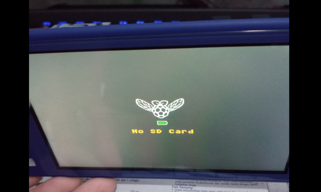

guys
i manage to get no sd but only when im press the reset button on rp2040
at first one i got blue and green but get to ofw
after that
i try press the reset button on rp2040 and get to screen > "No SD Card"
im using firmware 2.67
how to fix this?

guys
after that
how to fix this?
thx:mellow:
Use a New firmware 2.73 which supports the SDA/SCL wires to resolve this issue.
link: https://gbatemp.net/threads/picofly-a-hwfly-switch-modchip.622701/page-78#post-10090767
Edit: (According to Rehius: The second major feature is CPU downvoltage. This might be useful when your MOSFET (or the wire) is not strong enough for the glitch. (do you remember the case where you press "RESET" on the rp2040 when joycon logo appears to make it working? that's it, system lowers CPU voltage)
Therefore you can solder two additional wires to the chip so it could lower the CPU voltage making the glitch easier. This is optional! only if you really need.
Edit: My switch also has the stubborn cpu using 2 mosfet but still require to press the reset button but these two point solve this issue. If your switch don't require to press reset button you can miss these points.)

guys
after that
how to fix this?
thx:mellow:
download the latest update to the guide
Reactions: bilalhassan341
